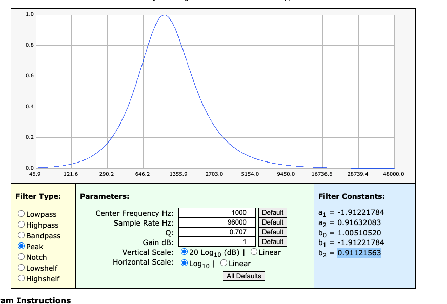

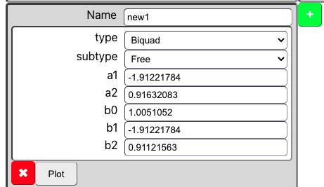

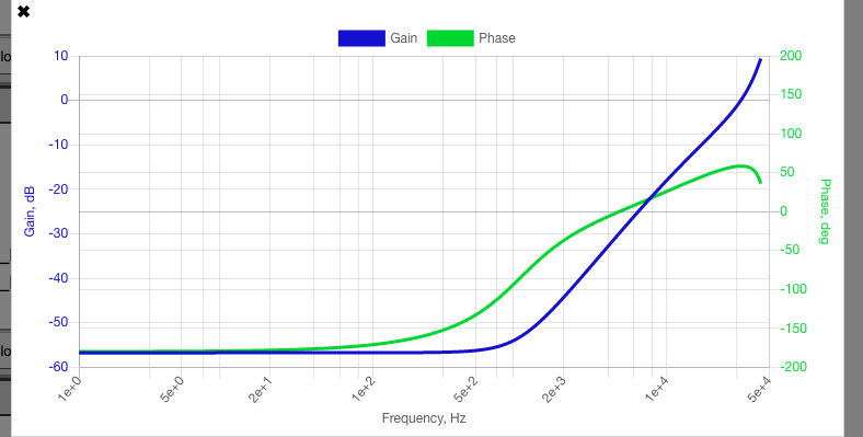

I'm still having trouble with free biquads. When I go to biquad designer that you reference in your code, I'm still not getting the same output (visually) that I would expect.
No filter where I put in a1, a2, b0, b1, b2 looks anything like I expect it to. That could be because the visualization is not working as intended, or because the biquad engine isn't, or (this does seem probable) I'm doing something wrong 😀
Take a look at the attached screenshots and let me know if there's something incorrect. When I do an FIR filter for RIAA correction, it looks spot-on, BTW. Other biquads like low shelf and crossover curves also look correct. Just something with "free" biquads.

There seems to be some bug in the plotting, I'll look at it.I'm still having trouble with free biquads. When I go to biquad designer that you reference in your code, I'm still not getting the same output (visually) that I would expect.
You can use this in the meanwhile (if you swap a and b):
Filter frequency response grapher | EarLevel Engineering
