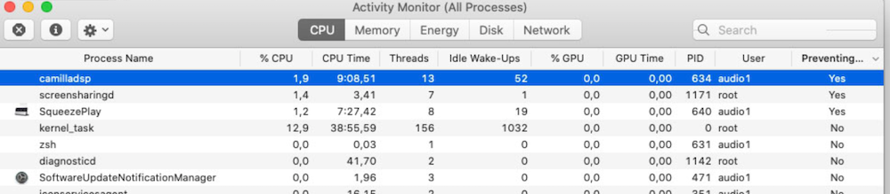

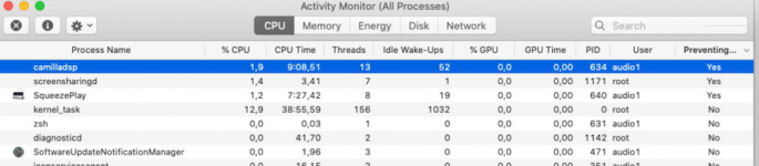

In OS X, Camilla is preventing sleep when looking in. Is this permanent as in 24/7? I'm thinking power consumption and environment here... Could a sleep be OK after a certain time with silence?
After asking the mini to sleep it seems indeed to have had a good night rest.

Good! Once I move away from cpal and talk to coreaudio directly I will have a chance to control stuff like this. Now it's all hidden by the cpal api.After asking the mini to sleep it seems indeed to have had a good night rest.

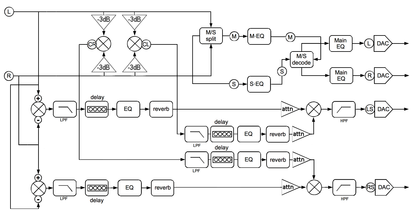

Maybe to do channel "arithmetics" like add/multiply etc - notch notch... 😉
To be able to create something like:
from:
The making of: The Two Towers (a 25 driver Full Range line array)
from:
Don't know what M/S split and encode means here, but at least the rest can be done with the building blocks available in camilladsp.
Probably Left-Right stereo to Mid-Side stereo ("M/S split"), then selective processing of the S (side) and the M (mono) channels/information, and then converting everything back to a Left-Right signal again ("M/S decode").

Selectively processing the S info allows for many other different effects affecting the stereo rendering. Therefore this M/S-encoding-decoding option can indeed be an interesting playfield
