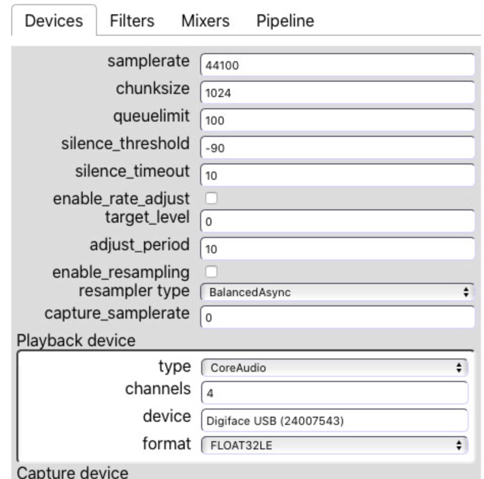

I run it as per attachment and after I changed to reset the buffer at silence, I experience no more delays or pops. I do not use Digiface syncing via spdif but "clock mode" as internal. Other reports that internal sound better. I concur.
