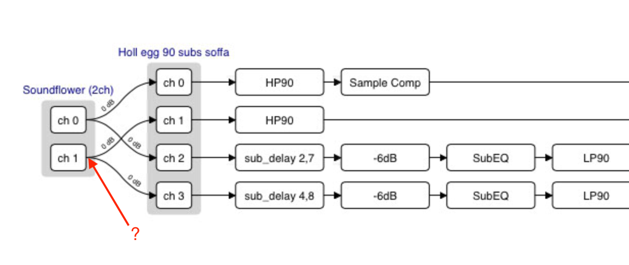

Hmm, I still don't get how to insert a filter common to duplicated channels produced by the mixer i.e. at the arrow?
Do I need to add yet a mixer efter the capture?
You just need a Filter step first in the pipeline. Then put the "common" filters there. Then put in the mixer after the common filters, and the rest of the filters after the mixer.
But I thought you had solved that? The picture here looks like it: https://www.diyaudio.com/forums/pc-...rossovers-correction-etc-146.html#post6479585
So I tried to add a Mixer 2->2 channels with filters - OK!
After this I tried to insert yet a mixer 2->4... this gives blank white page...
This to achieve the above - maybe it should not work?

Was this mixer placed after the other 2to4-mixer? If yes, then it won't work, there are four channels before it, so it must have 4 input channels.So I tried to add a Mixer 2->2 channels with filters - OK!
What does the 2-2 mixer do?
