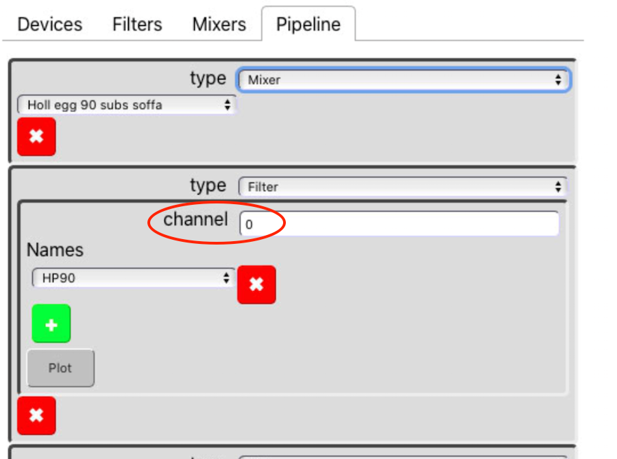

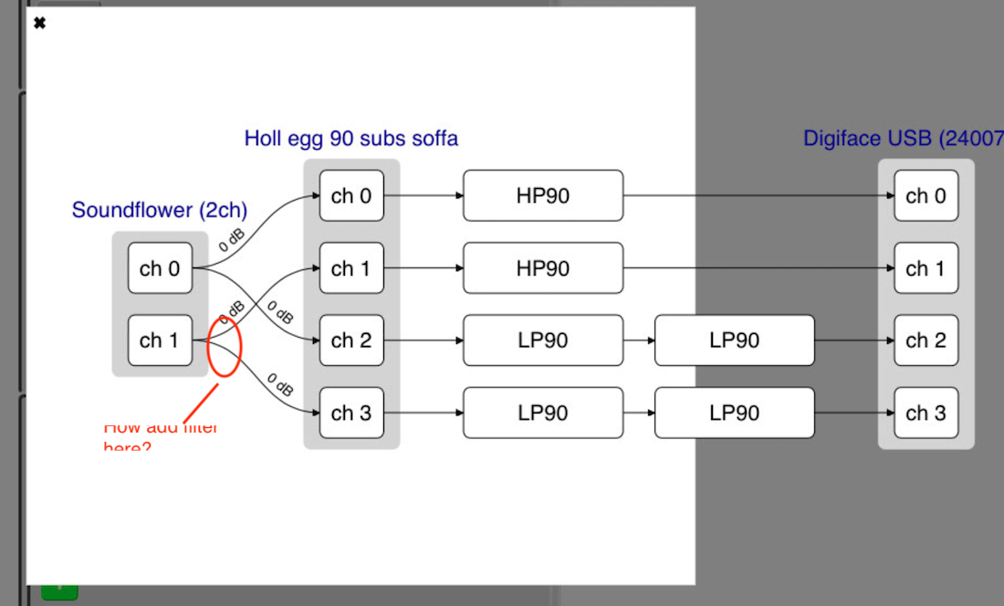

How do I add a filter here?
attachment.php
and there is 2 "Channel 0" in the pipeline plot but only one (implied) in the meny - should be good to name it maybe?
attachment.php

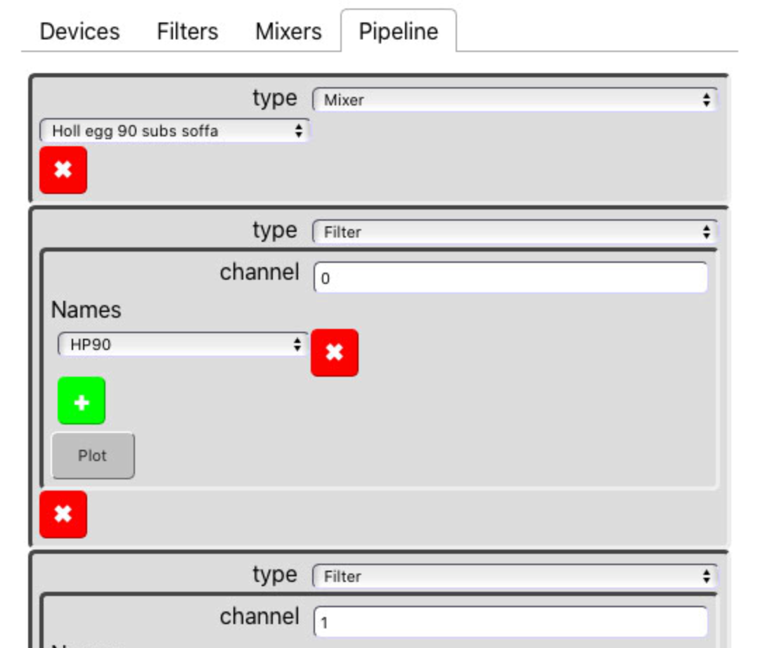

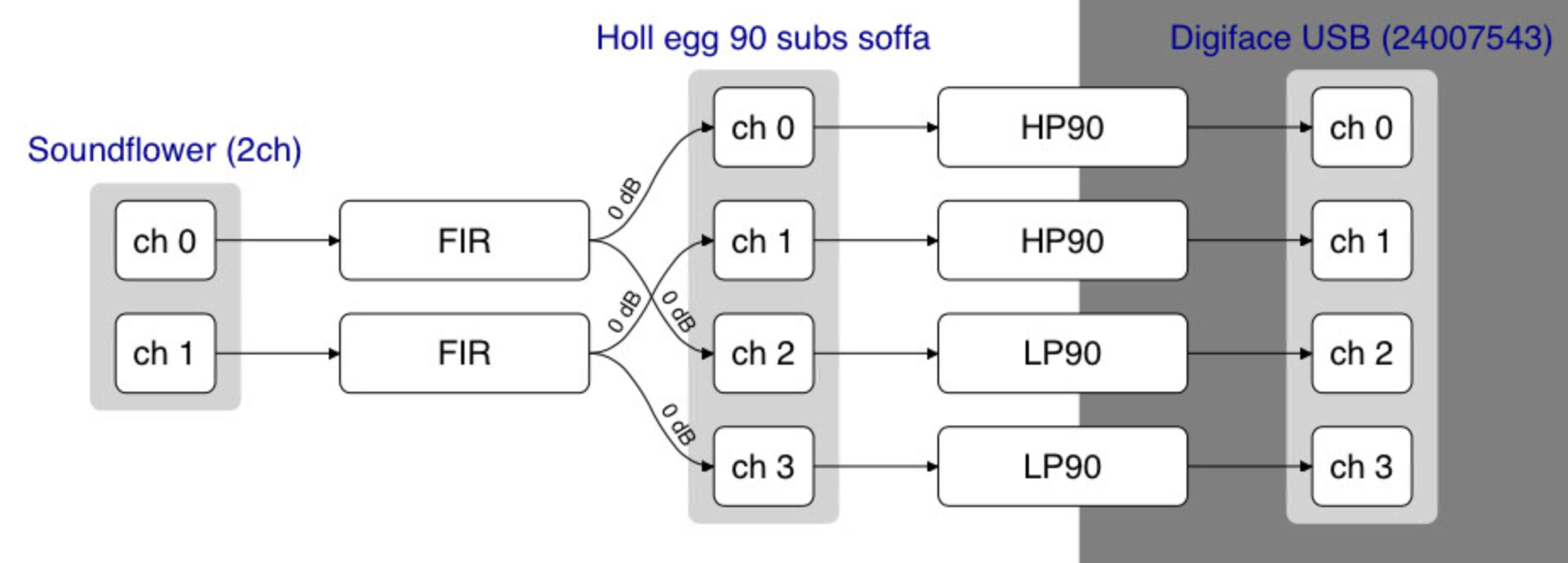

To add a filter before the Mixer, just add a Filter step before the Mixer in the pipeline.
The channel "names" are always just the numbers 0..nbr_channels-1. So before the mixer, you have channels 0 and 1. After the mixer, you have 0,1,2,3. Channel 0 before and channel 0 after the mixer are not the same signal!
Several people have suggested adding names to the channels. The problem with doing that is that it adds quite a bit of complexity to the configuration parsing. This is why I haven't done it. I might give it a try at some point, but not right now.
