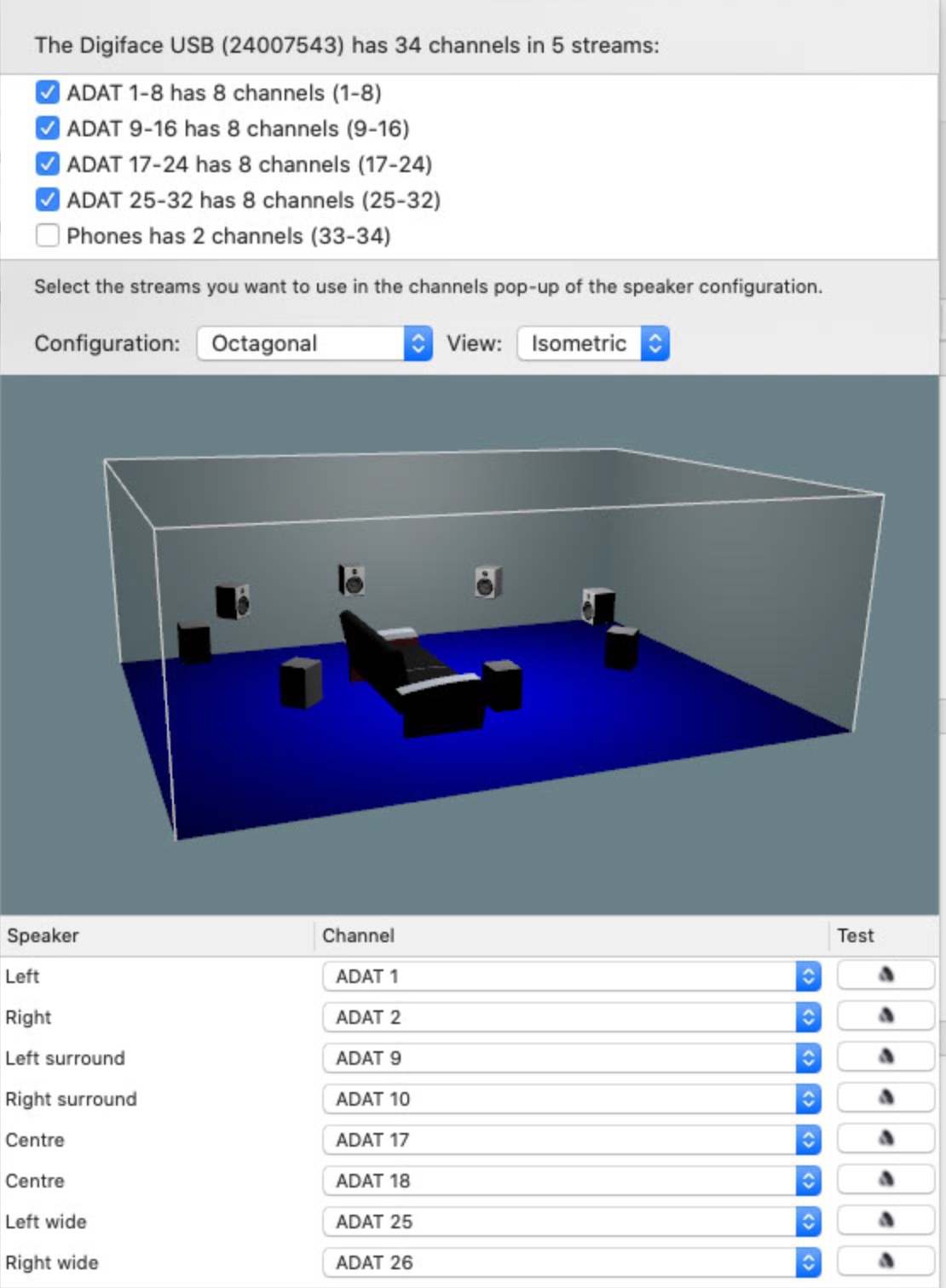

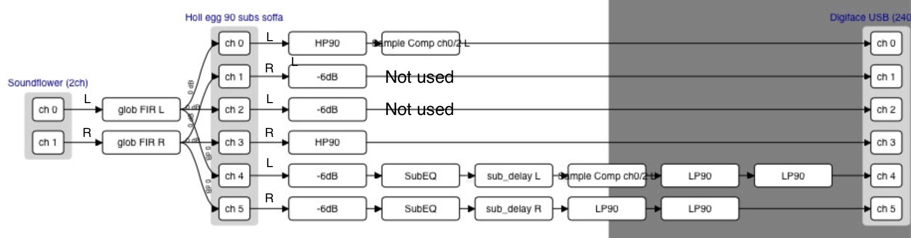

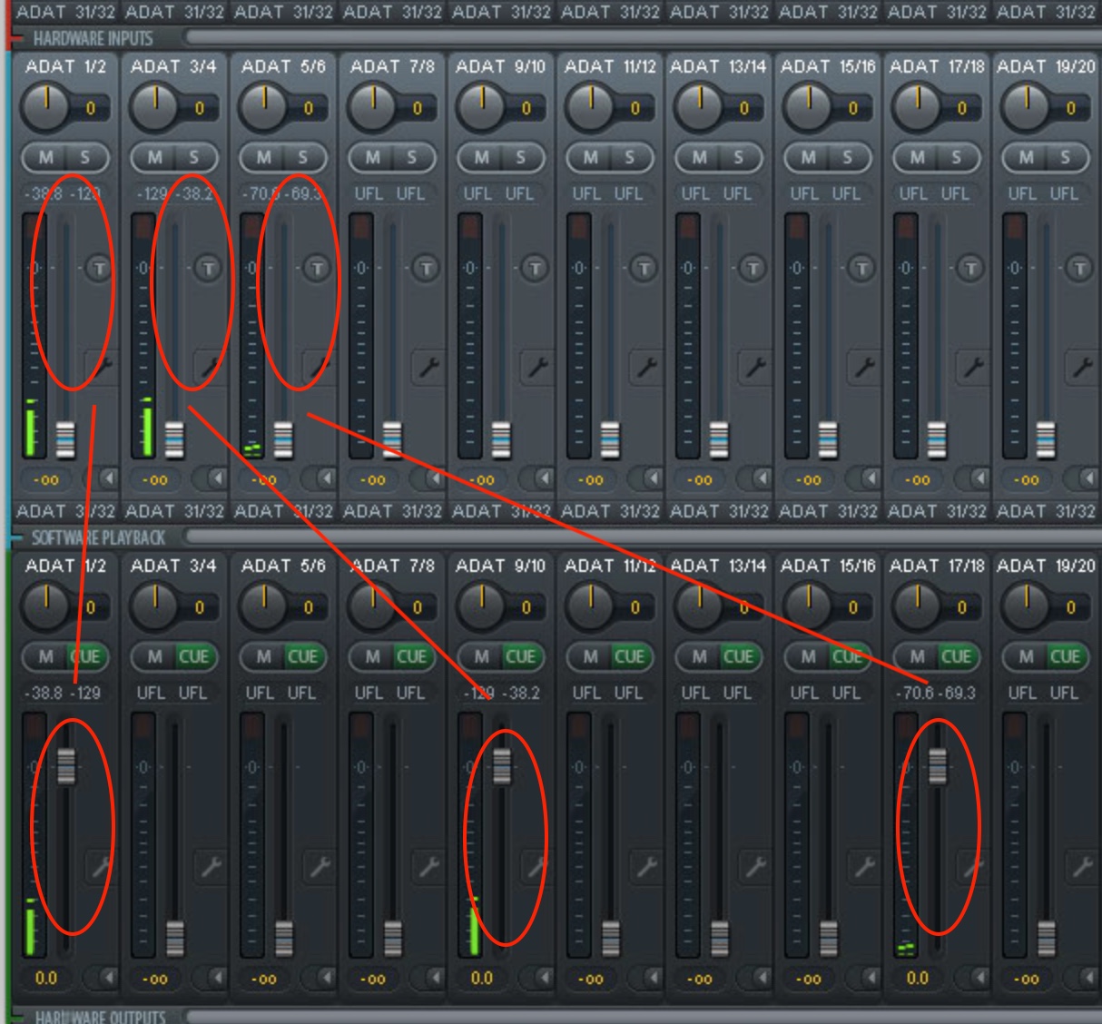

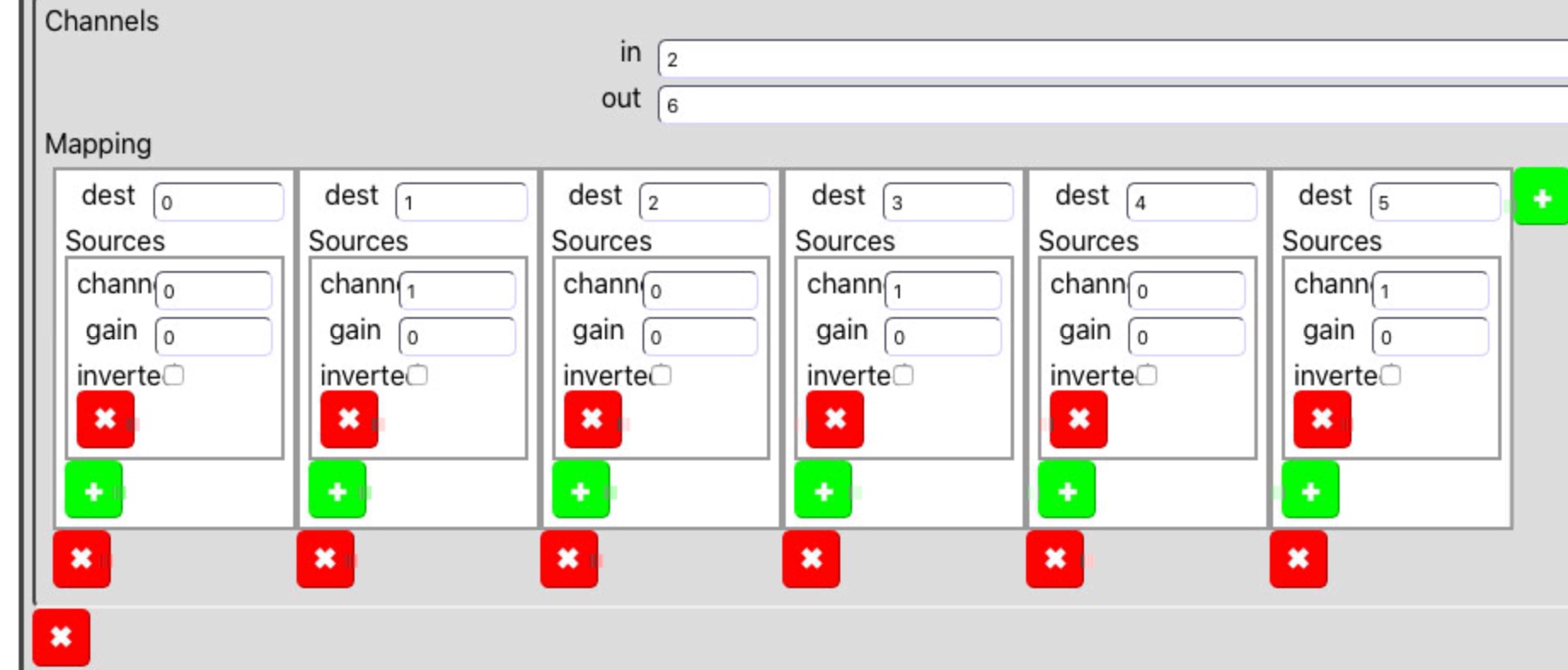

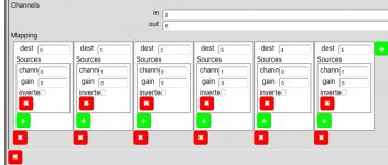

I struggled a bit to set up my Apple Mac Mini and an RME Digiface USB (opto), but now I seem to have ended up where I want so I thought I'd share my configuration...
I use 3 DACs connected via opto, 1 each for the L&R mains and one for my subs (stereo) so I need to output 6 channels over 3 opto Toslink.
- I needed to setup the RME as a 8 channel system in OSX Audio Midi (might be OK with 6 actually!)
- In Camilla if you have a mixer using 6 channels, 8 is not ok to set in the Playback in the GUI😀evices tab. needed to also be 6 or Server Error. Maybe a little creature... 🙂
Below som screenshots of the used pipeline etc:
