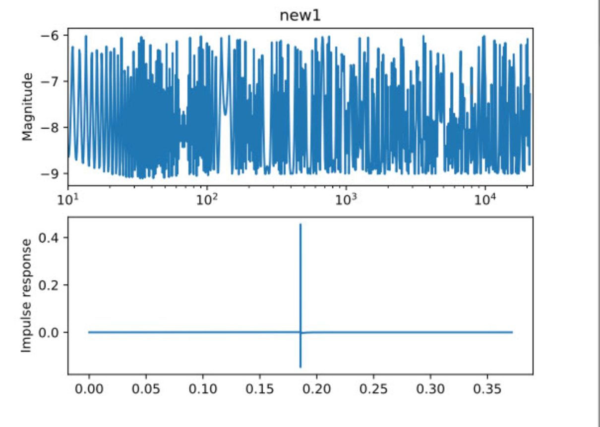

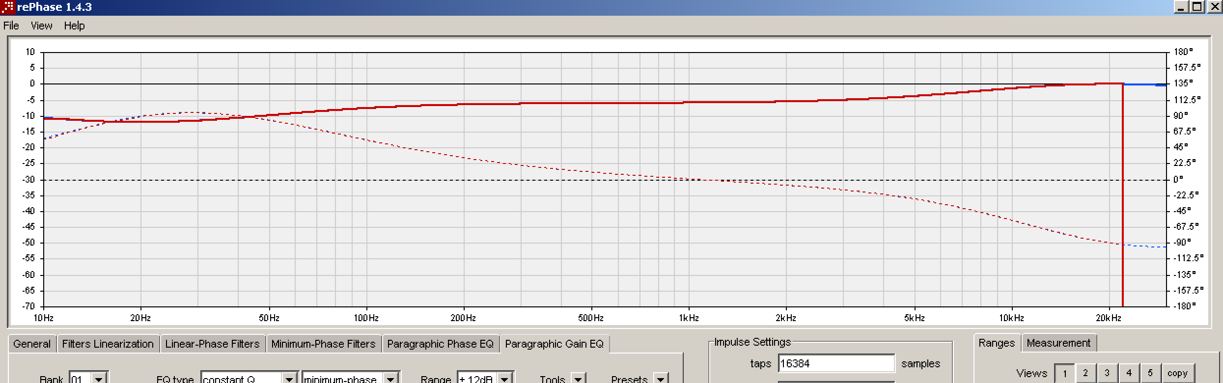

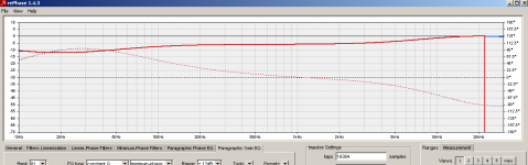

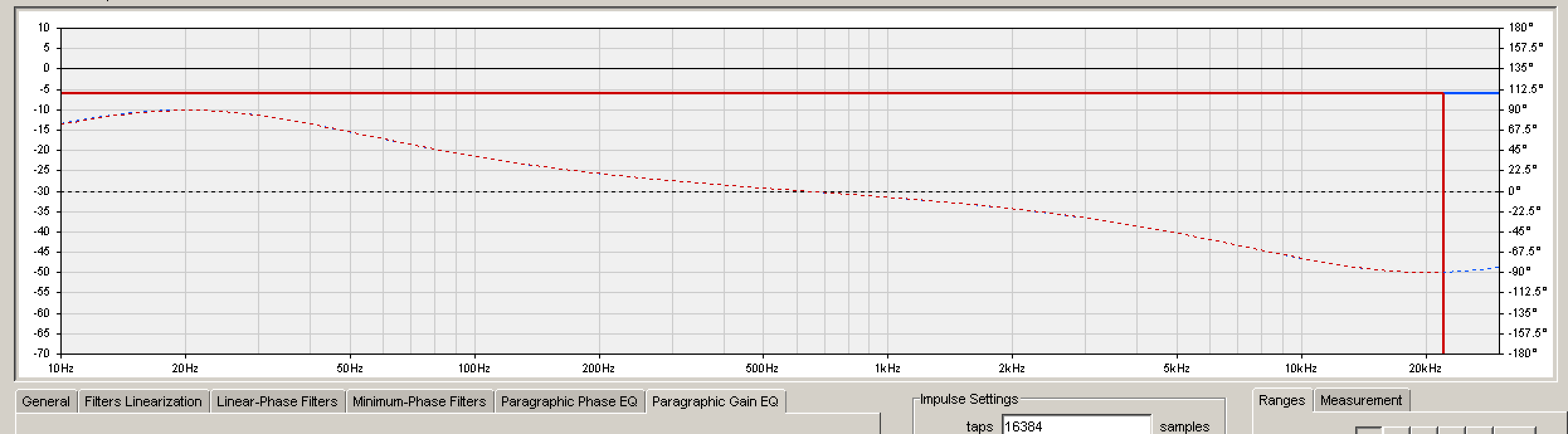

Using rePhase - Official Site - Free FIR filtering tool to generate FIR textfiles and comparing the Camilla plots (old version), they don't look the same - Camilla presents a lot more wiggles.
I tested 2 filter versions; one with only a phase adjustment (dashed line is phase, solid is level) and one with both phase and level EQ.
Both had a -6 dB gain adjustment in the filter.
In the "only phase" Camilla plot, it should be a straight line, no?
The wiggles are created by an interpolation step I added to reduce the number of points in the curves (to make plotting faster). The first version wasn't doing a good job with fir filters. It's fixed in the latest version of pycamilladsp-plot.
