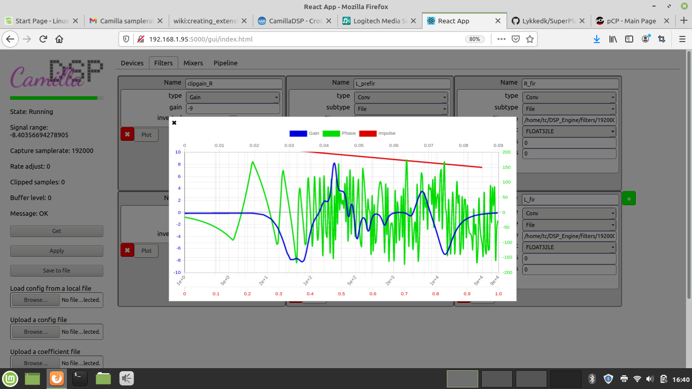

The new plotting without numpy is working on my pCP.
My testrig is an RPI3B and it's loaded pretty hard....
The higher the samplerate, the higher load, and i use two filter pr. channel as seen in the plotting... Perfect! :D

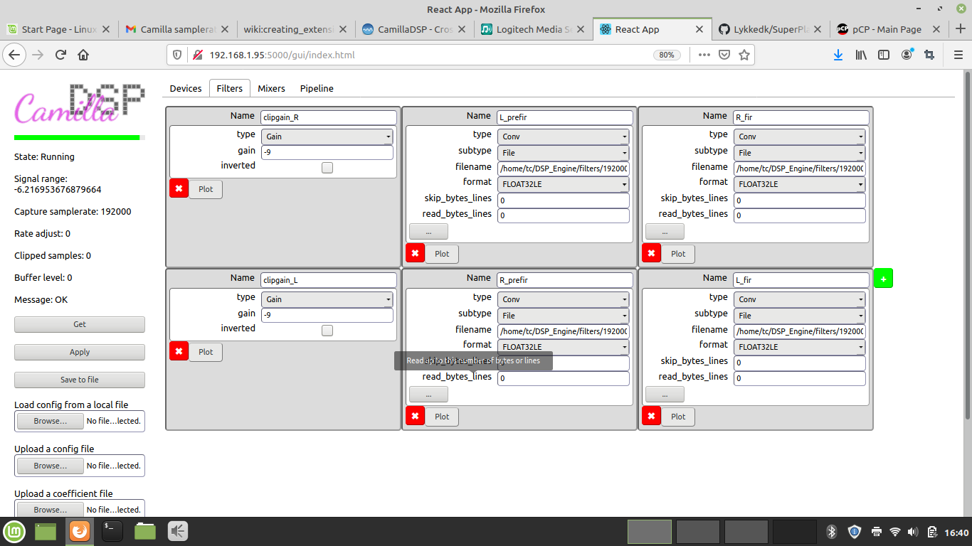

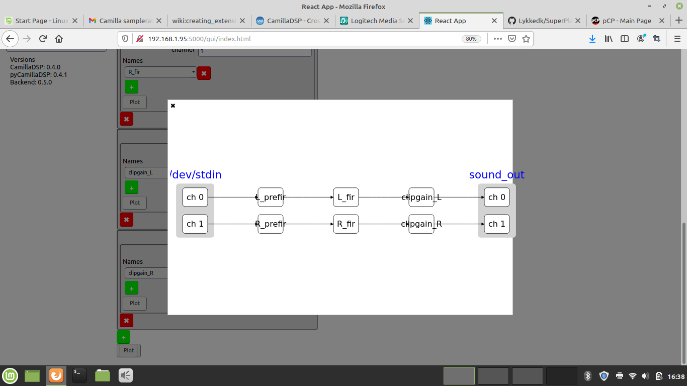

Hey guy's...
I can't remember detail's about my filters; i created them months ago :)
My workflow was.
Taking 4 measurements, around center + center of listning posistion.
AVG them and create EQ with REW (EQ are samplerate independt at this point)
This is the Pre-Filter.
With Pre-filter in convolver (camilladsp), i took 4 more measuremnt's and AVG'ed them.
Those measurement's are then samplerate converted and after that i created new filter's with DRC-fir or DRC-Designer. (As i remember :confused::):confused::))
Therefore i have a chain like this. -The -9dB gain is to avoid clipping.

His filter has a peak gain of just over +8dB! Check the blue curve in the plot from the gui. Considering that, I don't think -9 is unreasonable :)
But I am still lost here... I thought that the -9dB clip gain had to be done before the filters. Or else the clipping has already been done..? Is there "unlimited" amplitude margin as a result of float calculations?
In some DSP's it does need to be done before because they have hard limits and will clip if you don't. In software it is much easier to leverage the dynamic range of the bit rate and avoid that, if the processing is done at 64 bits then there is 384dB of range which makes inter process clipping almost impossible. But if you don't bring it down afterwards the result will be the same :)
In Jesper's case he might actually need -12dB to avoid any oversample peaks.

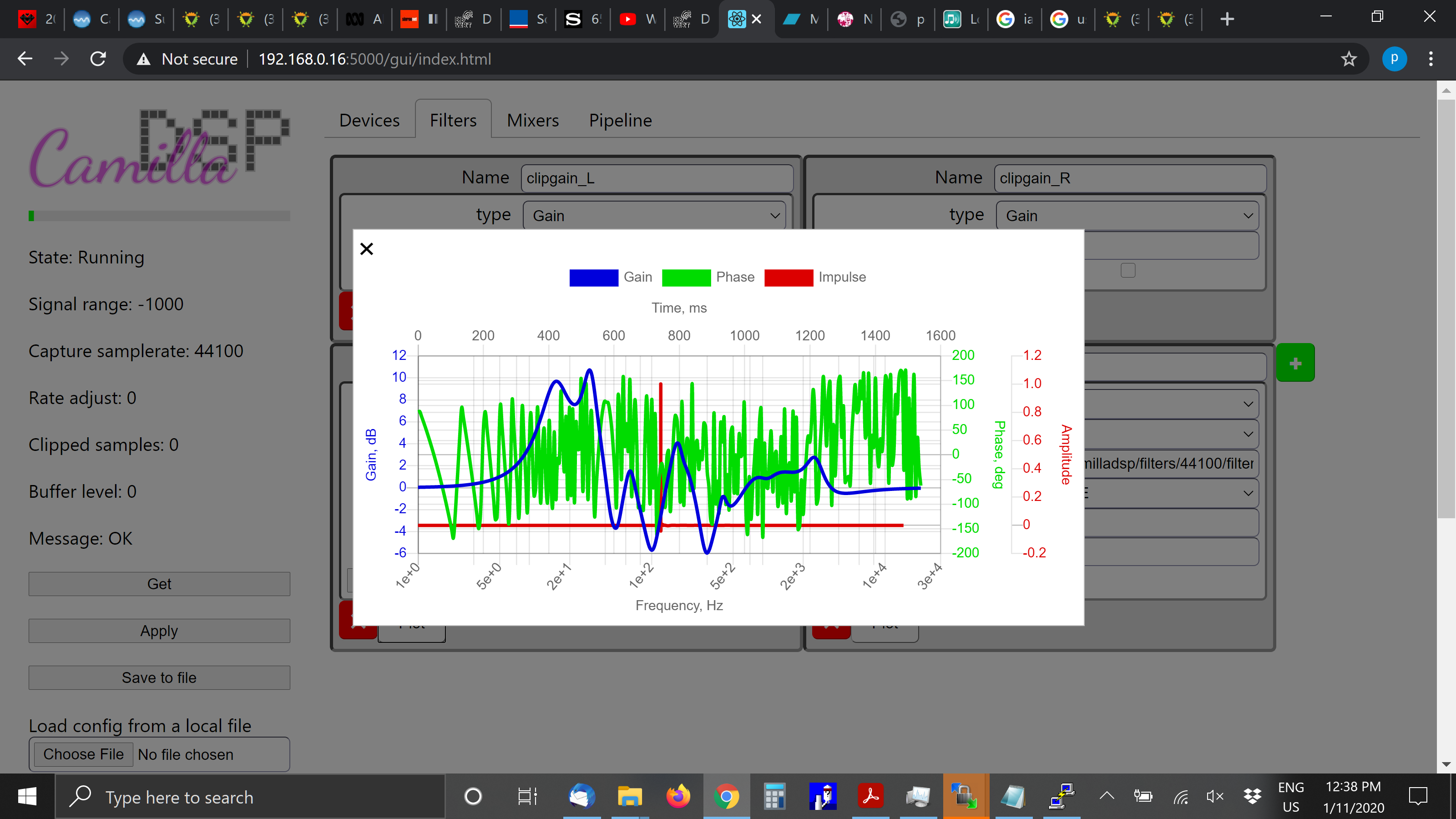

I found a few bugs, most important one is that the amplitude axis of the impulse response plot was missing. I also added axis labels.
And I optimized the fft used to plot FIR filters, it's about 4x faster now!
New versions:
Backend:Release v0.5.1 * HEnquist/camillagui-backend * GitHub
pycamilladsp-plot: Release v0.4.2 * HEnquist/pycamilladsp-plot * GitHub
Excellent! All good now Henrik. Thanks. plotting takes less than seconds now. Filters are 65536 taps I think .dbl format generated by rephase.

So, i shoulden't care moving my -dB gain in the pipeline, to be at front instead of last ?
