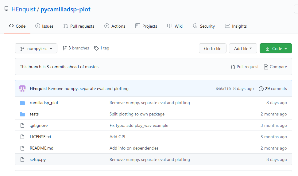

This is what I am getting as message:
plotcamillaconf /media/diskstation/chris/camilladsp/configs/FIRversionC.yml
Traceback (most recent call last):

Ok! Yu probably have a numpy version older than 1.17. But don't bother updating, the next version won't use numpy at all 🙂

@Henrik...
Well i was storking your'e github and i see that you have a numpyless development in the github 🙂
Looking forward to see when it's eventually done.
You also mentioned some time ago, that you are developing a plugin without matplotlib also, is this part of this development (not to rush you at all, just curious) :up:
