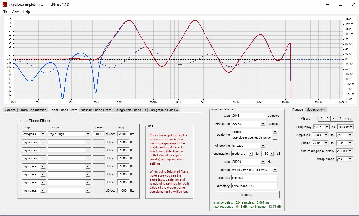

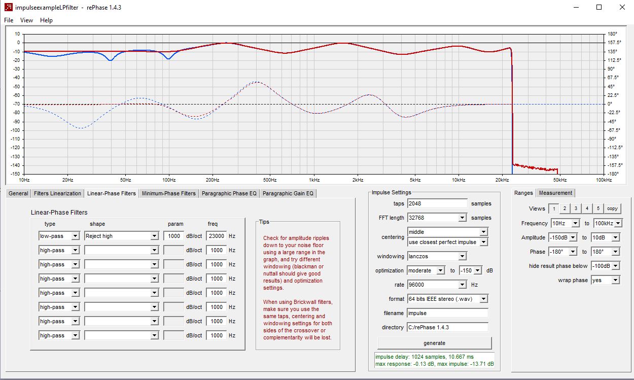

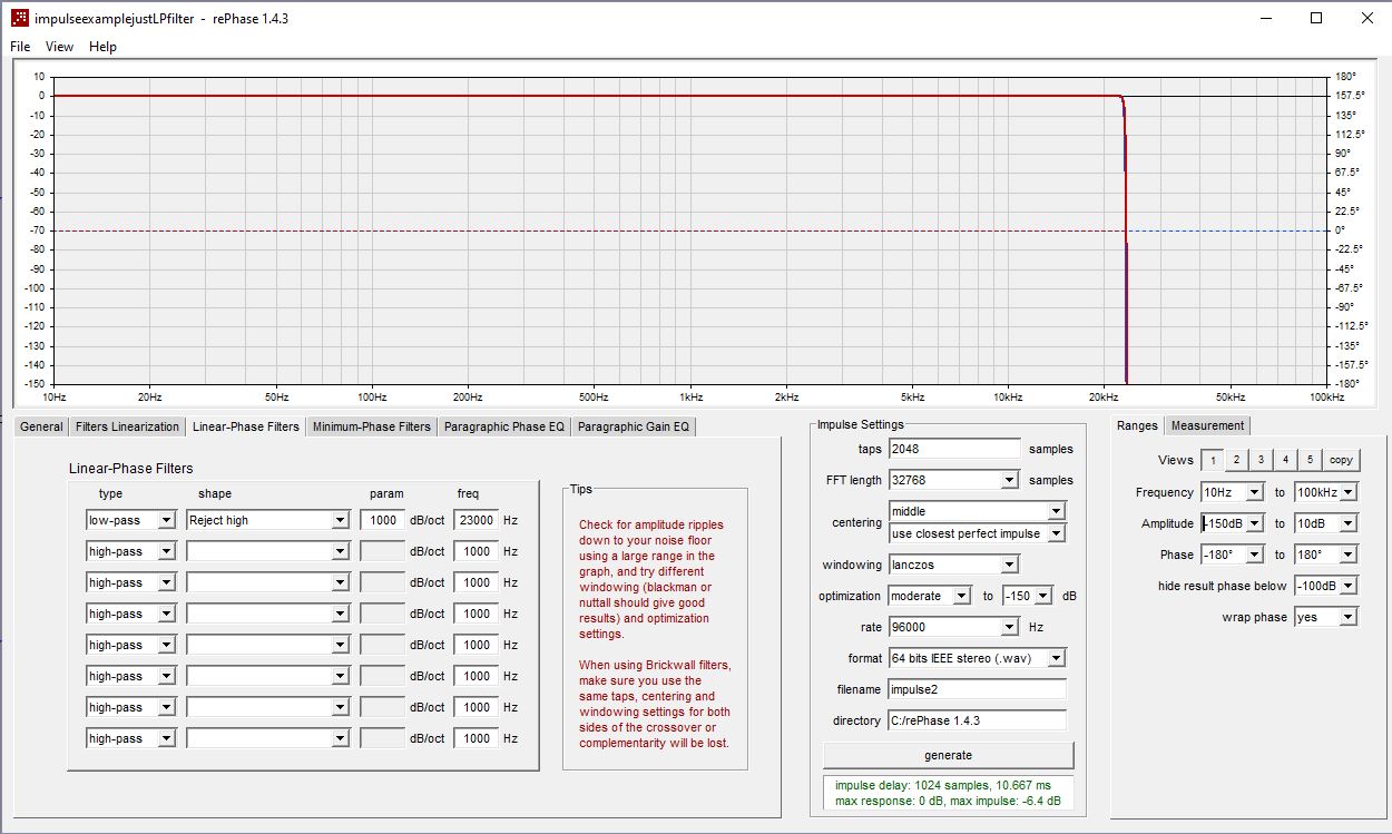

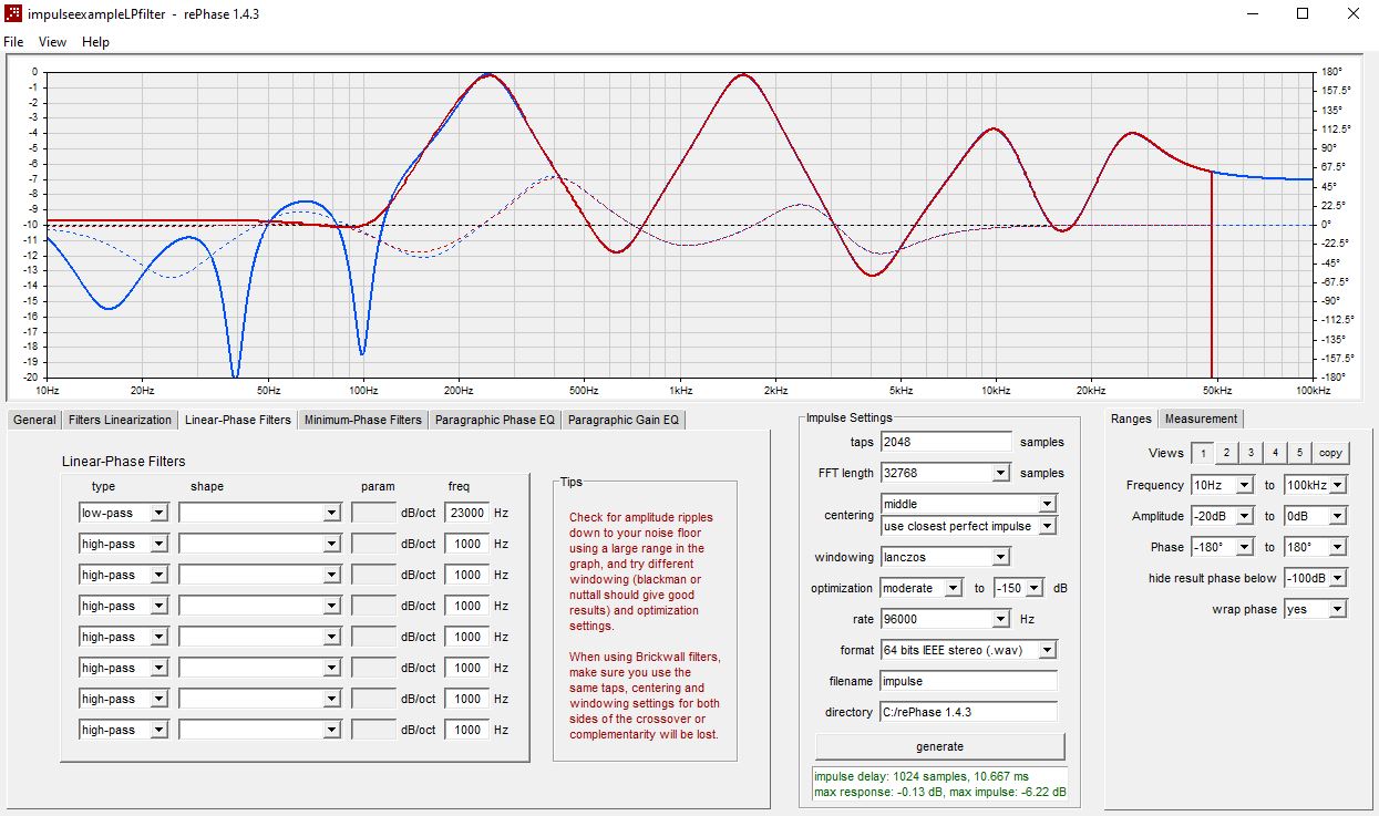

Yes there will be a delay. The lowpass interpolation filter is linear phase (a windowed sinc in the time domain) so there is a little pre-ringing. The delay is needed to make space for this. It's not a big delay, just 128 samples or so.
I just did some generation of filters i RePhase to see if combining FIR and LP gives any disadvantages.
Can't se much deviation between FIR filter with LP filter and without.
But some deviation on the LP filter near the noise floor when adding FIR filter.
See pictures.
This is the reason i think the two filtes can somehow be combined without extra delay, but it is maybe not worth it to save 128 samples. (1-3ms delay)
