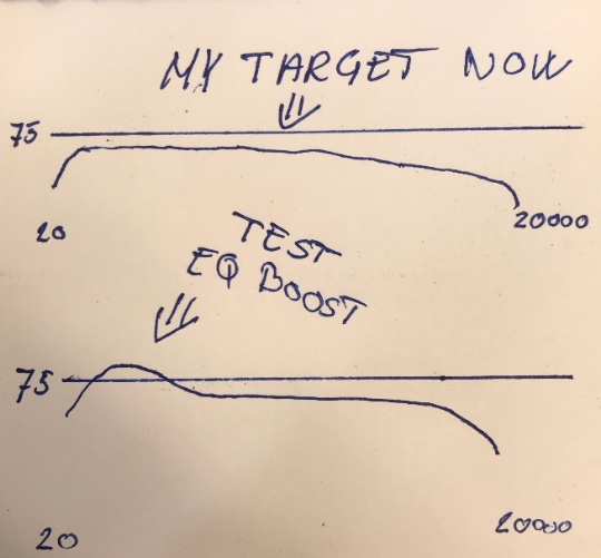

I didn't do any test yet, but the EQ i will most likely like to try is like this one i attached here, whatever this is called technically wise i do not know through...
My target now? Is it what you have or what you want?
Well, that would be a Peaking filter - copy my example from above and post your alterations to see what you ended up with...

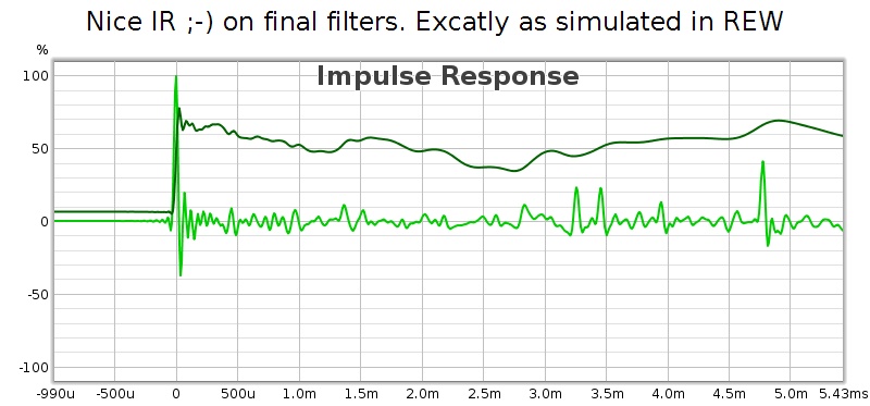

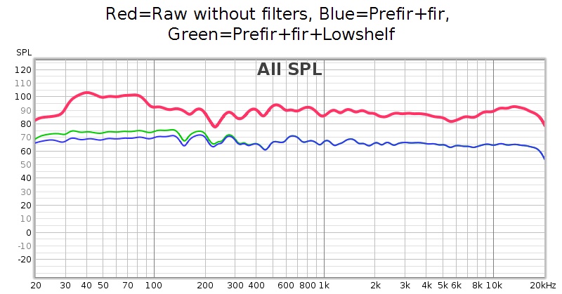

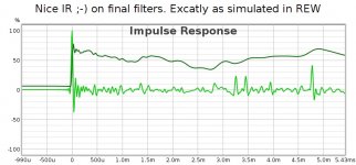

Hi here 🙂
As it was bad weather yesterday, i thought i would use some time with my setup.
I was home alone so livingroom became testcenter for a day 😀
I created some "final" filters for my gear, which is a prefilter and a final fir:
I created my prefilter by taking four sets of measurements (4x44100Hz + 4x48000Hz) in front of my couch (listening positions), time aligned and vector averaged them. With this
i created my vector average prefilter's with rePhase (i use .bin files).
Then i applied this prefilter to CamillaDSP and took another four sets of measurements, which was also vector averaged and time aligned. With them remeasurements i created my real fir filters with DRC-Designer.
I also samplerate converted the stuff along the way to give me a complete set of filter from 44100 to 192000Hz ... nice to have !
I simulated the final correction in REW, and took measurements to see if it was the same.
The simulation and the "realworld" measurements are allmost identical 🙂
Today i tried some of what TNT suggested for boosting the bass area, and it's working real good. But i have to take care and look for clipping when boosting i found out.
With my filters having -9dB of gain, and applying 5dB boost, it's below clipping in my setup.

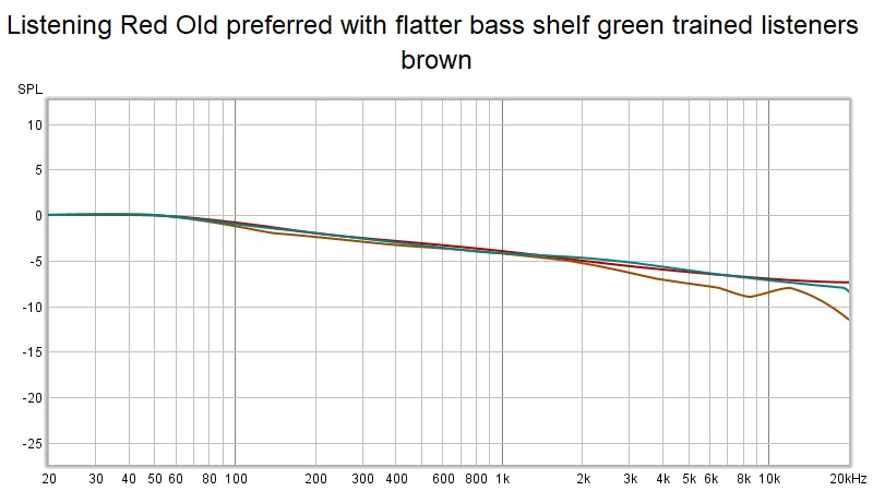

The way I have found to work best to find my preferred overall curve is to correct the speaker to flat with desired low end roll off in DRC and then use IIR shelving filters to set the frequency balance.
This would stop boosting from being an issue as the shelving is using cuts only.
When there is a realtime GUI then this would be quite easy with camilla.
I routinely come back to virtually the same curve time after time no matter which way I get there.
