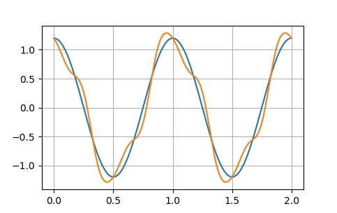

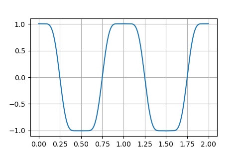

The maximum peak you see is in the frequency domain. The maximum peak value in the waveform lives in the time domain, where things aren't as simple. Even if a filter has a gain of below 0dB at all frequencies, it can still produce peak values that are larger than the original signal.What i would like to know and hoping someone can explain is about clipping :

Take this simple example, a 1kHz sine wave with flattened peaks:
Then we try two different things. First, lets try to remove the higher harmonics with a low-pass at 2 kHz. The result is the blue curve. Second try, let's just shuffle the phase of the harmonics a bit, without changing their amplitude. That becomes the orange curve.
Both curves have values above 1! This is a very simple example and with more complicated signals and more complicated filters, the peaks can be much higher. The theoretical max for a long filter is very high. But it's also very unlikely that you would ever encounter a waveform that makes it happen. The best approach in practice is what you have done, to adjust the attenuation until the clipping warnings go away on normal music.
