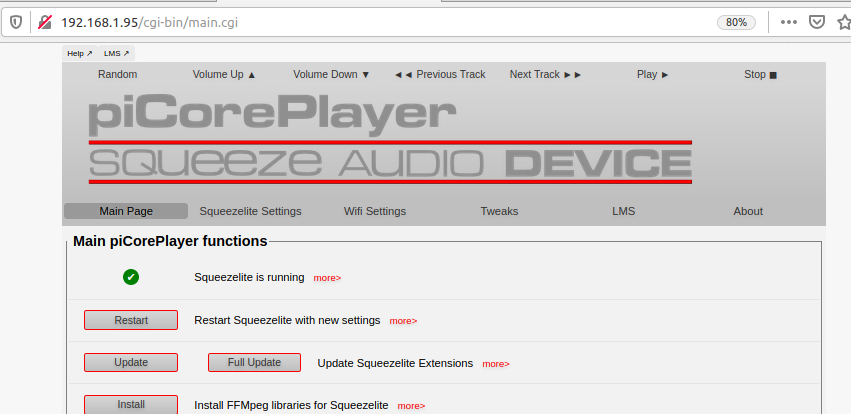

Hi Jesper. I got the auto sample rates working with my filters. But only if I kill squeezelite-custom and restart it using your parameters after reboot. viz :
sudo /mnt/mmcblk0p2/tce/squeezelite-custom -n piCorePlayer -o squeeze -a 160:4::1 -b 10000:20000 -r 44100-192000:2500 -U -U -z
After that the PS command shows in putty :
/mnt/mmcblk0p2/tce/squeezelite-custom -n piCorePlayer -o squeeze -a 160 4 1 -b 10000 20000 -r 44100 192000 2500 -U -U -z
Without killing squeezelite-custom after reboot I get this from PS :
Is the problem the -z option? or the extra space before -b? I can't see how to set -z in the pcp web interface. What does it do?
Hi...
The two lines actually does the same thing.
The -z you paste when starting it manually is only to have it running as a daemon.
When squeezeite-custom is started at boot, it is started through some script doing the same thing as the -z daemon.
What you shhould do is to change the parameters in the squeezelite webinterface, save the settings and watch for that pCP telling you that squeezelite is running.
I'am sure that problem is the pCP squeezelite settings!

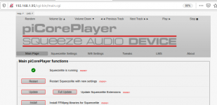

When i start my testrig player the ps outout is like this ;
tc@piCorePlayer:~$ ps aux | grep squeezelite*
1432 root 0:01 /mnt/mmcblk0p2/tce/squeezelite-custom -n piCorePlayer -o squeeze -a 80 4 1 -b 10000 20000 -r 44100 192000 2500 -s 192.168.1.29 -U -U
Jesper.

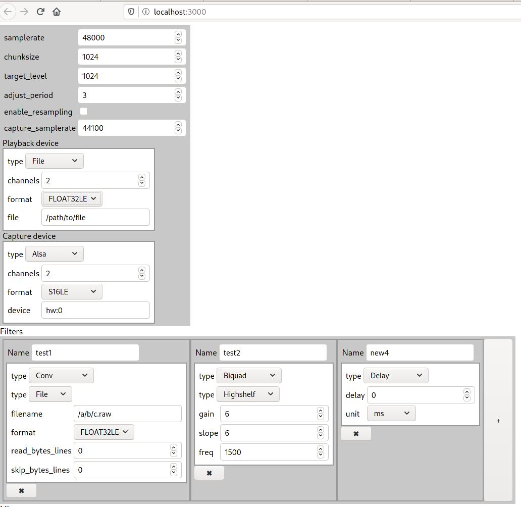

Minor update: I have now tested v0.3.1 enough to make it a proper release. There are new binaries to download but they contain no changes from the 0.3.1-alpha. No need to update if you are already running that one.
Another piece of news is that I now have a proper Mac to test things on. Right now I'm using it to listen to music with Spotify -> virtual sound card (BlackHole) -> CamillaDSP (dummy filter, resampling and rate adjust active) -> built in headphone output. It's working just fine 🙂
Oh and one more thing. I have started building a gui for configuring CamillaDSP. It's based on React.js, so it runs in the browser and will communicate with CamillaDSP via the websocket server. Remote control will be possible! At the moment it's mostly a mock-up and I probably need at least a few more weeks before it's usable. I'm quite new to React (and javascript) so it's not going very fast but it's a very useful learning experience.
Looking forward to this 🙂
I guess you give the possibilities to configure the .yml files online, with all it's parameters (chunksize, samplerate, resampling, gain etc... etc..)
Well i donno if you have the option in mind to make it possible to apply some EQ directly to the pipeline. Let me explain: I have some filter which i could find very interessting to have some EQ applied at maybe the "bass <200Hz" area, this way i can better determine if i bother to make some new filters/firs for this!... hope you understand?
Aka'a a standalone apply able equalizer 😀
Jesper.
Very cool. I would suggest switching to typescript. It’s much cleaner and let’s you make less mistakes. I could give you some pointers here and there.
Yes that is exactly the plan!
This is how it looks right now. Devices and filters are almost done, I'm working on mixers, and haven't started on the pipeline yet. Yes I know it's ugly, but I won't spend time on the looks until it's working 🙂
Jesper.
It will be easy to add for example a shelf to boost/attenuate everything <200Hz. Or a Peaking filter to only modify around a specific frequency. Is this what you mean?
Would be really great if the ui would plot the actual combined frequency/phase response of a channel. You could use something like react-charts for that. This might help converting the FIR (and IIR) coefficients to frequency and phase response graphs. And if you can actually do that, than it's a small step to also incorporate the frequency response of the unfiltered system, so you can immediately see what your doing. Final major milestone would be a proper FIR filter designer via a web interface 😀
Yes I think some plotting would be quite useful. First I'll just make it work, then the plan is to start by including the functionality of the show_config python script. That will keep me busy for a while. Then we'll see about more stuff 🙂
Thanks for the tips on fili and react-charts, they seem to have a lot of the stuff I will need.
