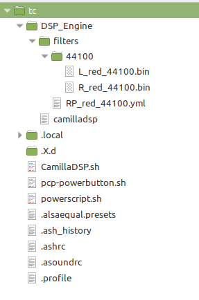

For reference, the filestructure should look like this with my setup.
Jesper.
I think maybe Camilla is not running.
tc@piCorePlayer:~$ sudo /home/tc/CamillaDSP.sh start
already running.
tc@piCorePlayer:~$ sudo killall camilladsp
killall: camilladsp: no process killed
I cannot see it using ps aux :

Only listed if I use ps aux with grep :
tc@piCorePlayer:~$ ps aux | grep camilladsp
15334 tc 0:00 grep camilladsp
Okay...
Problem is that camilladsp is not running for sure.
Are you using the camilladsp i use (old one)?
So again try to
sudo killall squeezelite
and
Do it twice to be sure!
Try to start camilla like this
sudo /home/tc/DSP_Engine/camilladsp -v /home/tc/DSP_Engine/filters/RP_red_44100.yml

Thanks Jesper for all your help. I used the camilladsp from the archive link you posted in post #530

Remember to place it in /home/tc/DSP_Engine

It works because you are not outputting to the soundcard directly, but through the plug plugin (plughw instead of hw) ALSA project - the C library reference: PCM (digital audio) plugins . In your case the plug takes care of channel count conversion.
The other asoundrc defines the output devices directly to the driver which accepts only 8 channels
Code:
pcm.sound_out {
type hw
card 0
device 0
The easy way to troubleshoot is using debug mode of aplay together with the --dump-hw-params option:
Code:
aplay -v --dump-hw-params -D yourdevice /dev/zero
