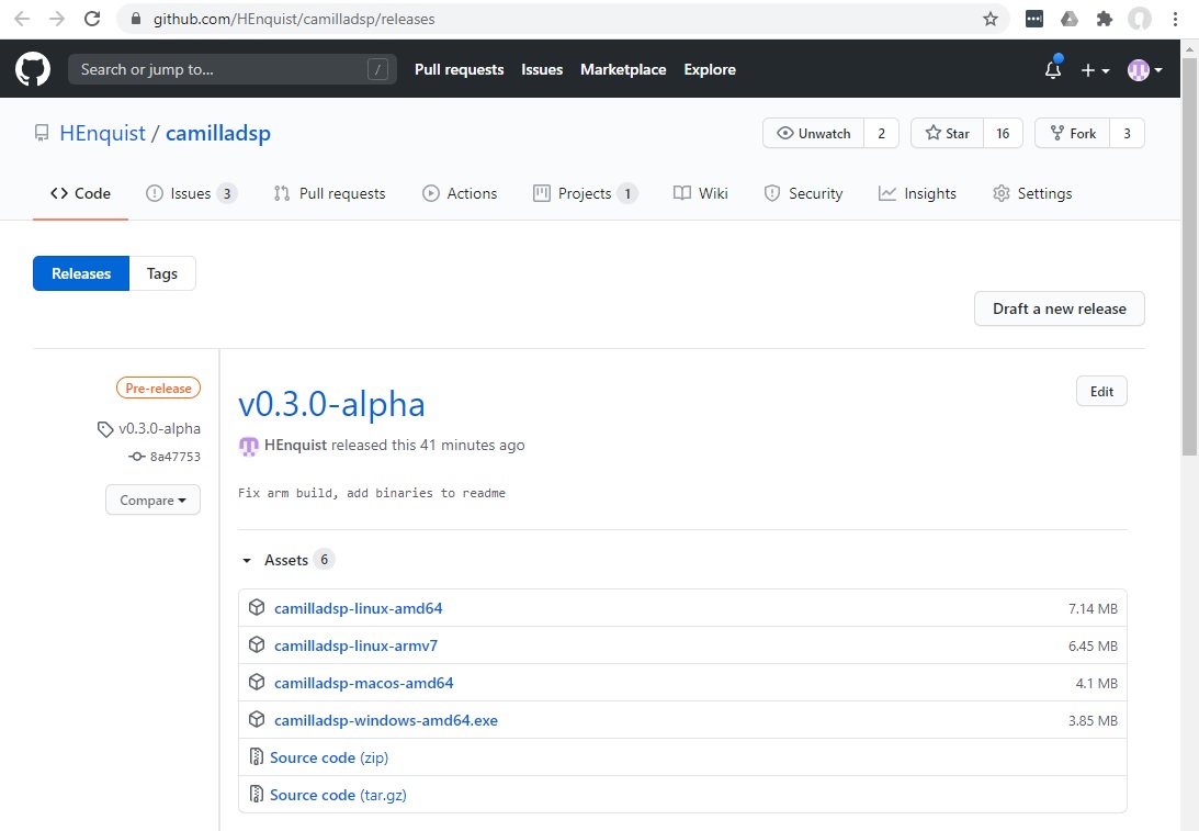

Another update, pre-built binaries for the most common systems! These are built and published automatically for each new release.
I'm currently building for Linux on AMD64, Linux on armv7 (Raspberry Pi), Windows on AMD64 and macOS on AMD64.
(note: "AMD64" is one of the names for 64-bit Intel or AMD cpus, also called "x86_64" or just "x64")
See the Releases page here: Releases * HEnquist/camilladsp * GitHub. Click "Assets" to view the files.
The Readme for the develop branch has also been updated with this info: camilladsp/README.md at develop * HEnquist/camilladsp * GitHub

Found it. For mac you supplied a ".dms" file (?), usually we see a .dmg one. None of my extractors was able to open that download.
It's an uncompressed executable! Just make it executable with "chmod a+x camilladsp-macos-amd64". You will also need to mark it as allowed to run, click the question mark in the dialog that pops up when you try to run it with for example "./camilladsp-macos-amd64 --help".Maybe you want to use .zip for macos also, some do.
