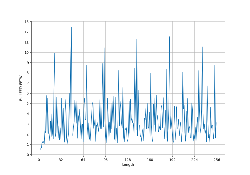

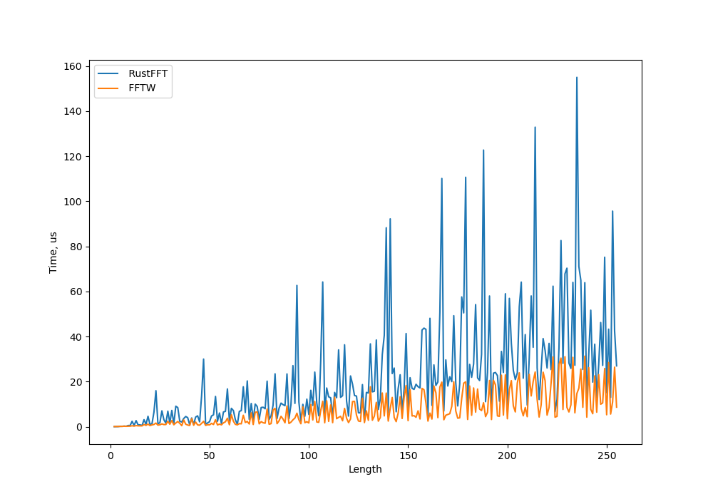

I made a simple test program to see how the speed is changing with FFT length. The code is here: GitHub - HEnquist/fftbenchingNice measurements, thanks. The difference on x86 for non-pow2 FFTs is not so big, FFTW has been heavily optimized for years on x86.
On the other hand the ARM side - I've read that rust uses NEON instructions - while I believe FFTW does too, the almost same values would suggest FFTW code is not so optimized on ARM and your library is perfectly on par. Great result, kudos.
For a perfect FFT the processing time would increase as N*logN, but in reality it's of course much more complicated.
First, this is how the processing time increases as the FFT length increases from 2 to 255.
My laptop with a Ryzen 2700u
Raspberry Pi 4

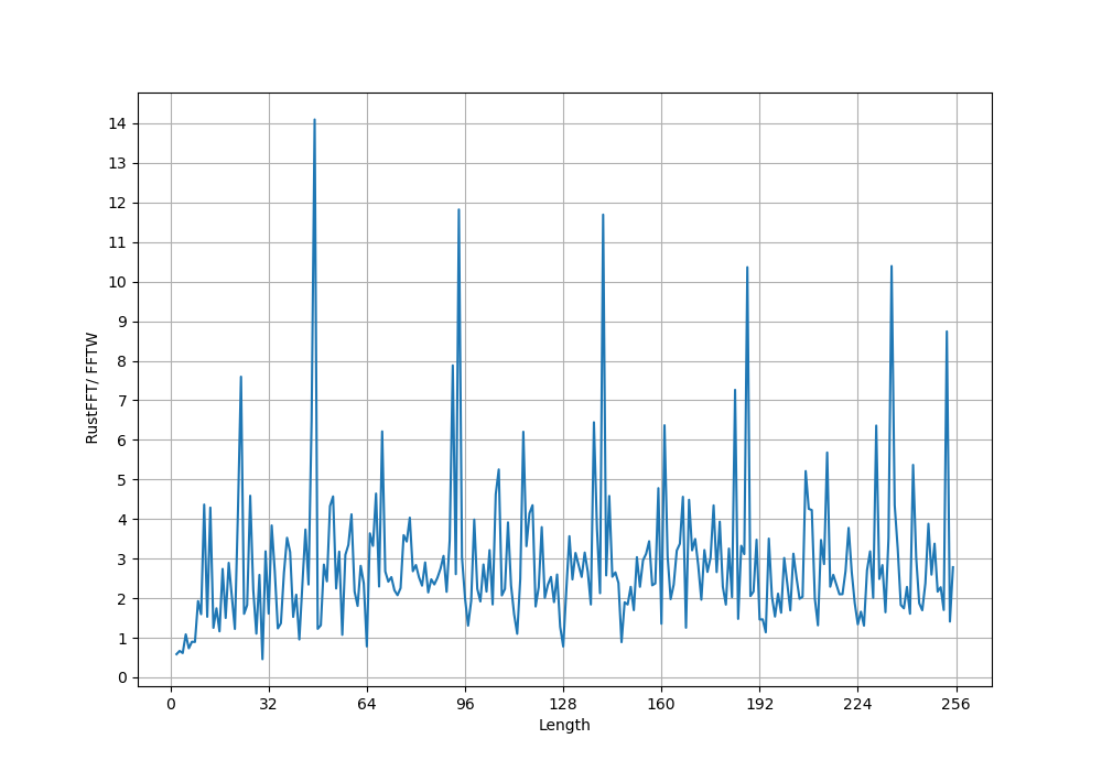

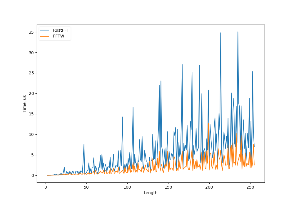

Since the first plots became a bit messy, I also divided the time for RustFFT with the time for FFTW.
Laptop with Ryzen 2700u:
Raspberry Pi 4:
I think that the main thing we can see here is that FFTW has a lot more different code paths to handle different lengths in an optimal or close to optimal way. This is one of the reasons why the FFTW library is so huge.
RustFFT is much smaller and implements much fewer special cases. Therefore it has to rely on more general algorithms for many lengths. These general algorithms are much slower than the specialized ones FFTW has. On the other hand, when RustFFT also has a specialized algorithm, like for powers of 2, there isn't much difference.
Rust can use SIMD in two ways. The simple one is to rely on the code optimization of LLVM to use SIMD. This is enabled by default and works for pretty much all instruction sets like AVX, SSE and NEON. This is what I am using.
The advanced way is to use intrinsics. This is very low level, you essentially tell the compiler exactly which instructions it should generate. The downside is that the code becomes specific to a certain instruction set so you need to write many versions of everything. This was is still very new in Rust and only works for SSE and AVX so far, while NEON is still unfinished. I played with the idea of using it for the asynchronous resampler but as it is now it's too much work. Once there are some libraries that abstract over many instruction sets, I will take another look.

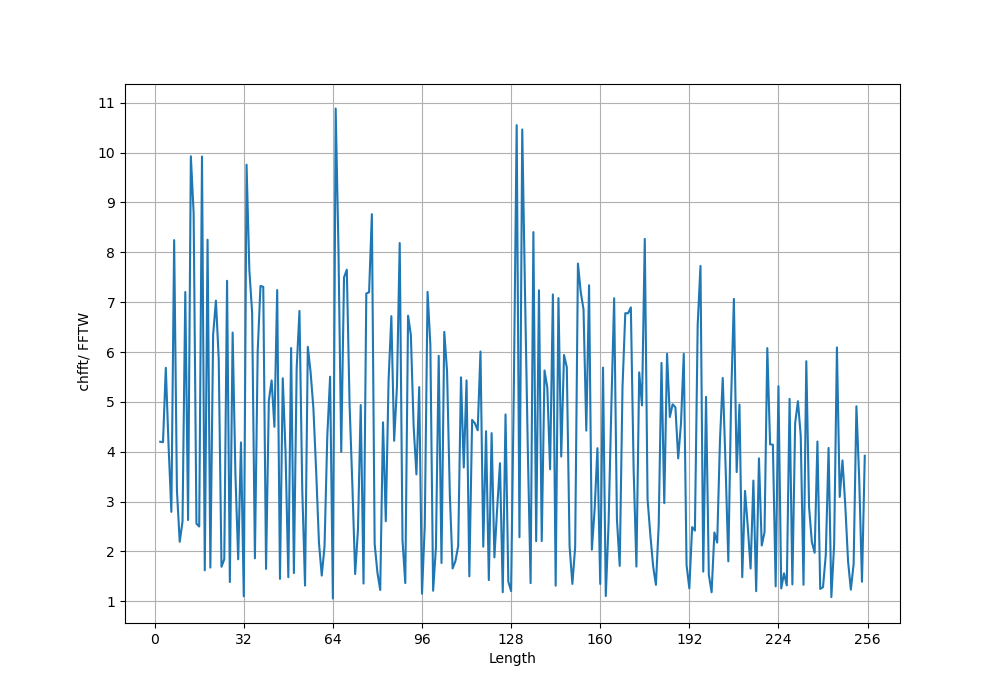

Just for fun, here are two more Rust FFT libraries compared to FFTW. This is done on my Ryzen laptop.
"fourier":
"chfft"
Compared to RustFFT they are sometimes faster and sometimes slower. But when they are slower, they are sometimes a lot slower. In total, RustFFT seems to be the best compromise. Maybe someone could combine the best parts of all three...
