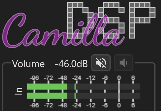

Henrik, while you are in the GUI, could you make the digits for volume in the display a bit bigger ? - in the pic could the -46 be a bit bigger and therefore easier to read on a display.

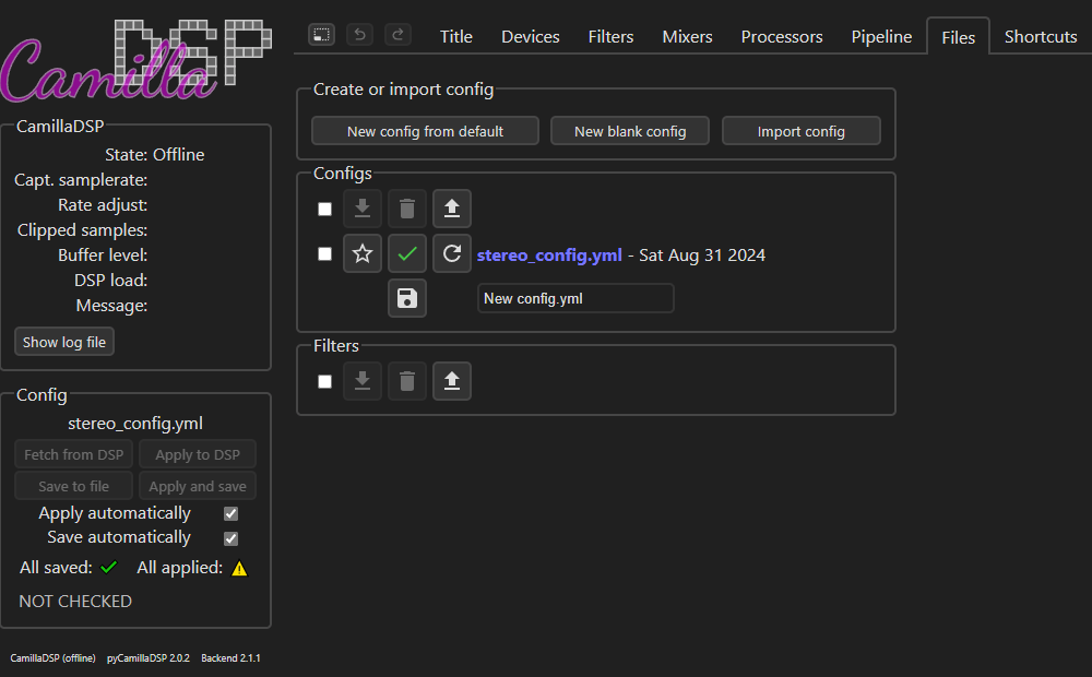

My first goal is to run camillaDSP and GUI for that I need a valid config file.I just want to be able to play some music from tidal on my windows 11 laptop run it through CamillaDSP and get sound out of my laptop speakers.
next step will be to make a bass boost just to try out a filer.
When that is done, I can move on to play with my new MOTU 5.
So, how does a minimum 2-channel setup looks like?

If you hit "New blank config" button on the Files tab and then fill in your specifics in the Devices tab - you are good to go ;-)

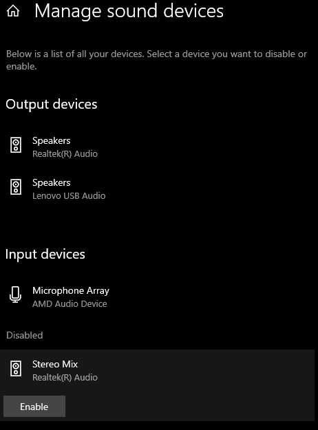

How to choose input and output devices
I have selected this as my output deviceBut I don't know what I should choose for my capture device.
Should I install https://vb-audio.com/Cable/ ?
