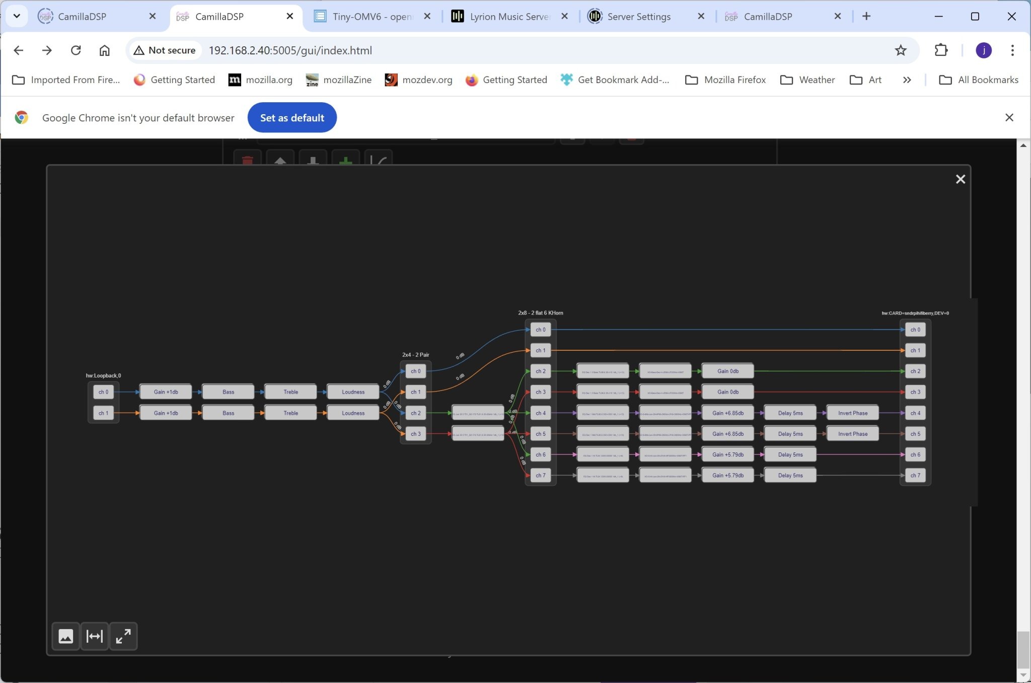

Thanks, when designing a active bi-amped crossover/PEQ with CDSP, if using a DAC like the DAC8x with no "physical" volume control, are you doing volume control in CDSP, if so, is a fixed resistor voltage divider being used to "physically" cap the volume to prevent mishaps or glitches blowing drivers or deafening people?
My MiniDSP SHD feeds directly into my power amps and there was a glitch that used to occasionally send the SHD volume to 0dB (like the "volume up" remote command got "stuck"), luckily my power amps are pretty weak but it sure upset the family.
