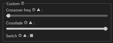

Is it possible to assign a custom shortcut slider to more than one config setting ?
It looks like the custom shortcuts are limited to numerical values and used with sliders

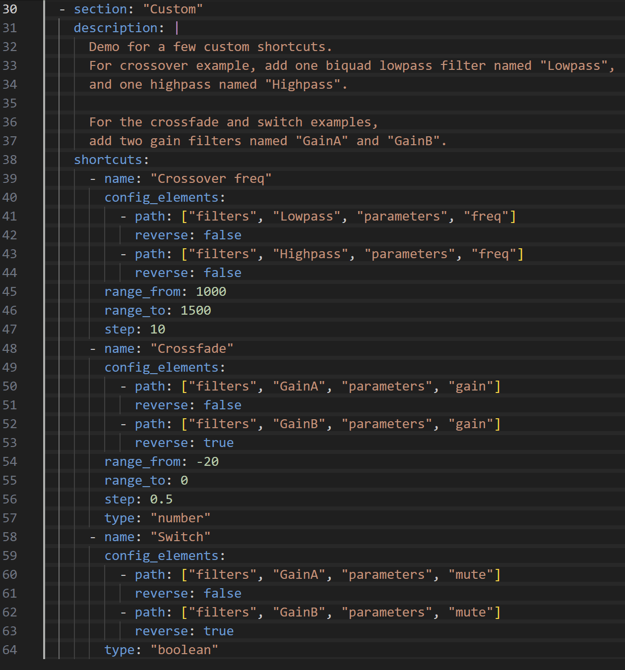

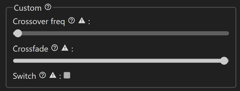

I have done both of these now, to be included in the 3.0 release.
Defining the shortcuts like this:
Produces this in the GUI:
The little alert icon is shown when there is some issue, and hovering over it shows an explanation.
That can be that some property in the config value isn't at the expected value (for example that the highpass and lowpass filters are set to different frequencies), or that not all paths are present in the config.

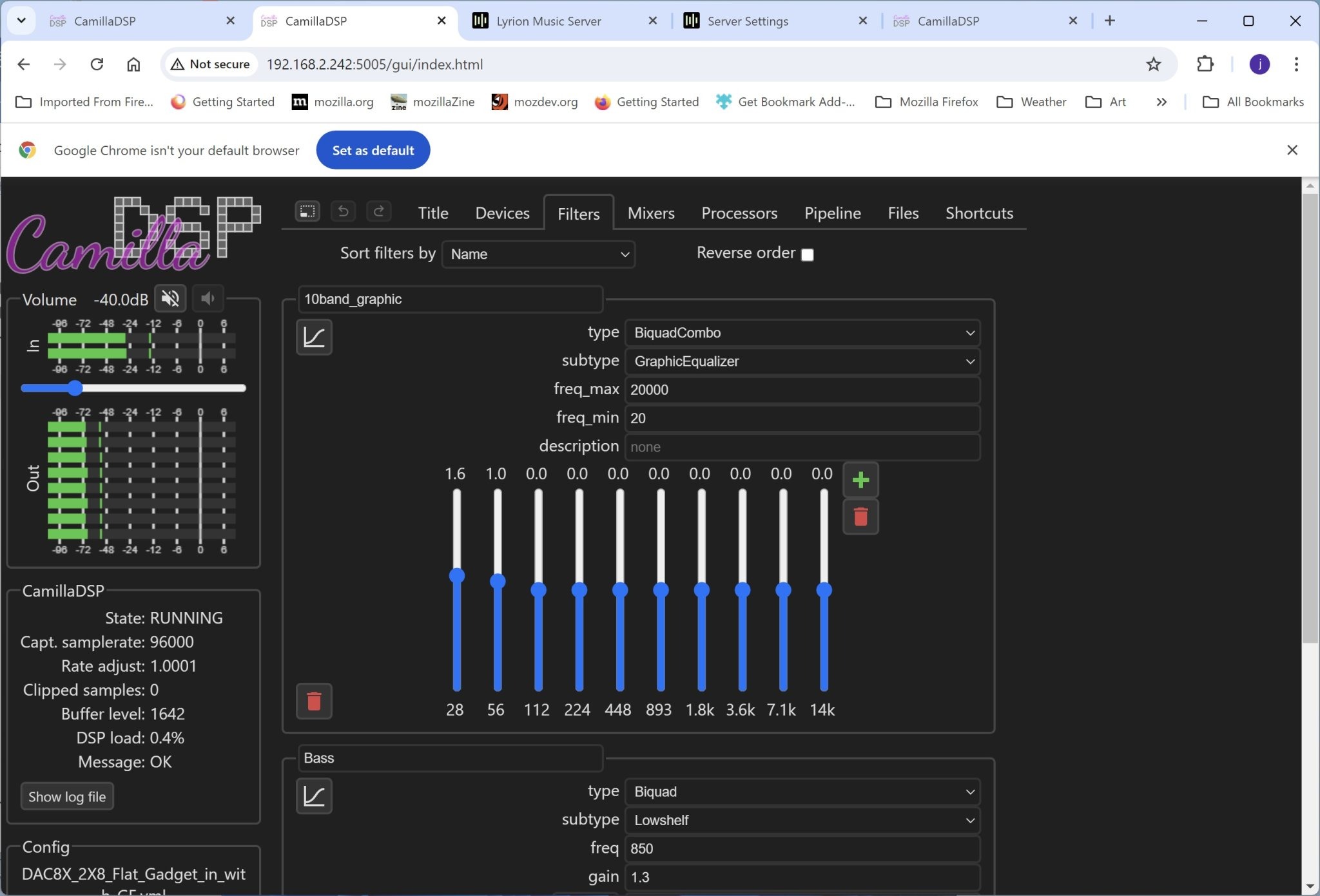

Would this 10 band graphic equalizer filter go from vertical sliders to horizontal ?
I don't use it, but built it out of curiosity. However, I could see a custom version of a graphic equalizer appealing as the slider would take effect immediately rather than requiring a restart.
It would work yes, but a bit clunky to set up. You can enable "apply automatically" to get the normal graphical equaliser to take effect immediately.

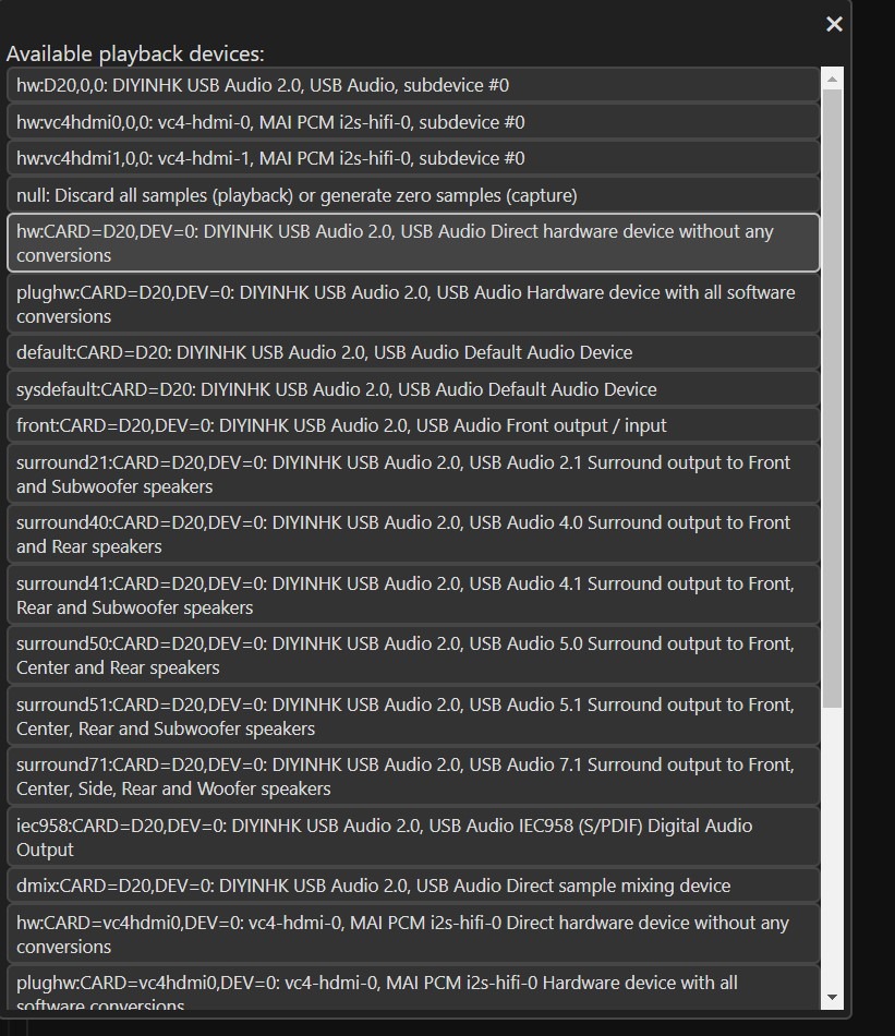

I'm trying to make a dedicated rPi5 USB DSP using CamillaDSP, as mentioned in other threads here.
All is working ok, including USB gadget.
I've run into one problem, though: The DIYINHK multichannel dac (XMOS based) is recognised ok and is listed as an output device (see screenshot). But after this, enormously loud pops come from all channels (the speaker cones move dramatically, I have to switch off the amplifier to prevent the drivers from blowing up).
This repeats every 4 seconds or so, until I change some settings in Camilla DSP on the output device.
Even when I disconnect USB, the pops continue, as if the XMOS is crashing.
It occurs when booting, as well as when connecting it after boot.
After some fiddling in CamillaDSP, the pops stops, and all works fine! Very strange. It seems like the XMOS needs to receive some commands from the rPi to behave itself........?
I read on github that @mdsimon2 got his DIYINHK to work, but that on the OKTODAC8PRO (which also uses the DIYINHK XMOS firmware) some firmware versions gave problems.
Is there a way to solve this?
It has been a while since I used the DIYINHK XMOS with a raspberry pi but it seemed to have issues compared to using it with a Mac. I was using a RPi4 and found some of the insane popping / squealing observed on restarts went away if using the USB2 ports instead of USB3 ports, I haven't tried it on the RPi5 so not sure if it is similar.
I don't think Okto have used the DIYINHK XMOS firmware for a while now, definitely not in FW 1.5 or 1.6. Although I've never had any popping issues with the Okto on FW 1.42, 1.5 or 1.6.
