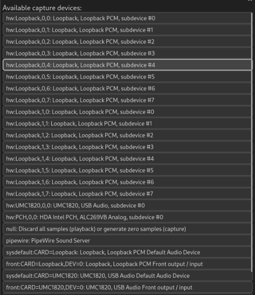

I am kind of stuck (I think). I made CDSP with GUI to the running state, my config is finally OK. However while playing, I see no bar graps moving when playing a youtube video. I am not sure which loopback card to select from these:
My guess would be the first one. Am I correct that the bargraphs should actually show something when the sound is playing? I have my sound output set to loopback, using latest Fedora (installed yesterday). I used the default config files from Henrik's repository to create the loopback. I think I must have missed something. Now running CDSP and GUI from command line, I installed it using the poetry script which went really smooth.

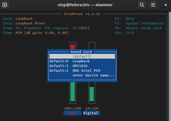

This is what Alsamixer shows when F6 is pressed:
Thanks in advance for helping me with what I hope is the last step:)
How/where did you select the loopback? In the audio section of the system settings? And did you modify any pulse audio config files?
If you select Loopback,0 as playback device, then you need to use Loopback,1 as capture device (or vice versa). The second number is subdevice. It's often omitted and then defaults to 0, so Loopback,0 is equivalent to Loopback,0,0.

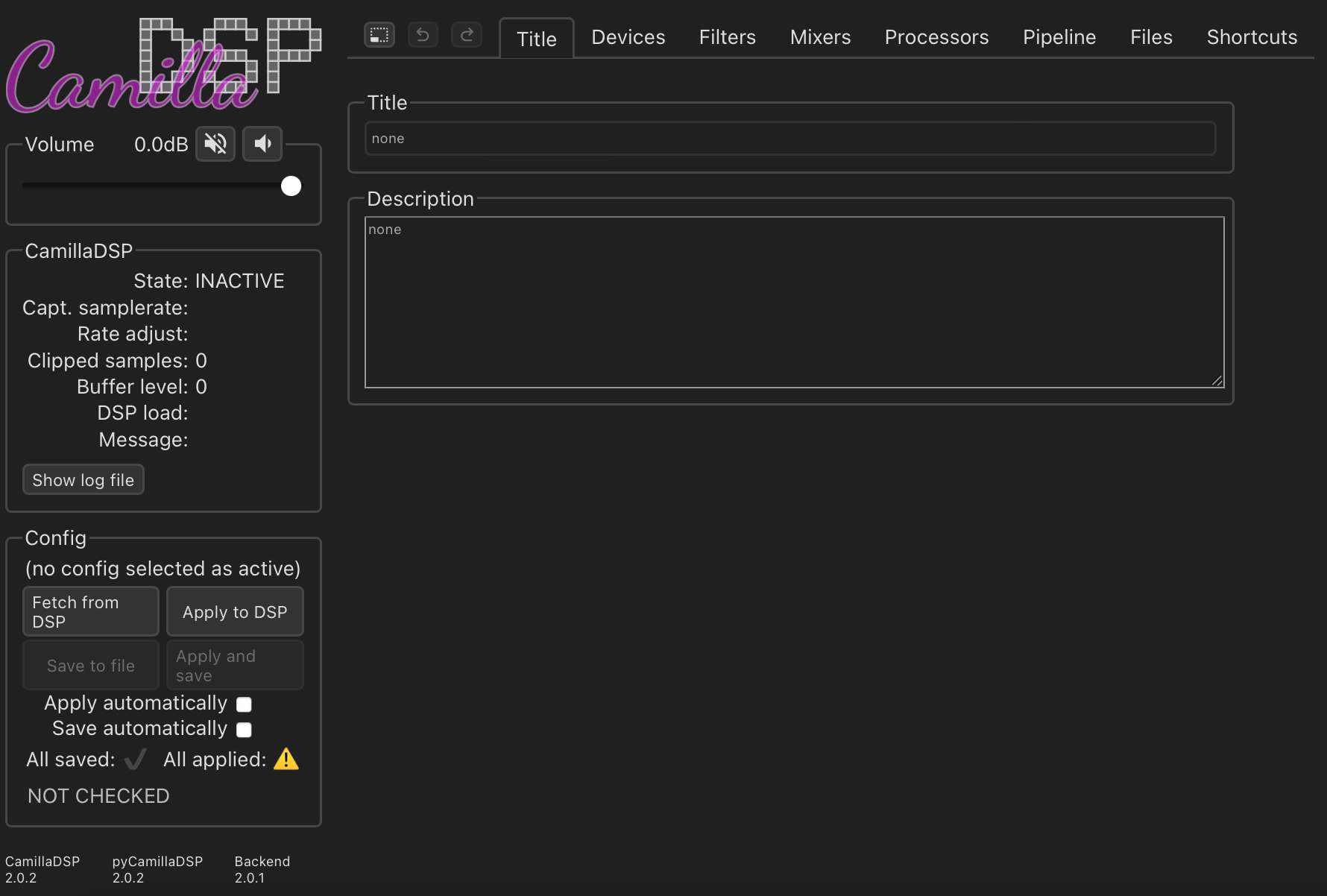

12) Open a browser and navigate to http://YOURIPADDRESS:5000. You should see a webpage that looks like this.
Once get this far let me know and we can work on the launch agent / configuration.

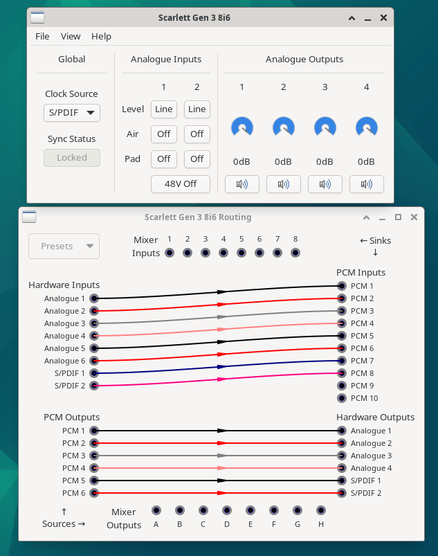

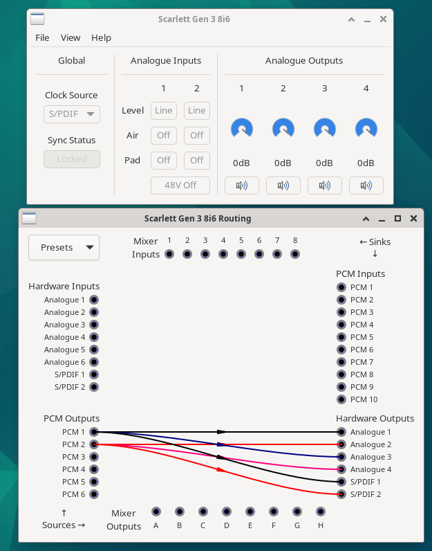

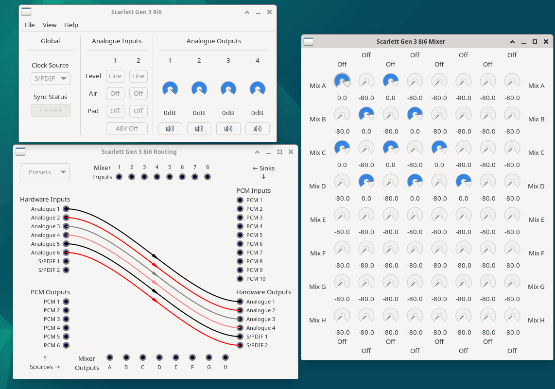

For anyone using Linux and a Focusrite sound card, there is an updated alsa-scarlett-gui alsa mixer with patch panel UI.
It should make configuring your Scarlett/Clarett easier on Linux than using the default alsamixer.
It uses a newer graphics library and the kernels listed below.
https://github.com/geoffreybennett/alsa-scarlett-gui
  • Scarlett Gen 2: Linux 5.4 (bugs fixed in Linux 5.14)
  • Scarlett Gen 3: Linux 5.14
  • Clarett+ 8Pre: Linux 6.1
  • Clarett 2Pre/4Pre/8Pre USB, Clarett+ 2Pre/4Pre: Linux 6.7
This is the 3rd Gen 8i6 interface examples:
