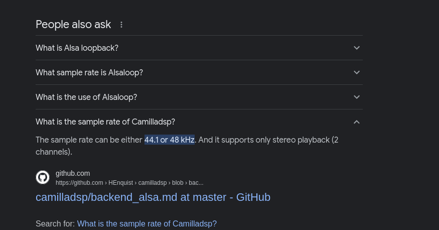

FWIW, I was searching for loopbacks and saw this Q&A which gives readers the wrong impression that CamillaDSP is limited to stereo and 44.1/48kHz.
Might want to change the text to specify "In this SPECIFIC EXAMPLE" or something similar.
Hmm it already says that in the sentence before. This is another nice example of Artificial Stupidity being "helpful".
AI models are trained with modern MSM's innate ability to selectively take things out of context. 🙄These "clever" knowledge extractors (incl. "AI") will cause many problems when exact and true information is required.
