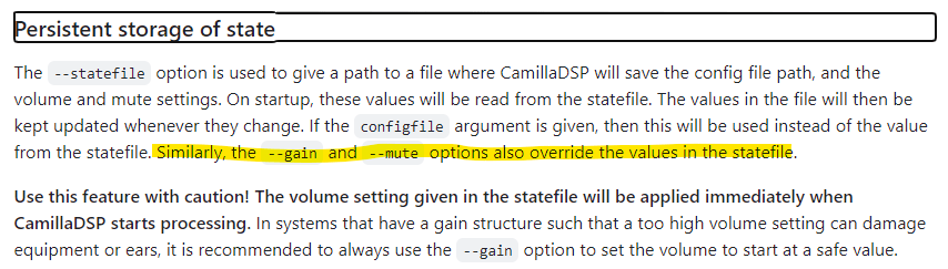

Thanks for the info. The statefile seems to work well. Only issue I am seeing is that I typically specify a gain of -40 in my service to ensure that CamillaDSP always starts at a low level. From the documentation below my understanding is that this -40 gain should be applied on CamillaDSP restarts, however this is not happening, and the gain reverts to the last volume position.

Thanks for testing! I'll take a look. There is a lot of new code to handle the statefile, not surprising if there is a bug or twothis -40 gain should be applied on CamillaDSP restarts, however this is not happening
@TNT thanks, that doesn't look quite right. Will fix!

The initial volume and mute issue is fixed.
