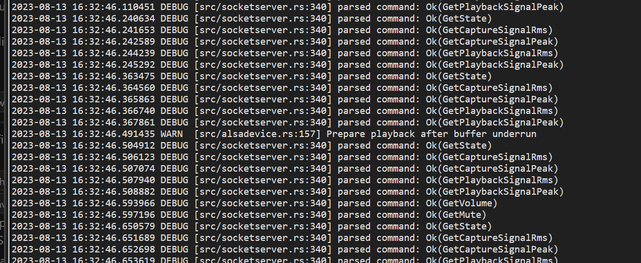

ok, was paying close attention, and maybe i need to observe for a longer period, but i believe the message that i get each time there is channel switch is this "prepare playback after buffer underrun" warning:
I have a chuncksize of 1024, queuelimit 4, adjust period 10 and target level 1024. I know the tricks to minimize buffer underruns, but still wanted to know if you think this could be the cause. i will proceed now to change the settings to minimize buffer underruns and see if that minimizes channel jumps too.
I believe i did not mention this before, but the level bars (vu meter) of camilladsp does not change when the channels switch. The level bars are always consistent with what it is supposed to be, and output matches input.
ok, increased the chuncksize and the target level to avoid buffer underruns, have been listening for 50 minutes now and no channel switch so far!!!
How come that buffer underruns have this effect? are channels reassigned randomly when it happens? Do you think there is a way to avoid it?
When a buffer underrun occurs, camilladsp calls snd_pcm_prepare() to recover, https://www.alsa-project.org/alsa-doc/alsa-lib/group___p_c_m.html#ga788d05de75f2d536f8443cb0306754d0
It seems like this device doesn't like that. After this, some pointer isn't updated correctly. Since samples are stored interleaved, messing up the start address of a buffer could give a mixed up channel order (as long as the error is a number of full samples, if it's not then the sound would be garbage).
This looks like a driver bug to me, but it may be possible that it can be avoided by recovering in a different way. It would be worth to try snd_pcm_recover(): https://www.alsa-project.org/alsa-doc/alsa-lib/group___p_c_m.html#ga2157aaeb6fc14da3f040d76591f9d3b1

Maybe testing how aplay deals with xruns in this particular case would tell more.
@MRamone: Please check the device buffer and period size when playing the multichannel file through CDSP (and getting the buffer issues) - /proc/asound/card/pcmXp/subxxx/hw_params and use aplay with the same params (--buffer-size, --period-size + add -v param to list the values used to check).
The goal is to hit the same xruns CDSP hits (your previous aplay command used default buffer/period values which are much larger than requested for CDSP) and to check if the same channel swap occurs. If not, we can learn from the way aplay handles xruns. It uses snd_pcm_prepare but maybe there would be some differences upon closer review...
will do and report back, thanks both for the suggestions.

The driver is part of the kernel, so you could try upgrading to a newer kernel.
snd_pcm_recover() doesn't seem very promising. It basically just calls prepare:
https://github.com/alsa-project/als...f5661cccb5b8ba11f7a8a6e53/src/pcm/pcm.c#L8662
Maybe could be worth to try a call to snd_pcm_reset().

returning to the original parameters that resulted in numerours underruns i get:
marcosch@raspcamilla:~$ cat /proc/asound/card0/pcm0p/sub0/hw_params
access: MMAP_INTERLEAVED
format: IEC958_SUBFRAME_LE
subformat: STD
channels: 8
rate: 96000 (96000/1)
period_size: 256
buffer_size: 2048
if i understand it well, then i need to do:
aplay -c 8 -t wav -r 48000 -f S24_LE --period-size=256 --buffer-size=2048 -v -D iec958:vc4hdmi0 ~/8_Channel_ID.wav

The problem is the HDMI peripheral is part of the broadcom VC4 closed-source GPU, and linux kernel communicates with this device via some messages. The VC4 provides important parts - HDMI, audio PWM, PLLs, booting, etc. The VC4 is programmed by closed-source firmware which only RPi (and Broadcom, of course) people have access to. RPi is far from an open source device, in fact it's an ugly mix of closed source HW and linux running on the (basically secondary) ARM cores. Other ARM SBCs with standard ARM graphics are much more open than RPi. RPi wins in the area of software support but the HW design sucks big time.

Thanks for the test. Behavior of the channels during the xrun recovery was the reason for the test, so it's really crucial.
As of introducing the xruns, there could be (at least) two reasons - either your CPU load of the respective cores was higher - you can try to increase your CPU load during the test, e.g. using the stress -c X command (see man stress). Or the CPU load was small and CPU cores were switching frequency which causes glitches in the CPUs - see e.g. https://audiosciencereview.com/forum/index.php?threads/rpi4-camilladsp-tutorial.29656/post-1513038

The really important result from the aplay test is if the channels swap or not.
Maybe another way to debug the channels swap item would be to pipe camilladsp | aplay, letting aplay completely handle the hw output part?
i managed to force underruns: i lowered buffer size and period size significantly as you can see below and run in parallel sudo "stress --cpu 2 --timeout 10" a few times.Thanks for the test. Behavior of the channels during the xrun recovery was the reason for the test, so it's really crucial.

Most of the underruns did not cause channel switch, but some yes. It is difficult to tell exactly which ones did and which ones didn't because sometimes they happen very close in time. See below the output. I can confirm that the one at trigger_time: 1531.517938 caused a channel switch.
When finished, started camilladsp again with the original settings that gave frequent channel switching events (chuncksize 1024, target level 1024 and adjust period 10) and like initially, i see frequetnt channel switching events.
Hope it helps guys, from my side i regard the issue not solved but under control, as i think i can manage to stay free of underruns. But whatever you want me to try, i will happily do it. Thanks a lot!!

my conclusion as of now after running several tests is clear: not all the underruns cause a channel swap, but all the channel swaps are caused by (or happen simultaneouly to) an underrunThe reset thing was more of a question to @phofman. The docs are unclear on what it does, but the name sounds like it could possibly be of use here.
Looking at the RPi hdmi audio driver, it seems to handle xruns properly - sending stop message to VC4 and going to prepare. The key parts were provided by an external developer https://blog.dowhile0.org/2013/04/27/mmap-support-for-raspberry-pi-bcm2835-alsa-driver/ https://github.com/raspberrypi/linux/pull/286
Not much has changed in those driver files recently, it's mostly compatibility maintenance https://github.com/raspberrypi/linux/commits/rpi-6.5.y/drivers/staging/vc04_services/bcm2835-audio
IMO unless the issue is confirmed with an AVR, the RPi devs will blame the HDMI audio extractor (which may be the case).
thanks @phofman
unfortunately i don't have an AVR to test, but will keep this at the back of my mind if one day i have the chance. So far the two devices i was able to test and show this behaviour are based on the same hdmi interface chip (semiconn EP92A3E) that is commonplace in hdmi extractors.
I also read that ubuntu server 23.04 comes with a newer kernel (i am using 22.04), i could give that a try as per Henrik comments.
Thanks all again for all the help and learnings!
