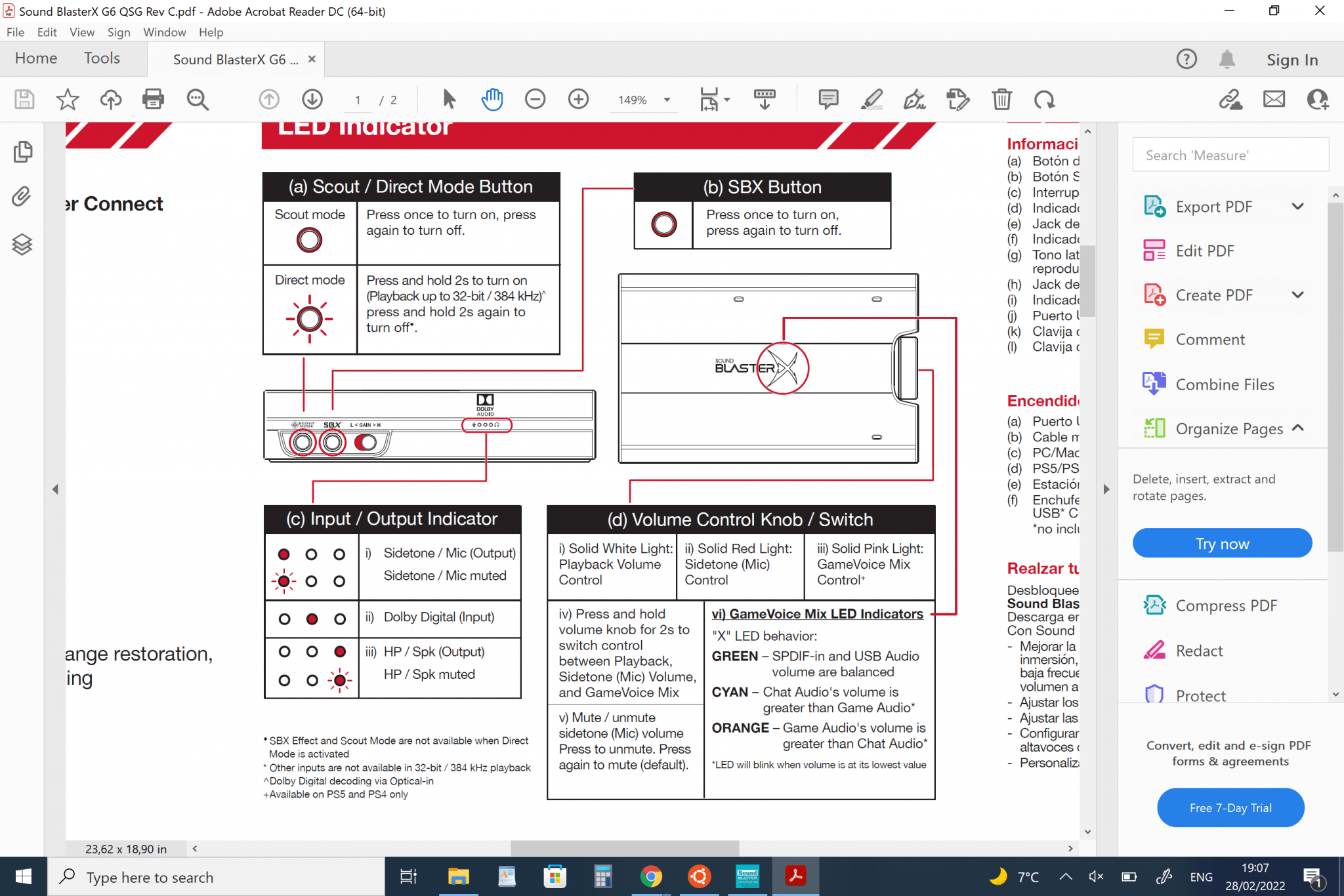

But now that you ask, the card is a sound blasterx G6. I wanted it to be taking a toslink signal to a pi running camilladsp and outputting the processed signal. I can do this successfullywith a different card, but with the G6 couldn't manage. And when i use a second card as toslink input, the G6 works as just a pass through (camilladsp shows the signal in and out but the processing doesn't occur).
MRamone: Last time your X-Fi HD digital in/out required using a different device (hw:ID,1). Did you use the same principle on G6? What does arecord -l say?
Yes, tried that as well, and plughw too, in case. The two cards are very different and show very different in alsamixer as well. Will post later what aplay says. Thanks!
the G6 has three functioning modes that you can switch via the windows app or physical buttons (direct, spdif direct or "normal"). These modes change the number of controls that are active in alsamixer, but the outcome of aplay -l and arecord -l is the same for all three modes:

While looking at the G6 user guide I do not see the switch https://manualzz.com/viewer_next/we.../056574260_1-400fd21446bbbb9568338f0cbf8401e4. Which one is it? Is SPDIF input available for capture? From the user guide I would understand the SPDIF input is muxed with the USB port but I may have gotten the features wrong, the guide seems rather misleading.
the physical switch to turn on the "direct mode" is one of the lateral buttons as indicated below:
the spdif as capture can be selected in the software (and the setting is stored in the card)
there might be a mode to mix the usb and spdif input, no idea, but i think the normal setting is just spdif without mixing
