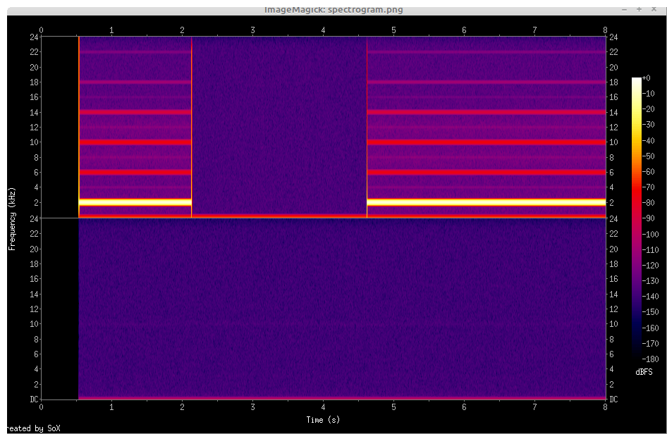

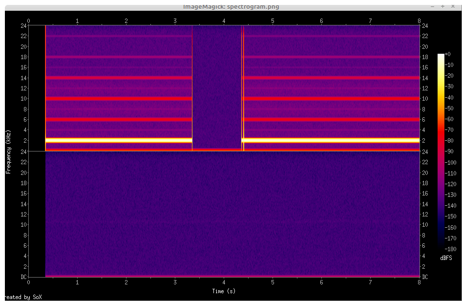

Henrik, I noticed one thing while testing to make sure that pause still worked ok. When I use VLC as the player and pause and then resume from pause there is often a glitch in the audio after play resumes. Camilla of course complains about an underrun since there's no way to tell it that it's a pause. Anyway I don't know if the glitches are a plugin problem or a Camilla problem. I don't see anything odd happening counter-wise in the plugin but that's not exactly exhaustive testing. It might be worth testing VLC with loopback instead of the plugin. VLC does not use poll so it's different than many audio players such as aplay. I don't think aplay has a pause function though.
This may be fixed with Henrik's version 1.1 which handles capture/playback stalls. At stall the outdated samples in the device buffer are cleared to avoid a glitch https://github.com/HEnquist/camilladsp/blob/next11/src/alsadevice.rs#L865 https://github.comand /HEnquist/camilladsp/blob/next11/src/alsadevice.rs#L542
Before - a glitch after resume caused by outdated samples is visible:
After restarting the device at stall:
