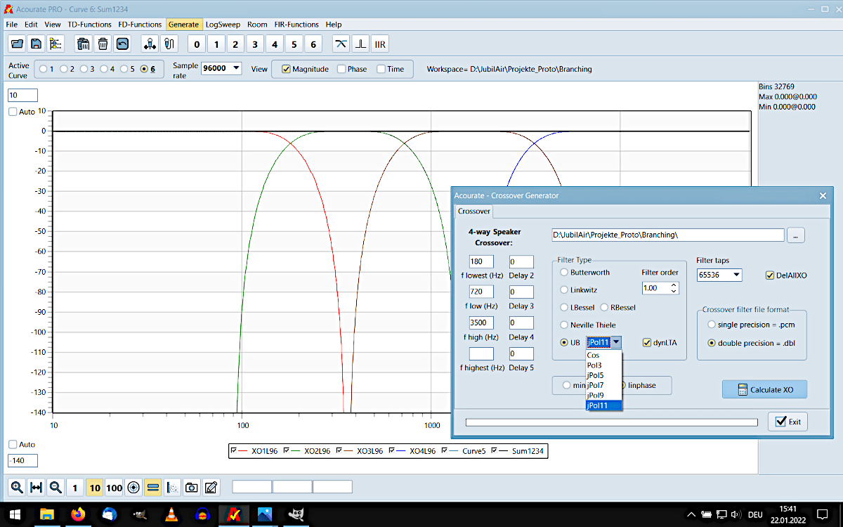

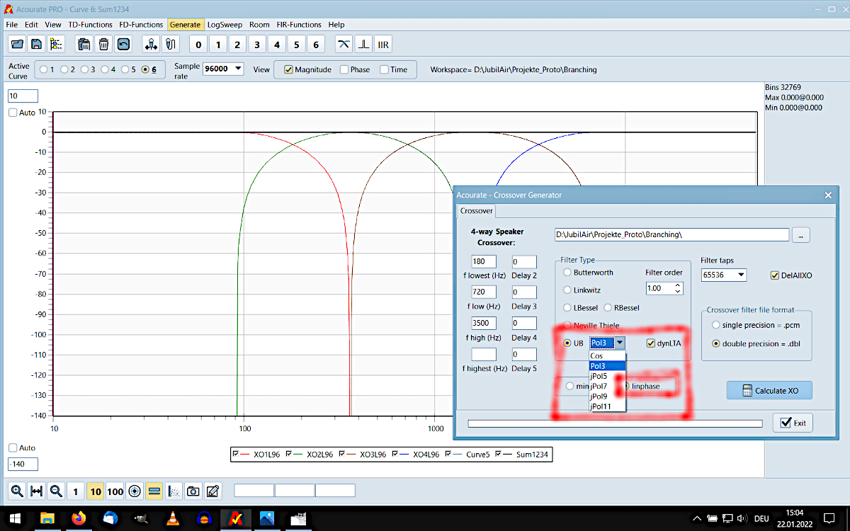

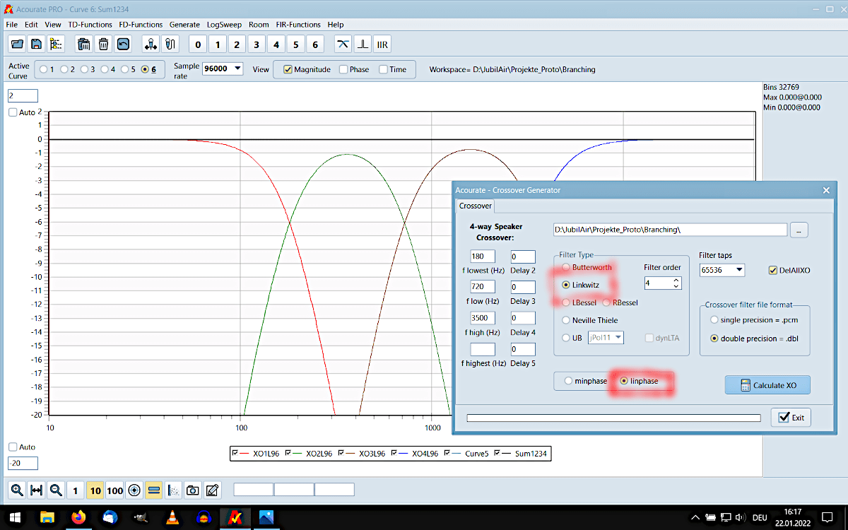

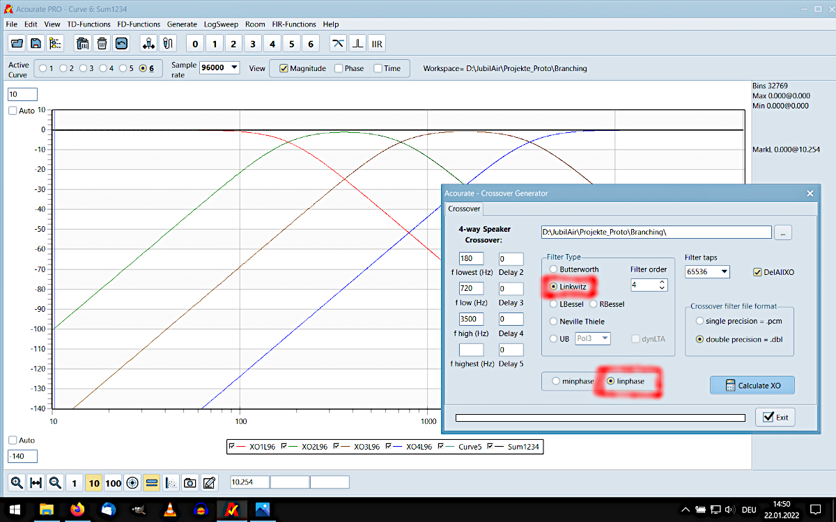

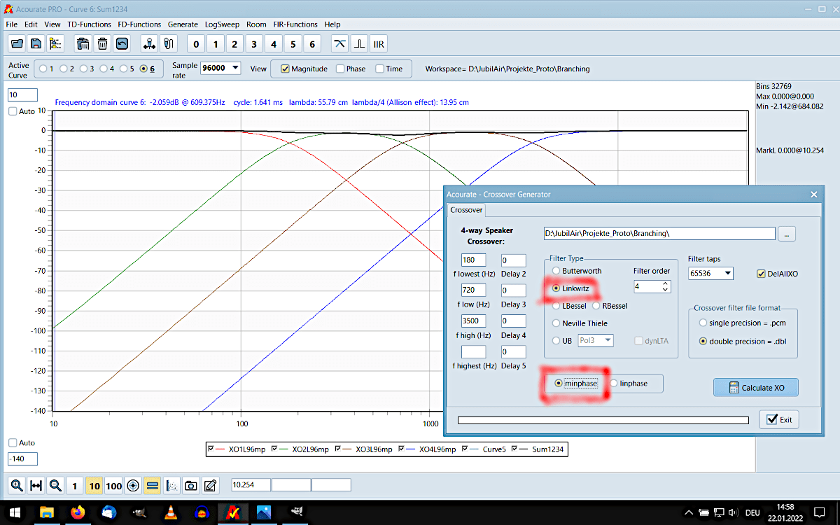

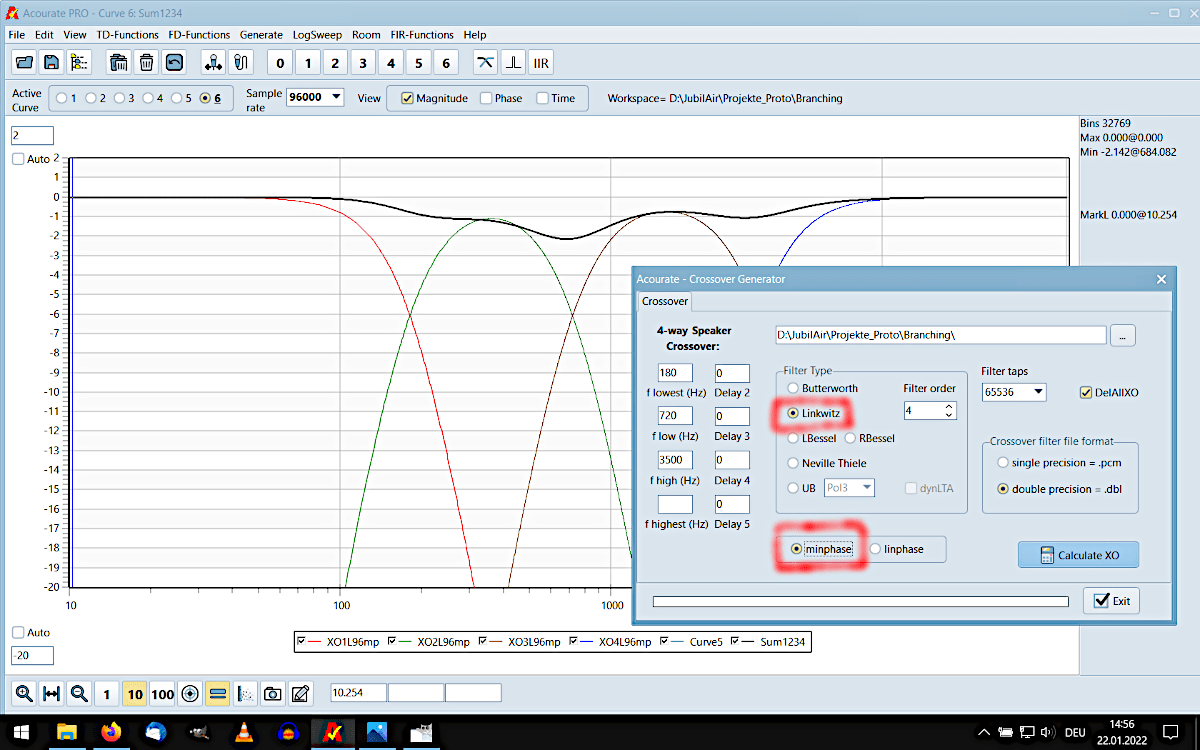

Take a FIR 4-way x-over LR4 filterset with -6dB points at 180Hz, 720Hz and 3500Hz. Let's go first minimum phase, as with a IIR or a standard linear discrete filter. As expected, the sum of all filters equals not at 0dB:
Same, but in a range from +10dB to -140dB:
Now take the same 4-way x-over LR4 filterset with -6dB points at 180Hz, 720Hz and 3500Hz, but computed instad as linear-phase filters. These linear phase filters add up to a neat ruler-flat result. No need for branching or other tricks.
And if there is a need for steeper filtering, along with a corresponding set of FIR filters, no need for cascading or so. You may e.g. instead resort to FIR Neville-Thiele filters, of to these newer types of optimized jerkless crossover filters by U.Brüggemann:
And for a steeper flavor of it:
Anyway round, either IIR or FIR - it's absolutely super that CamillaDSP offers both options.
IIR and FIR are complementary in theirs merits. In my oppinion though, instead of emulating minimum phase LR4's along with IIR and juggling around phase behavior and maybe also levels for a more or less even summation, better switch to linphase FIR's. Knowing that in doing so, there are also some potential drawbacks and caveat's. Such as some preringing and some small signal delay. And if you need a brickwall type of filtering, then go FIR NT or UB. As shown and as available.
