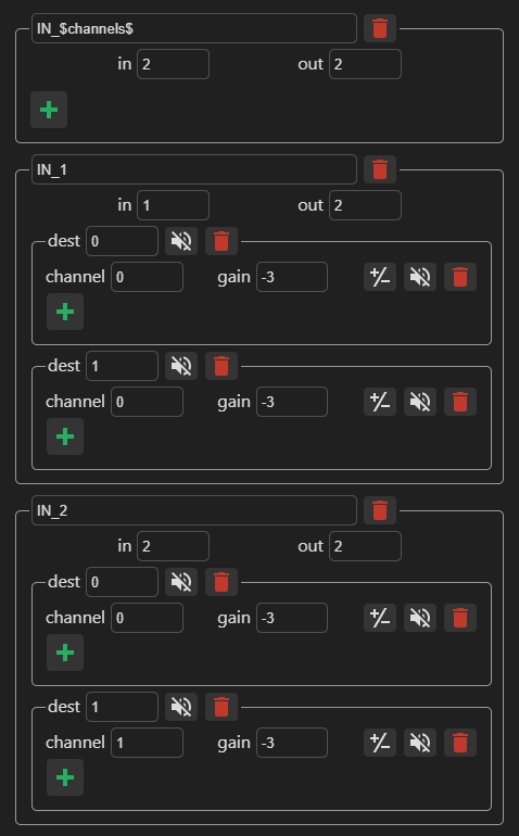

Thanks alot, it actually works in the GUI 🙂Ok, I don't think this will work in the gui, but if you edit the config file manually it should.
Make two mixers, one that converts mono to stereo, and one that just passes stereo on as stereo. Name them "monoswitch_1" and "monoswitch_2".
As the first step of the pipeline, add a mixer, and in the name field there enter "monoswitch_$channels$".
create the mixers in the pic and use the "IN_$channels$" at the beginning of your pipeline for everyone searching the same solution 🙂

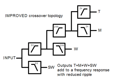

I think the referenced "benefits" are:Hi CharlieLaub
can you possibly point me to some literature that describes the benefits of branching filter ?

- any deltas/delays/phase (good or bad) imparted by the first stage are carried over to the second and third stages
- any deltas/delays/phase (good or bad) imparted by the second stage are carried over to the third stages
such that the 2nd and 3rd stages stay in "sync" with the first stage by using its established/altered "baseline".

If you look at a three way system the midrange's lowpass will introduce a phase shift that in absolute time units (aka group delay) will depend on the filter used (higher order filters will introduce more group delay) and it will also depend on the crossover frequency (lower crossover frequencies will introduce more group delay).
If you feed the highpass of the tweeter from the signal that is already lowpassed by the midgrange's lowpass then it's overall group delay will vary with that of the midrange, which IMO is desireable especially in the design phase of a loudspeaker where you will want to vary filter order and crossover frequency between woofer and midrange.
With DSP it is not strictly necessary to use this topology as you can introduce the needed delay for the tweeter in DSP very easily. But if you use this topolgy, as I tried to explain, once you have established the correct delay for the tweeter it will not have to be readjusted when changing the woofer/midrange crossover filter.
Hope that explanation attempt was somewhat clear 🙂

Yes, for a good overall step response you will have adjust the midrange's and the tweeter's individual delay in DSP anyways.
But once you dialed them in, you will NOT have to change the tweeter's delay if you change the woofer/midrange crossover freq/order when the tweeter also sees the changing group delay from this operation in the first place. both midrange and tweeter's group delay will change equally ("in sync") when changing the woofer/midrange crossover freq/order and the established delay relation between midrange and tweeter will not be messed up by changing something seemingly independent, the midrange's lowpass.
Hope that's more clear now.
EDIT: All of this applies to IIR filters that are not phase linear obviously. If you use linear phase FIR filters for your crossovers you will not have to worry about this problem.

Group delay of IIR crossover filters is frequency dependent, a basic delay can only match at one point. This may or may not be much of an issue but cascading the filters works by keeping the group consistent between branches.Oh, so groupdelay is the main thing here? wouldnt be manually added (and measured) delays not more accurate then, since it also accounts for the very last operation/filter added for each driver?

There is, kind of - it's called a bandpass filter. But why go through such trouble if simply splitting off the tweeter's signal from the highpass-filtered midrange signal and get the changing phaseshift of that branch for free?And if this is such a issue, why isnt there a "frequency-based" delay ?
There is it's called an allpass filter, flat frequency response but changing phase response. Have a google for Douglas Self's book "The Design of Active Crossovers" that is a good primer on filter basics as well as more complicated stuff.And if this is such a issue, why isnt there a "frequency-based" delay ? (or maybe like a controlled phaseshift through the whole frequency spectrum without changing amplitude to correct groupdelay/phaseshift of filters "completely") or is this just not possible?
