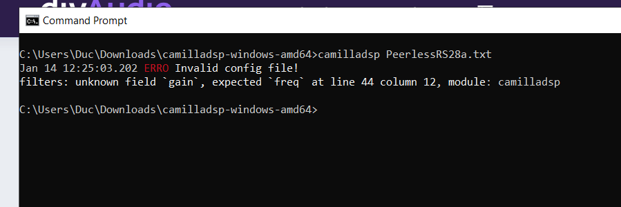

I got some syntax error. Can you guys help? I attach the config file and error message. I use v0.6.3 for windows 10. Thanks! Duc
  • PeerlessRS28a.txt
    PeerlessRS28a.txt
