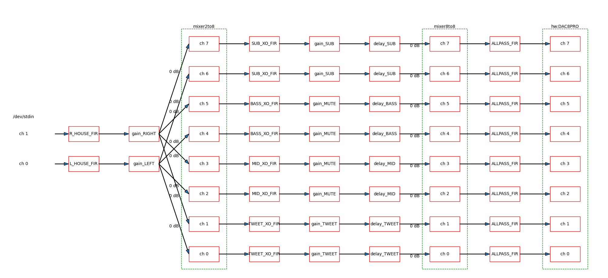

I am trying to do a multi-step pipeline using wav/FIR filters including XO and AllPass wav filters. I am noticing when I add the 3rd step (8to8 Mixer) using AllPass wav filters, the high end rolls off to @ 7kHz from 24kHz.
The Step[1-3] Topology is:
Stereo-2-channel (AllPass or HouseCurve) -> 2to8 Mixer (apply 8 XO FIRs) -> 8to8 Mixer (AllPass or TBD individual driver corrections)

The 8to8/AllPass mixer is a precursor to what is coming next. I am using the AllPass filters as place-holders to make sure I haven't adversely impacted anything before adding the specific driver correction filters next.
LOL, I haven't used this feature in a long time and ssh'd in to use the CLI. When I ran it the 1st time, I got a warning that more than 20 images were loaded and no images were written to the hard drive. I suppressed the warning in python and the reran it. Still no image files written to the hard drive. It then occurred to me it may be opening windows on the remote machine and sure enough, here it is.
The left channel propagates to all even channels.
The right channel propagates to all odd channels.
The topology is as expected.
The L_HOUSE_FIR and R_HOUSE_FIR's are both ALLPASS_FIRs (for the initial tests)
The ALLPASS_FIRs in the final step will hopefully be replaced with unique driver correction filters.
This is a test configuration to learn the tool and may change in its final incarnation.

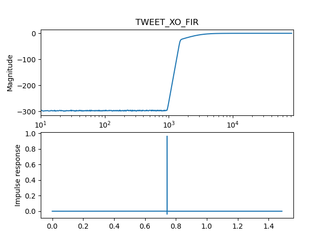

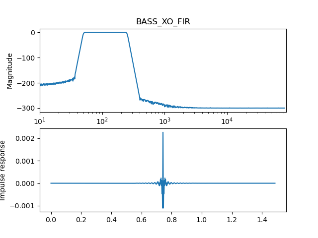

The map looks fine! Can you also post the plots for the individual filters?

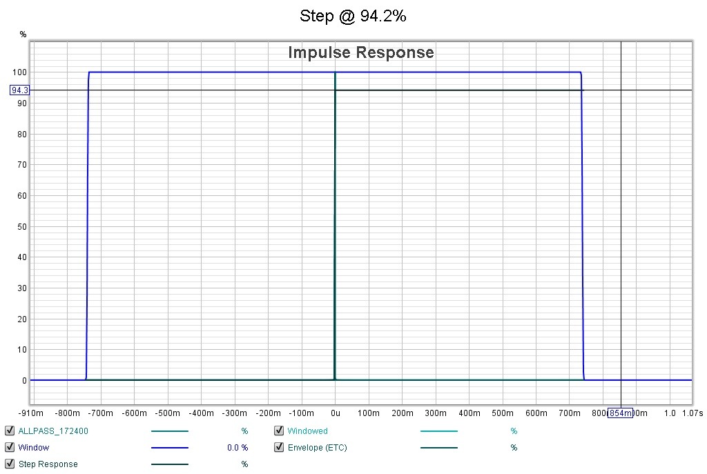

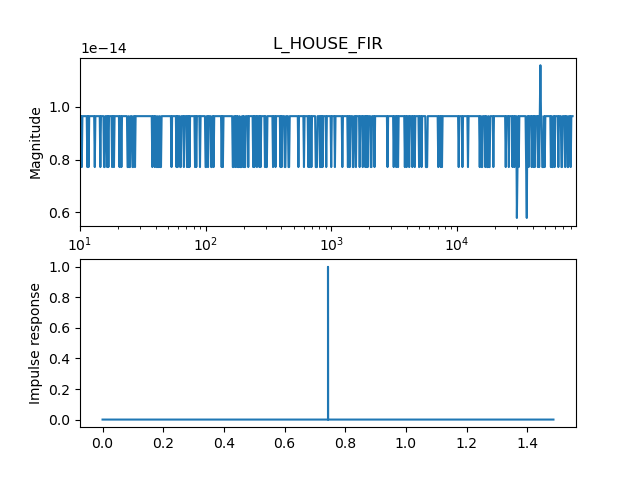

It looks like the ALLPASS (same as the current HouseFilter) filter maybe the culprit. It appears as a flat line in RePhase and in REW but not in the plot function. It was created in RePhase without any XO, frequency or phase settings enabled with the same file generation parameters as the XO filters (# taps, centering, windowing, sample rate, 64-bit float, etc.).

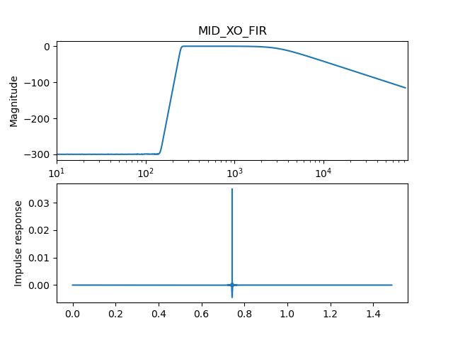

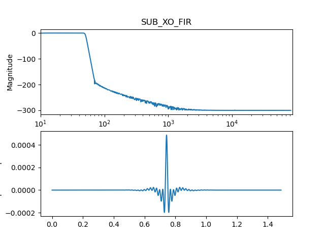

Sub 50Hz Low Pass
Bass [50-250]Hz Band Pass
Mid [250-3k]Hz Band Pass
Tweet 3kHz High Pass

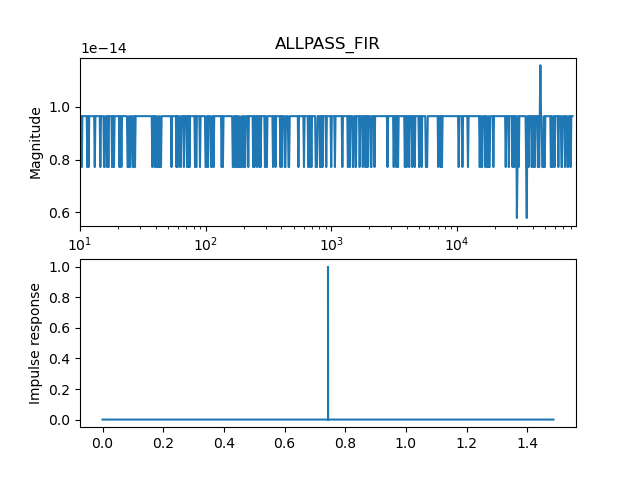

All Pass ???
All Pass ???
If I understand this correctly, the Step is @ 94.2% causing the high frequency rolloff to worsen the more times the "not-so-all-pass" is applied (e.g. not 1 x 1 = 1, but 0.942 x 0.942= 88.7% of max high frequency on 2nd application and 94.2% on first application). Need to figure out a way to make a "clean allpass" filter.
The allpass filter also looks fine. Look at the scale, each division is only 10^-14 dB! So the gain of that allpass is 0dB, with just a tiny (and completely insignificant) amount of numerical noise.

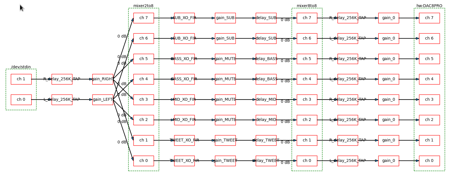

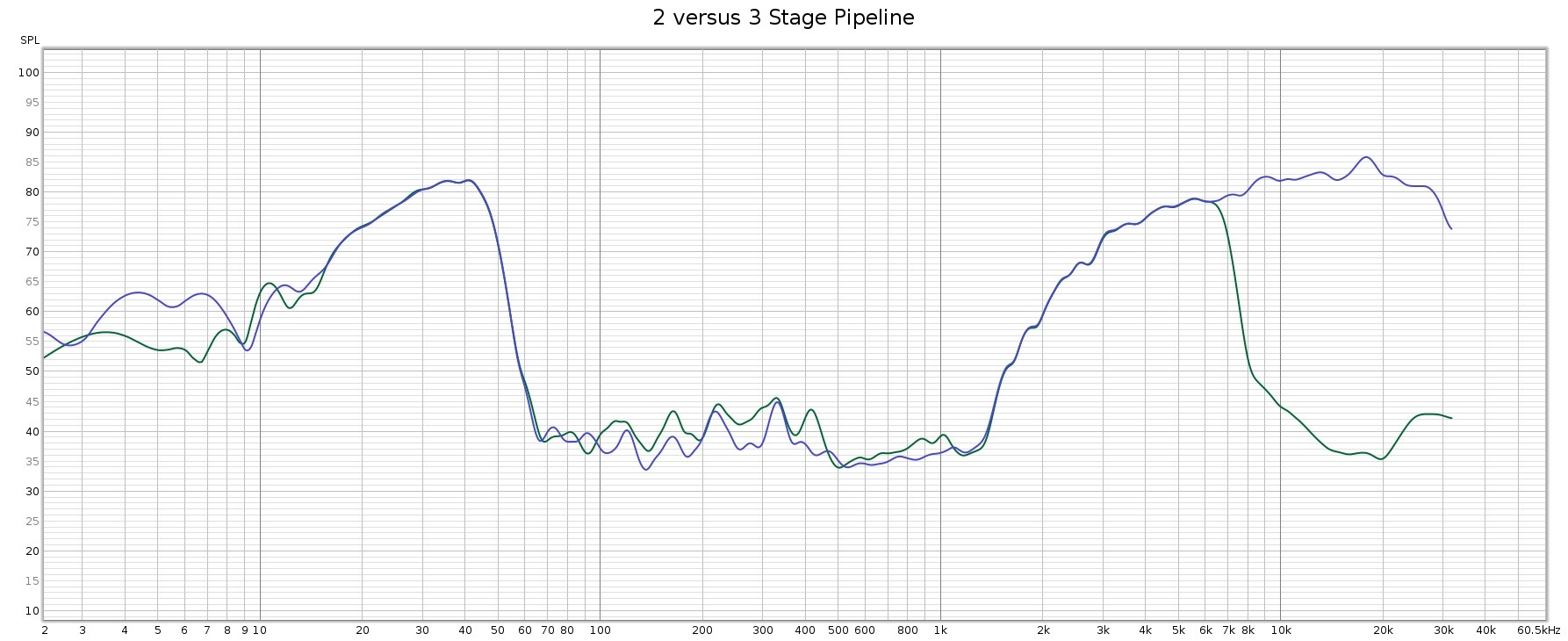

I just reworked the pipeline to use delays vs the AllPass FIR and get the same behavior so I must be doing something else wrong that I do not understand yet.
This (Sub/Tweeter) plot looks the same way (HF rolloff @ 7kHz) if I use delays or the ALLPASS FIR in the 3rd stage.
Blue - 2 Stage HF extension to over 20kHz
Green - 3 Stage HF rolloff @ 7kHz [ delay(743.039ms) or ALLPASS FIR (743.039ms) ]
Hmm then it seems more likely there is a problem with the measurement. How did you make the comparison graph, REW?
The rolloff looks so bad that it should be easy to hear it while running a sweep. Did you try just listening?
I agree that it is likely a measurement issue and likely the result of the additional delay that you are adding. I’ve observed similar issues when making measurements with REW using airplay (which adds delay). See thread below for more info.

FWIW, I just updated Alsa_cdsp to automatically calculate FIR duration from the specified playback samplerate and # of filter taps to populate a new $tap_delay_ms$ token assuming a delay takes less CPU cycles than an ALLPASS FIR.

What I could try is doubling the delay in stage one and omit stage 3 so I theoretically end up with the same total delay.

You guys are spot on !!!
I got rid of the 3rd step and varied the length of the delay in the 1st step. As the delay increased, the HF cutoff got worse until it cut off the entire tweeter as well as the aft timing chirp.
I went into Audacity, copied a bunch of silence from before the 1st timing chip and added it after the end of the aft timing chip in the generated sweep file increasing the trailing length by more than the delay.
Problem solved (or at least identified).
It appears the measurement sweep in REW needs more silence appended after the last gating timing chirp or something in the [aplay->alsa_cdsp->CamillaDSP] playback chain is truncating the end of the file playback equal to the aggregate delay length. It also explains the steep HF cutoff slope.
