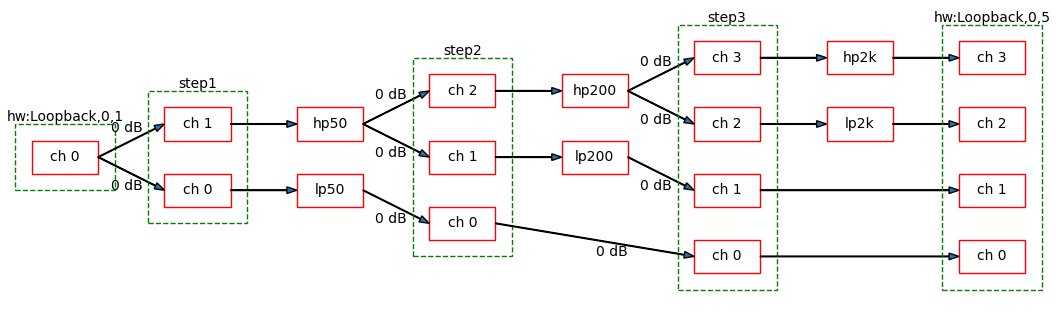

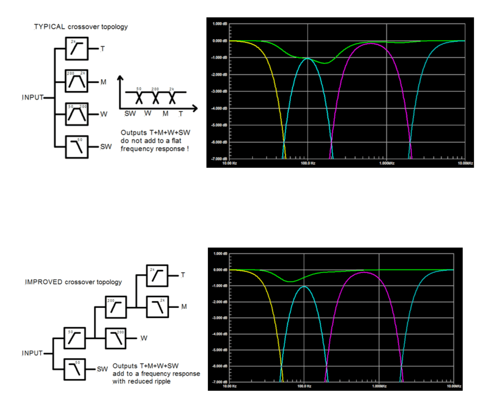

Is it possible and how difficult is to implement different filter topology configuration - something like tree branches, when an output from previous filter go into another channel? This was offered by Siegfried Linkwitz for his amazing LX521.4 speakers.
Here is an example and PDF with short explanation of benefits of this method 🙂
Do these typologies (Improved and Ramification) offer any benefits to linear phase XO's which supposedly sum flat by definition ?
TIA
No for linear phase filters there is no advantage.Do these typologies (Improved and Ramification) offer any benefits to linear phase XO's which supposedly sum flat by definition ?

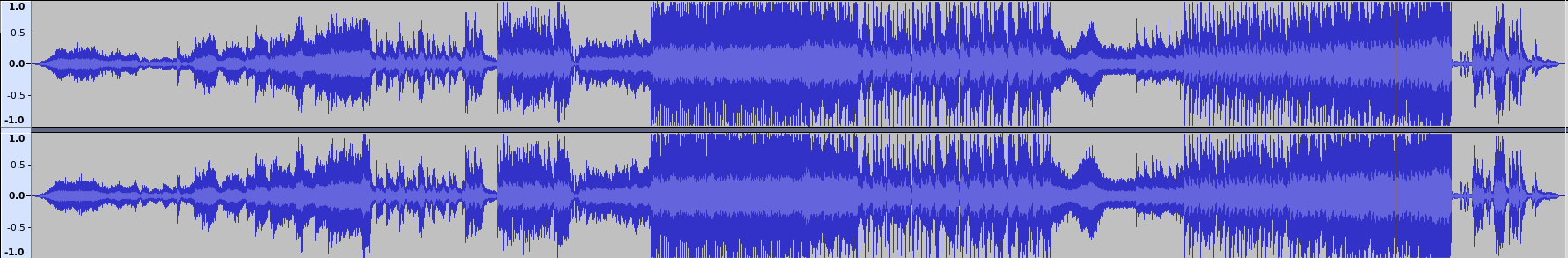

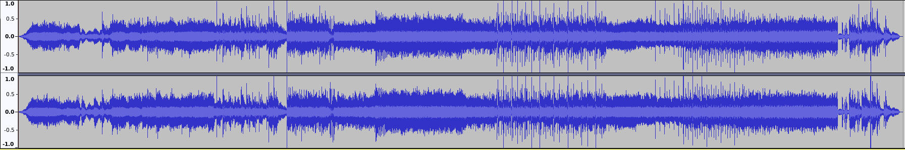

Here is a good illustation of what my prototype compressor can do. The track is Touch by Daft Punk.
Original:
Compressed with 25ms attack, 1s release, -25dB threshold, and a compression factor of 5.
The compression makes it a bit boring to listen to (as expected), but apart from being boring it sounds fine. This will work great for low volume TV watching etc.

The channels are always referenced by index. I built the improved topology to show:
