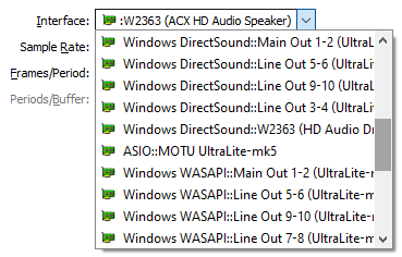

Well, the Jack / Jack2 was yet another rabbit hole 😉 The only documentation I could find regarding aggregating devices was this: https://jackaudio.org/faq/multiple_devices.html. And the only part potentially applicable to Windows (Use the JACK2 audio adapter) states "More information is needed on this option". Even the windows installer failed (had to manually register JackRouter.dll) so it is evident that this software is not focused on Windows and it mainly intended for pro av experts.Henris: Splitting the multiple channels to separate stereo devices is done by the Motu driver, IMO. In linux the device reports as a single multichannel device https://www.diyaudio.com/community/...overs-room-correction-etc.349818/post-6759897
Unfortunately the stock MS UAC2 driver will not handle your card correctly as it uses implicit feedback which the driver does not support.
An option would be connecting your card to RPi4 with linux/camillaDSP/USB audio+network gadget configuration, running the DSP on the RPi and presenting the combo to windows as a composite X-channel USB audio + network device for configuration. This option will be available, eventually.
But I did see something interesting in the Jack2 settings:
It is listing all the different interfaces (not devices?) and beside the split DirectSound and Wasapi items is a single ASIO "MOTU UltraLite-mk5" item. This item is not visible in Windows devices nor it is visible in the output of CDSP ListDevices. Could this be used with CDSP? I will try it anyways.
Since my end game will be a Linux based NUC running the CDSP, this might be the time to switch. It still was good to have the MK5 connected to a Windows machine since the device settings were available only through the Cuemix 5 software which afaik does not run on Linux. One in particular was pretty nasty; the main volume of the MK5 by default controls only the 1-2 channels and others are 0dB. Almost blew my compression drivers...
