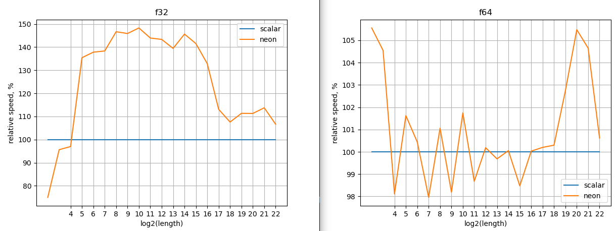

Rust just got experimental support for many more Neon instructions. That's exactly the stuff needed for adding Neon support to RustFFT! So I have done that, basically by translating the SSE code. It will take a little time before this is ready to be included in a RustFFT release, mostly because of the early state of the Rust Neon support. Even the current nightly release of the compiler is too old to build this!
The first results were a bit discouraging. It turns out that the Neon unit on the Cortex A72 of the RPi4 is quite slow. It only helps for 32-bit floats, while 64-bit runs at the same speed as without Neon. Here is a comparison for power-of-2 lengths:

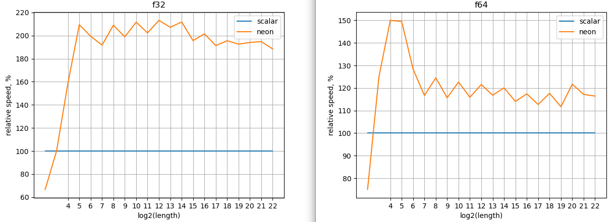

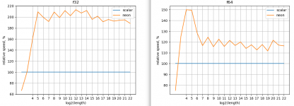

Switching to a more powerful CPU makes things look much better. This is the same benchmark from a Neoverse N1 on an Amazon EC2 virtual machine (similar to a Cortex A76):
Once the standard nightly compiler can be used, it would be great to run the benchmark on an Apple M1 too. Could someone here help out with that? The whole process only takes 15 minutes or so.
