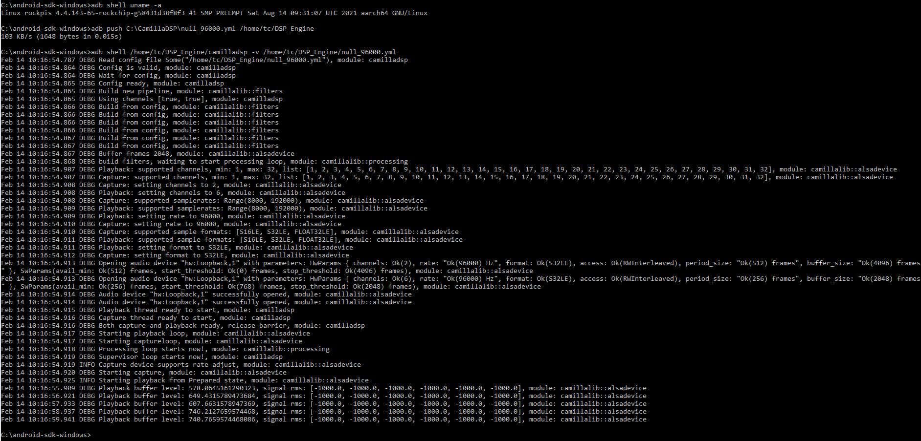

Could not resist to buy a 8 chanel I2S out ARM card from RADXA, Rock pi S.
I am totally a linux newbee so a lot of new stuff to learn.
Thanks @LykkeDK, used your GitHub - Lykkedk/SuperPlayer: Hacking software & scripts to play music for learning and starting point.
Disclaimer I have not put any I2S in or out of the card, so maybe it won't work at all.
First babystep is at least accomplised: Configure CamillaDSP 2 in, 6 out and get it to run on the Rock pi S
Enclose the CLI picture of uname and CamillaDSP -v
Hopefully I will get the time and energy to put a SPDIF to I2S and I2S to SPDIF gadget to se if there is actually any signal getting through with the standard DEBIAN configuration of the card.

Nice. The kernel is hopelessly outdated (an ancient android version), I would be surprised if the I2S worked flawlessly with it (though they may have backported many patches).
The latest kernel I was able to find for rock64 is GitHub - ayufan-rock64/linux-mainline-kernel at release-5.13 . Compared to RPi's 5.15 it's still behind. But maybe they have moved most of the patches to the mainline and no extra patches are required. But very unlikely, even RPi has still custom patches.
Thank's phofman. I will not try it with high hopes then.
I may be forces to connect the rock to internet and try to update the kernel to the version you refer to and maybe other things.

Unfortunatly or as expected you were right.
Could not just connect I2S in out and get sound through with channela 0,1 and 0,1,2,3,4,5
See there are 32 channels in/out. See if i can dig up any information of witch channel connects to the spesific physical input/output. (like I2S0_8CH_SDI0 or I2S0_8CH_SDO0)
Think i will need to learn more linux and installing extra software. Could not even start aplay....
Maybe some day I can be able to make or install an overlay.
It's likely the I2S output will not work out of the box, even if the kernel already fully supports the peripheral. RPi requires device-tree configuration, setting clocks etc.
