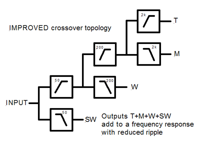

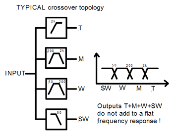

I have a couple of questions about CamillaDSP. Sorry if these have been covered in this thread already.
1. ROUTING
From the online docs I get the idea that the available routing consists of input > splitting/copying/adding channels > processing the channels > output. Depicted graphically, that might look something like this:
I couldn't quite figure out how a "branching" filter tree could be created, e.g. one like this:
Can the branching filter tree be created in CamillaDSP and if so, how?

Branching is no problem. You can add as many mixer and filter stages as you want in the pipeline. The only limitation here is that all channels have to pass through each mixer (but you can of course let some channels pass through unchanged).
To build the "IMPROVED crossover topology" you would add:
- a Mixer that splits INPUT to two new signals.
- a Filter stage, with the 50Hz HP+LP.
- a Mixer. This will split the >50Hz signal in two, and pass the SW through unchanged.
- a Filter stage, with the 200Hz HP+LP.
- a Mixer, splitting the >200Hz signal in two, while passing W and SW unchanged.
- A Filter stage with the 2k HP+LP
There is fractional delay yes. It's using an IIR filter for the subsample part.

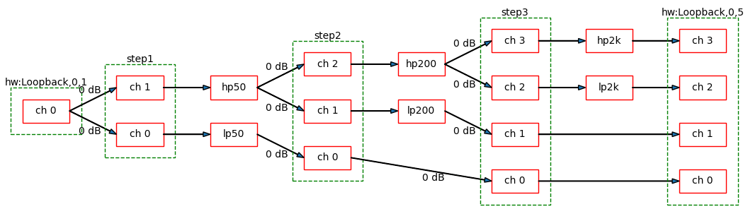

The channels are always referenced by index. I built the improved topology to show:
This is the config:

Code:
devices:
samplerate: 44100
chunksize: 1024
target_level: 512
adjust_period: 10
capture:
type: Alsa
channels: 1
device: "hw:Loopback,0,1"
format: S16LE
playback:
type: Alsa
channels: 4
device: "hw:Loopback,0,5"
format: S32LE
filters:
lp50:
type: Biquad
parameters:
type: Lowpass
freq: 50
q: 0.7
hp50:
type: Biquad
parameters:
type: Highpass
freq: 50
q: 0.7
lp200:
type: Biquad
parameters:
type: Lowpass
freq: 200
q: 0.7
hp200:
type: Biquad
parameters:
type: Highpass
freq: 200
q: 0.7
lp2k:
type: Biquad
parameters:
type: Lowpass
freq: 2000
q: 0.7
hp2k:
type: Biquad
parameters:
type: Highpass
freq: 2000
q: 0.7
mixers:
step1:
channels:
in: 1
out: 2
mapping:
- dest: 0
sources:
- channel: 0
gain: 0
inverted: false
- dest: 1
sources:
- channel: 0
gain: 0
inverted: false
step2:
channels:
in: 2
out: 3
mapping:
- dest: 0
sources:
- channel: 0
gain: 0
inverted: false
- dest: 1
sources:
- channel: 1
gain: 0
inverted: false
- dest: 2
sources:
- channel: 1
gain: 0
inverted: false
step3:
channels:
in: 3
out: 4
mapping:
- dest: 0
sources:
- channel: 0
gain: 0
inverted: false
- dest: 1
sources:
- channel: 1
gain: 0
inverted: false
- dest: 2
sources:
- channel: 2
gain: 0
inverted: false
- dest: 3
sources:
- channel: 2
gain: 0
inverted: false
pipeline:
- type: Mixer
- type: Filter
channel: 0
names:
- lp50
- type: Filter
channel: 1
names:
- hp50
- type: Mixer
- type: Filter
channel: 1
names:
- lp200
- type: Filter
channel: 2
names:
- hp200
- type: Mixer
- type: Filter
channel: 2
names:
- lp2k
- type: Filter
channel: 3
names:
- hp2k
