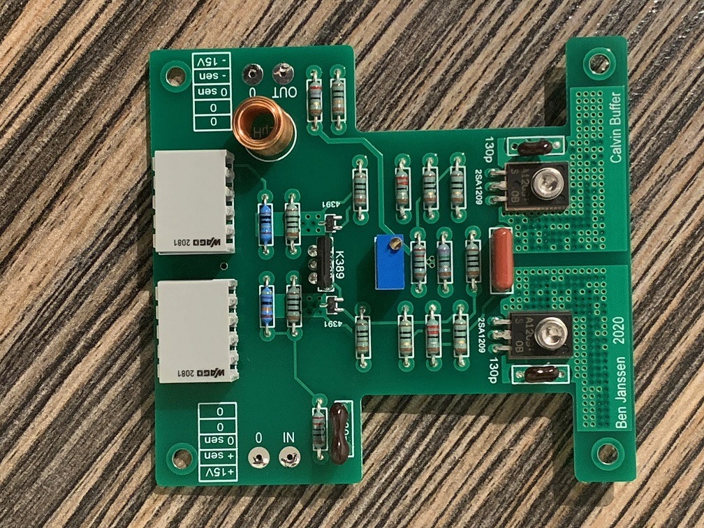

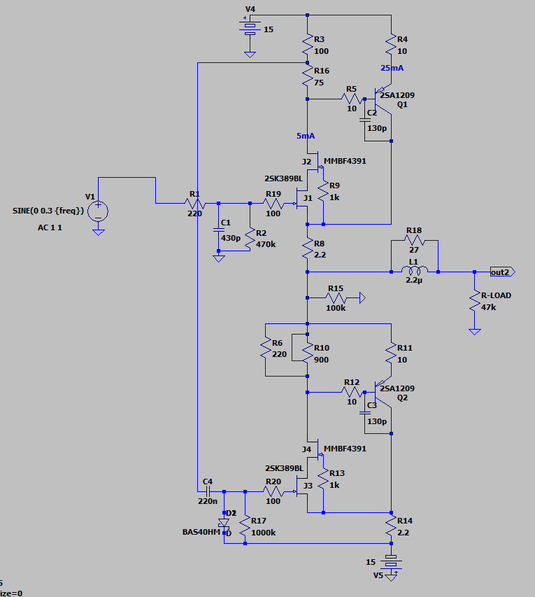

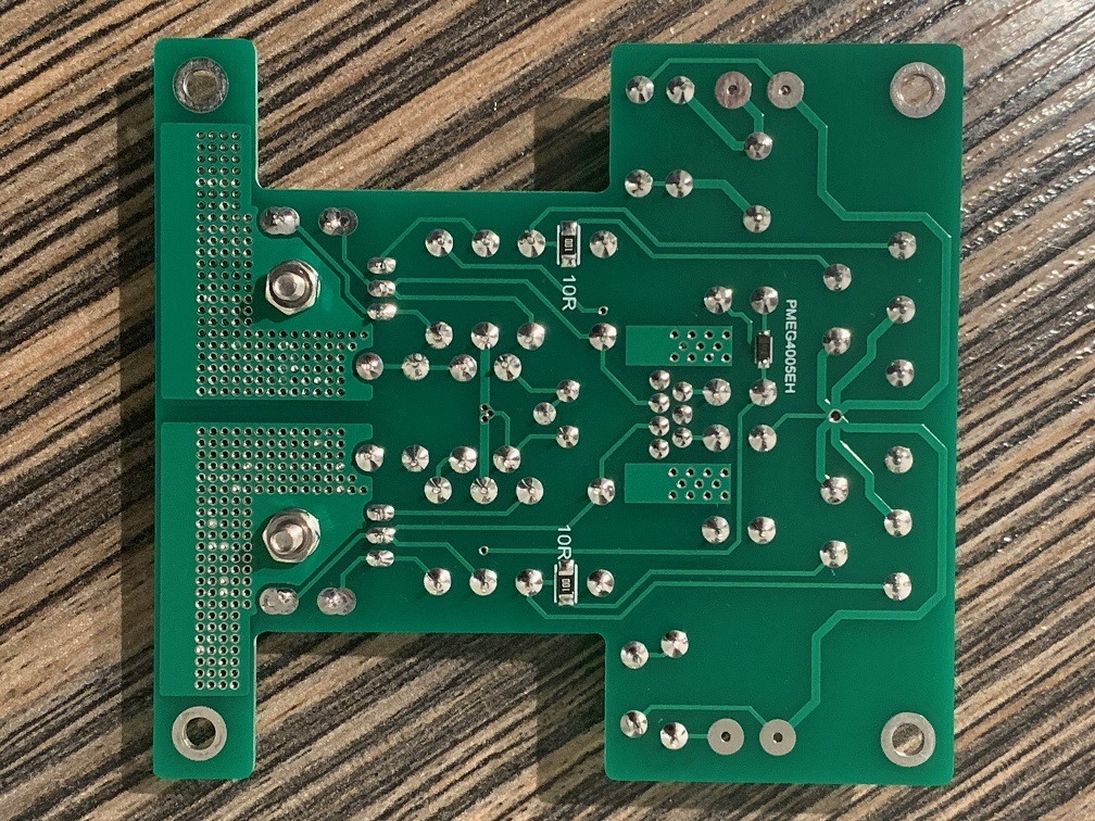

Here is my as-build circuit and PCB's.
I just checked the 100Khz before the coil. Scope plot is 100% identical as in the scope plots I posted before (measured after the coil).

Thank you very much for all this useful information, it is very helpful.
The main difference differences I can see are:
1) cascoding of the input devices
tried and didn't make any difference with regard to the undershoot.
2) Diode on the low side.
I am trying to understand the reason for it, but to me, it seems it provides a fast discharging path for the bootstrap on negative slope signals and basically clamping at -15V basically. I wonder if that is the culprit, I am curious to try to add the diode.
3) Limiting BW at the input.
I wonder if this prevents the undershoot by slowing down the input. I will try this as well.
4) You use 15V while I am using 24V for the rail. While this should only change the stability point, I don't recall seeing any difference on the undershoot but I can try.
I will try 2 and 3 and report my findings.
Just to update on this topic and sorry for not posting earlier. I wanted to clarify that if I take the buffer out of the feedback loop, I have the same results as anybody else. Square wave response is good.
The problem starts when the buffer is inserted inside the feedback loop. I have dug into this and the simulation also predicts this when closed in the loop. A simple pole compensation across the feedback loop proves to work and shape properly the response in the simulation.
Unfortunately, in practice, when I put a cap across the feedback resistor, the circuit oscillates.
Anyway, regardless of this, I wanted to close the topic on the buffer so that if anybody will read this in the future it can have a full picture.
