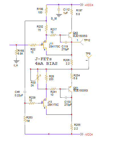

@ stefanoo, usually the calvin buffer is well-behaved and I had it up and running easily in several other projects as well, without this problem. I may still have my prototype somewhere, and will try if I can make it do the same thing when I limit the startup current...... Not sure when I will get to that.....
As promised, I have breadboarded the circuit tonight to have more easy access to implement changes.
I think have found the reason as to why the buffer has this behavior and, IF the following is correct, then my guess would be that all bufffers have this behavior, but, I would be extremely interested, when you get a chance, to kindly doublecheck and see if you have different findings.
After some more thinking, I came to the conclusion that the AC bootstrap capacitor C46, which couples the bottom part of the buffer to the top side, is rather large and charges at start up, which introduces a delay that can bring the buffer in a temporary wrong biasing state like the one I am experiencing.
Obviously, for proper operation AC operation and stability, the capacitor is needed, but I started wondering, if the value coulf be reduced and of, by reducing its value, also the inrush current decreases.
Since the way I understand this buffer, the small AC signal coupled from the bottom to the top is effective at higher frequency, the value could potentially be reduced without decreasing the frequency response, but perhaps the stability point might change,
Therefore. I proceeded to reduce the capacitor from 0.22uF (value used all applications I have seen around) down to 10nF.
While frequency response seems unaffected, the inrush current has resolved. As I had feared a bit, the stability has changed and I can see some minor ringing on the edge of the square wave depending on the grounding on my probe, which means the circuit is a bit more prone to oscillations, but overall, it seems stable.
My question is directed to you and to the folks who knows more inside-out this buffer: have I introduced any problem I am not aware of by lowering the cap value?
The reason for the coupling between the two halves, with C46, is to further improve the distortion behaviour. In fact, the midpoint of the resistors R198 and R202 is chosen to maximize symmetry between the halves, and cancel out the differences. So you could simply remove it and would end up with the same function, at slightly higher distortion. Some versions of the Calvin buffer even had a trimpot there, but - unless you have a rather perfect input sine wave and a really good distortion measurement - you will be hard-pressed to improve by adjusting (I tried). Best to simulate the optimum point and match the components, I think.
Assuming J13 does not forward-bias on the gate, there will be no other current to charge C46 except through the 1M resistor. This gives a corner frequency of ~0.7Hz. No huge need for distortion reduction at that frequency 😀 At 10nF , this would be 16Hz, should be no issue at all. Hope this helps!

Thank you very, very much, this makes total sense and confirms what I see on the bench as well.
Yes, I could make precision distortion measurements, but I don't think it's worth the while. I would go for the standard 100/75 as per the schematic and lower the cap maybe to something like 10-22nF to have quick turn on.
I am assuming you are using the 0.22uF bootstrap cap, for all your implementations therefore, when of course you indeed will have a chance to run this test, please observe the following two things:
1) Inrush current on the negative rail
2) Once the rails have reached the rail voltage, observe the bias current at the output going from a higher value, down to the target after few seconds.

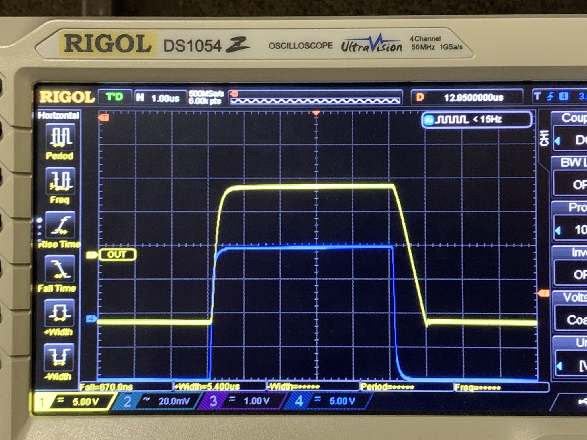

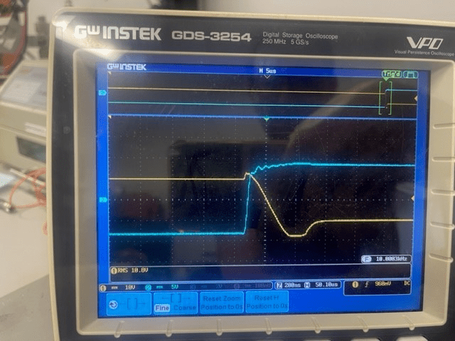

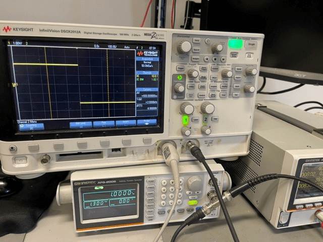

Just to update on this topic. Despite having resolved the startup condition by lowering the bootstrap capacitor, I am analyzing the response of the buffer and I find something quite concerning to me.
In the picture, it can be seen the blue trace rise step and in yellow the fall step. While the rise is fast and very sharp, the fall is not. No matter the compensation caps, I was unable to substantially improve the behavior. I am suspecting the flattening behavior on the fall trace here, might be an artifact of the limiting sampling, I might double check the behavior with the 350MHz Tek analog scope.
Also to show the signal generator fall behavior, below, yellow trace is the same as above (output of the buffer) while in blue is the signal generator. This can help assess the behavior of the fuffer.
Last, I don't have a scope shot to post here, but If I feed the input with a 3MHz or more sine, the output starts distorting/sagging greatly.
I am wondering the following things, if you can point me out I would great appreciate it:

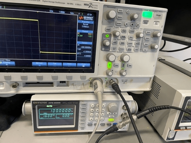

Hi Hesener,
Yes, you are correct, BW is greater than 5MHz (here I am using the 5MHz GwInstek signal gen, I will use my other 50MHz Tek generator to establish the exact bandwidth I suspect it is roughly 7-).
You are also correct with the fact that rising and falling edges are depending on grounding and capacitance of probe and anything else connected, so those behaviors have to be taken with a grain of salt.
However, it seems consistent i.e. not an artifact, to see an increasing falling undershoot as the input/output signal grows.

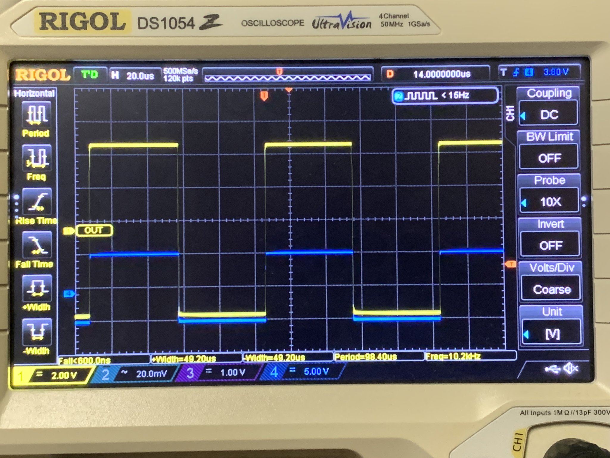

As it can see, the transient response at 4.5Vpp level is "perfect"

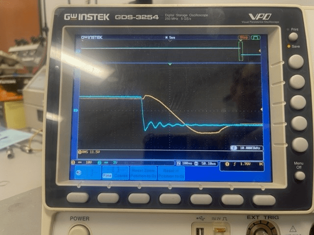

However, as the voltage increases over 5Vpp, the undershoot starts becoming obvious:
I haven't taken pictures, but as the voltage keeps increasing the undershoot will dramatically grow. I tried everything to get rid of this behavior but without any success. I also, have tried the unmodulated configuration, but the behavior doesn't change,
The scope shot from @Joachim Gerhard shows roughly 20Vpp, however in my measurements, this phenomenon shows up much earlier, and I am not sure why this large discrepancy. In my case the supply is +/-24V, 25-30mA biasing and no load at the output.
While in any practical use, signals don't have this transient and driving a power amp, depending on sensitivity, but average, 2-3VRMS will usually equal to max output power, still from an ideal technical perspective, we would like to see a perfect square wave at least 50-60% of the rail.

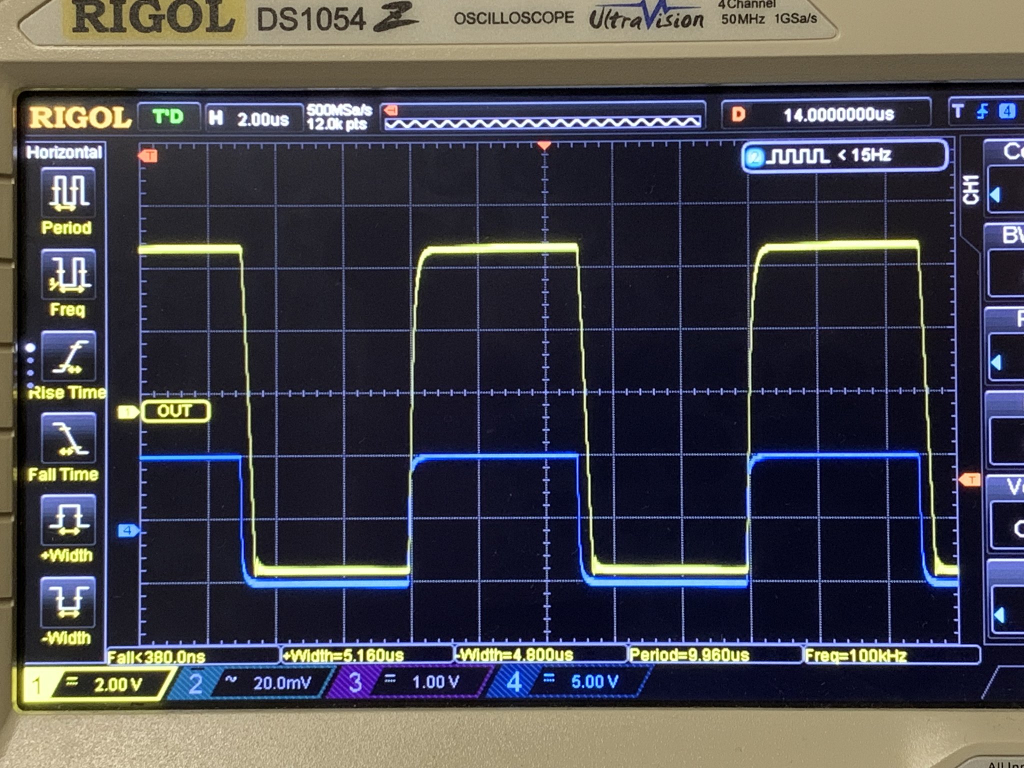

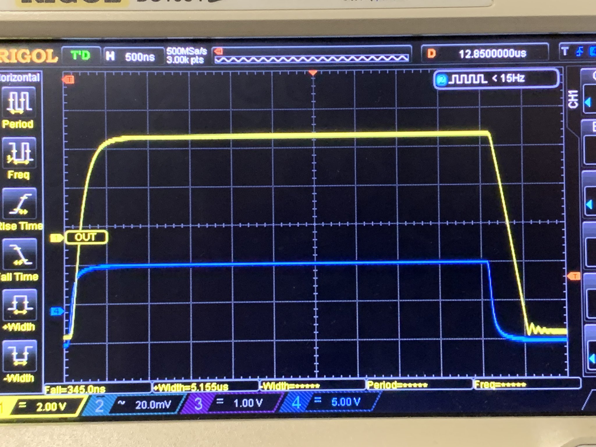

Hello Stefanoo, as requested per PM. Please find measurements below.
Load is 47K metalfilm.
I see similar findings as you at 100Khz. Remember, we are talking audio here 😉
Bensen,
First of all, I want to thank you for taking the time to measure this for me. I do appreciate it very much!!
In reviewing your results, I can see some significant differences with mine:
1) the total gain of your circuit is much higher than in mine (I have 11dB gain).
Do you have the buffer in a closed loop with the VAS /Input stage or is it outside of the loop?
2) your fall time is about 1us, which is much slower than in my case (I have around 200-250ns fall time), but to be expected given you have a much higher gain.
Do you have zobel network at the output? If so, do you know how is the response before the filter?
3) very important, in your case, you have the undershoot at a very high voltage output, in my case, this happens at 2-3Vpp while in your case at 20Vpp which is significantly better.
What rail voltage and output bias do you have for the buffer? I have +/-24V 30mA.
I will take scope shots at higher output level to render the issue I am facing clearer.
Would you mind sharing the devices/values you are using in the buffer and what compensation cap values you have installed?
Thank you.
