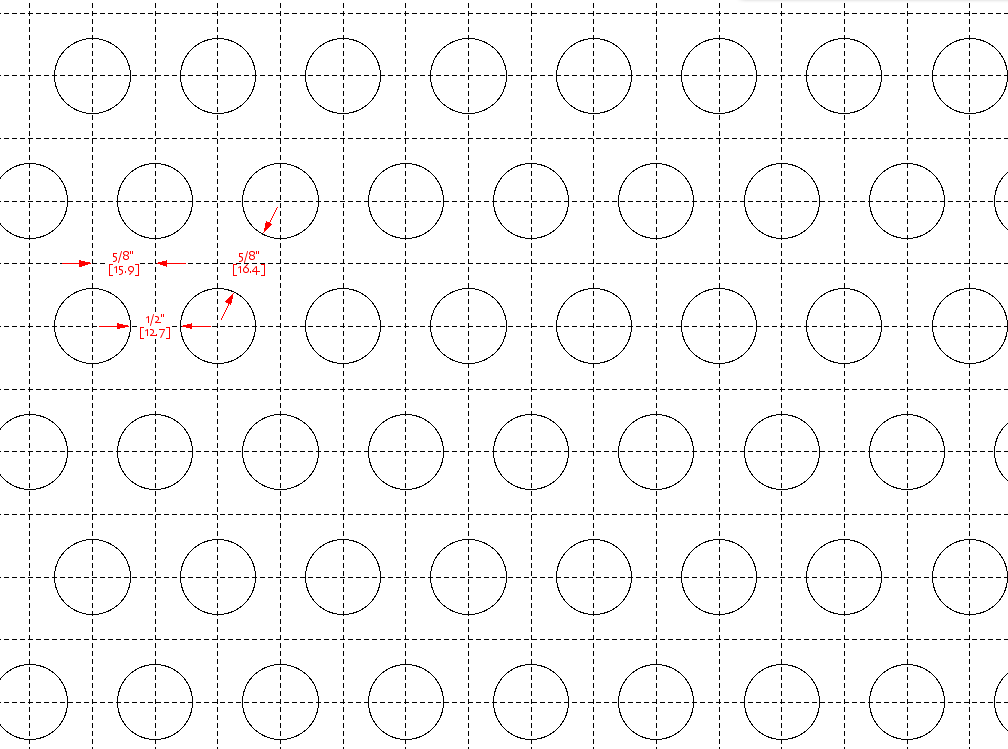

OK so if the 3/4" hole (same as baffle) is the right size and I follow Dave's suggestion of a 3:5 spacing ratio, that's 44 0.75" holes. That's gonna take up a big part of that triangle.

Those 44 3/4" holes will give you a surface area of about 19.5 sq. in. About 25% of the driver Sd. Surprising, isn't it?

Oops. I forgot the R part of PR^2. Each hole is .44 in^2. The cone is about 78 if you subtract the spider around the horn. I'm gonna wear out my speed bit. 😀
Actually I might just try a few less knowing I can add more as needed. So, to be clear on my extrapolation, a 3/4 hole on a 1 1/4" grid means there is 1/2" between them?

I like Dave's hole diagram. Very soothing to look at, for some reason.

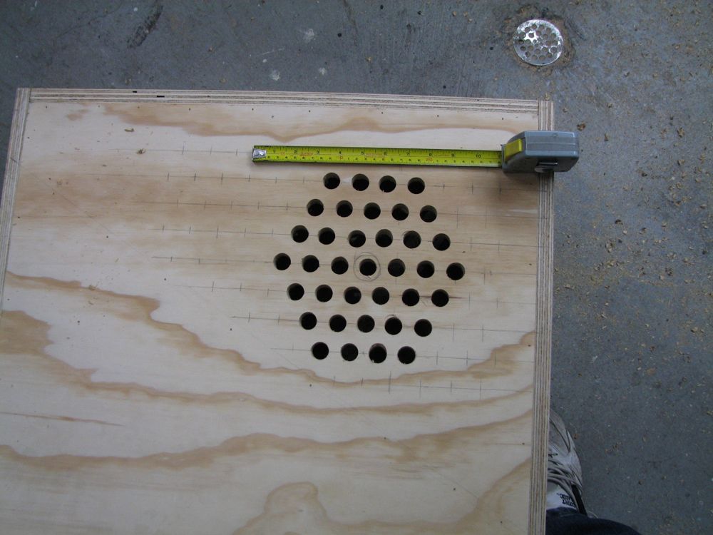

Looking Good !
Hey Cal it's looking good, starting to come together don't you just love when a plan comes together. 😀
Great Job ! Looking forward to your observations !
Splits are on the other side, and I saw one from here 😛

Seriously, they look good. And I'm wondering, what if overlaying another perforated board on this one (by a gap)?
Better damping (higher loss)? Or that's not necessary since the damping material inside will do the job.
