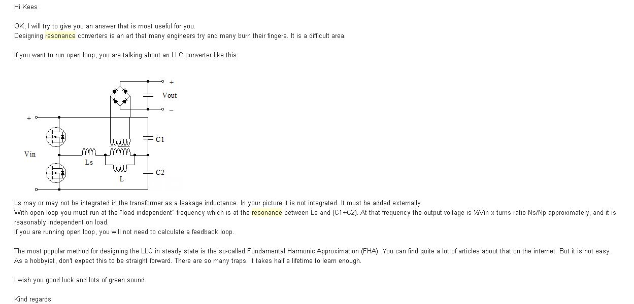

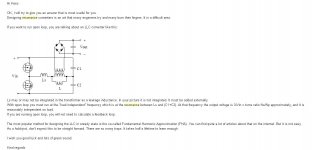

I have read some papers where it is explaned quite good, and have mail one of the people behind who have also give a anwer about how to proceed.
As what people here said, just it is that resonant and smps in special cases, it is not that simple and potential dangerous.

This was his opinion to prove how complicated this can be, in sense of savety and good working. And he has experience with design, it is complicated resonant system, repeat designs is even difficult.
In fact when now,it is quite easy to understand, like it is a antenna 50 ohms on a transmitter the Q does set bandwidth.

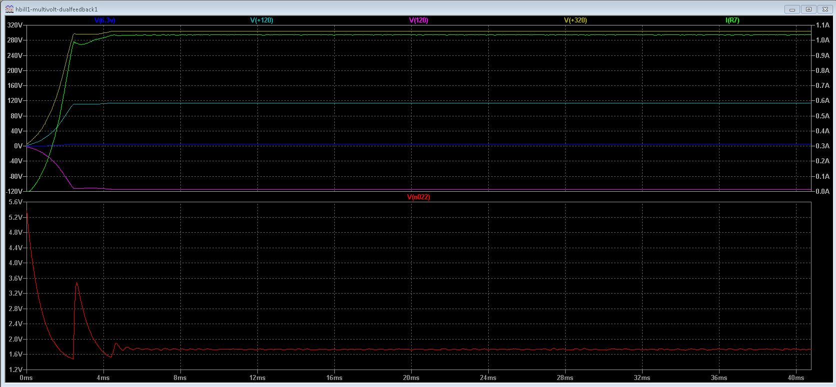

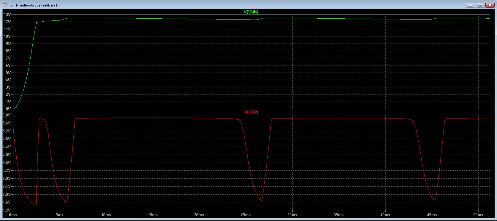

This sim did all oke, burst mode does work keeping no load stable. PIC 1 is unloaded and PIC 2 is loaded converter with all voltages. For 12.6volts and 6.3 volts I do need to split the coil what is in feedback, I do tap it from the 12,6 volt so it is also stable, how to that best way?

I have need this feedback when feed tubes, the filament voltage needs to be good and stable, I need audio from it and not use it as a light bulb.

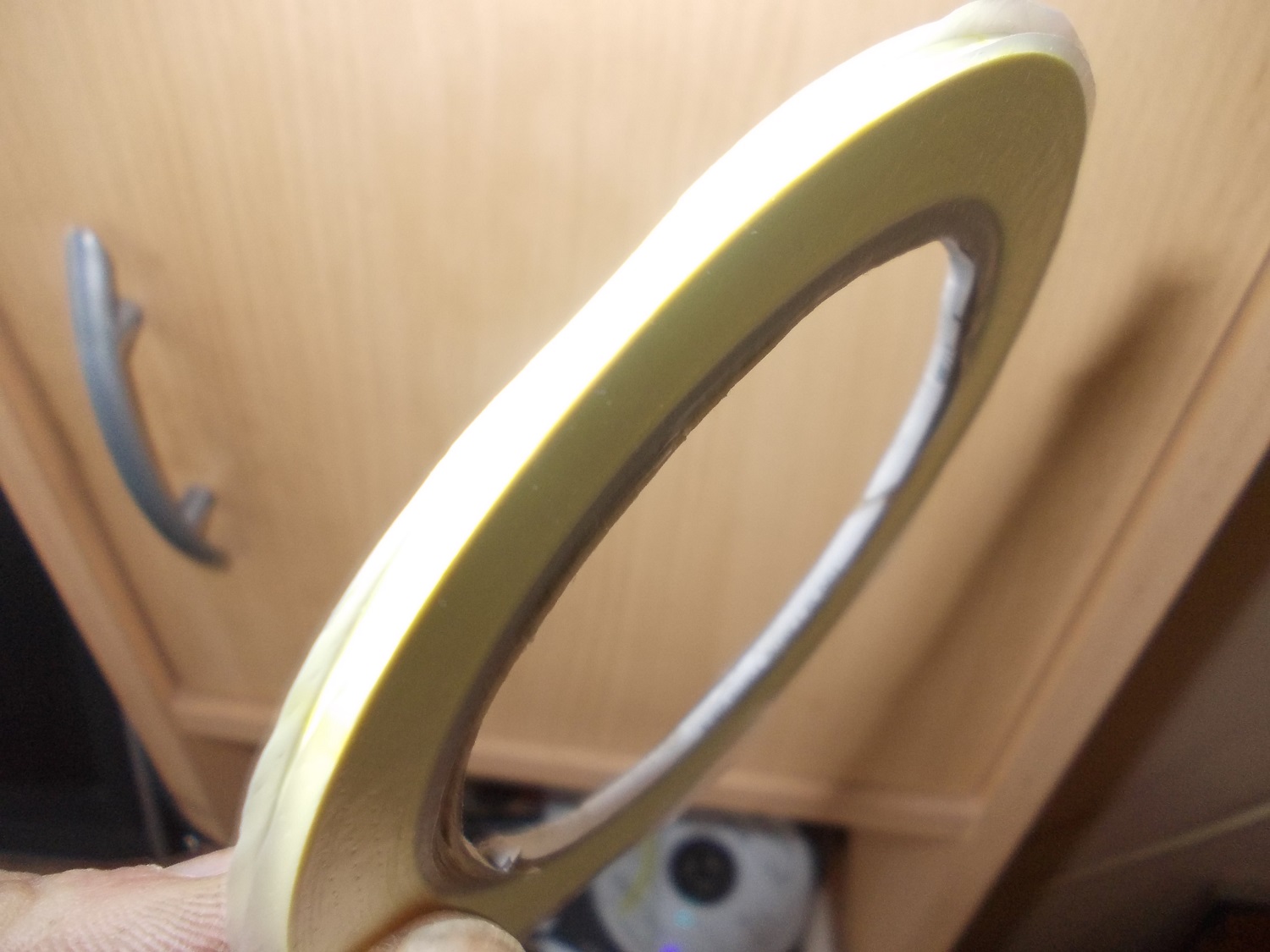

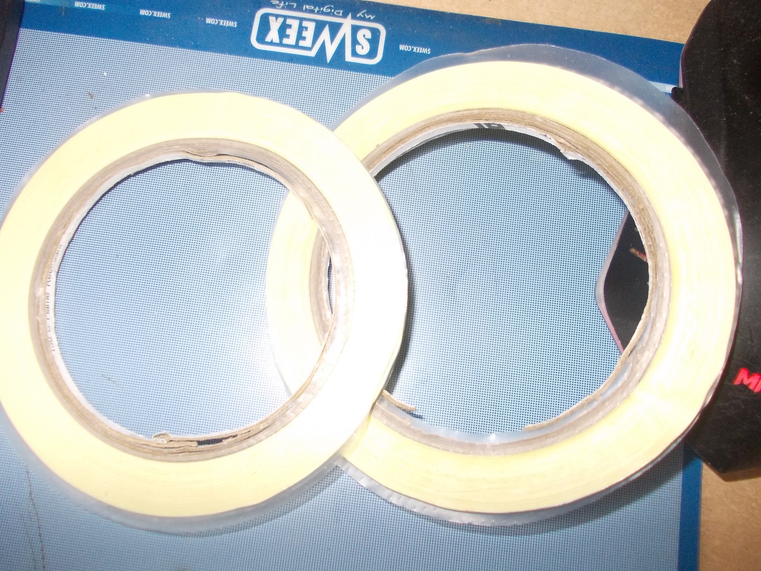

well I have not get in tape for the slotted bobine, mosfet driver ic,s L6599, ncp1395, first has all in it no need for drive transformer or ic for the mosfets,

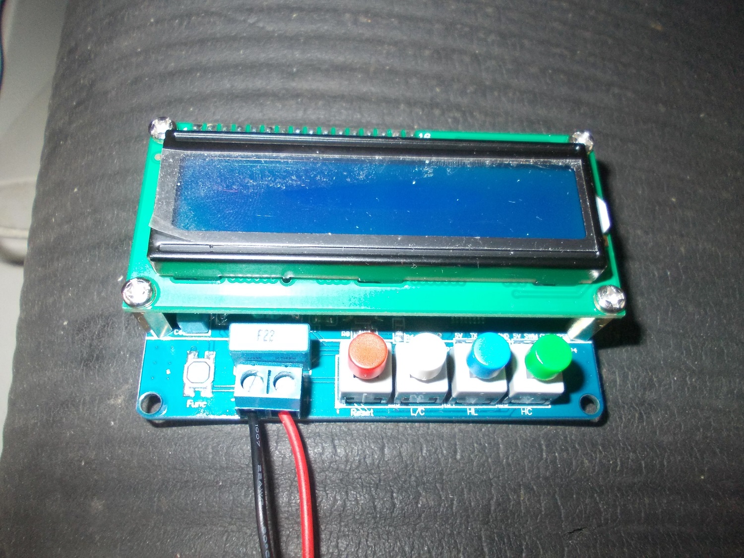

Hi All
I have ordered this counter for measuring inductances and caps. unfortanely it did not work on induction, the LM311 oscillator does not oscillate, only elco,s I can measure and this are oke with precision.
I did need this to wind the resonant transformer, now I did already mail a week with that chinese supplyer without a solution.
I have measure the LM311 circuit, it is complete oke and has to oscillate, so, I think the LM is not really a LM311 but fakes or such who is soldered in by the company who make this meter.
So I think to build one myselfs with a PIC, I have all the stuff for it.
Maybe simeone here has also this experience? Why can china doe not make working stuff, ripping people off.
