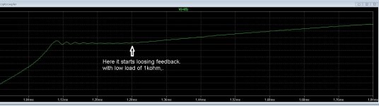

I have done the resonance in sim, but I have a strange problem, when I do set it on very low load, the feedback does run out to max voltages, en without a upgoing frequency, it looks like the output caps does this as it is a lowpass filter on almost dc.
Do you have a kind of idea about this?
thanks

Most SMPS's need a minimum load to maintain the inductors running in the continuous current mode, except those specifically designed to run dry. Now, I know that resonant and quasi resonant need some small capacitances added to the tank to limit the maximum resonant frequency, where drivers and MOSFET's becomes more inefficient.
I think for audio, we need just to use open loop supply, feedback here does more harm then good, I can use lineair regulators for the tube filaments., just make the smps such that I have al voltages needed or maybe get used later.
For audio we need no feedback as people say here, but for me it was a learn fase to do implement it, but can easy be disconnected later.
I get good regulation when I have 5 amps minimum, I think also the vco from ltspice has a to low action on voltage, but maybe I do something wrong here.

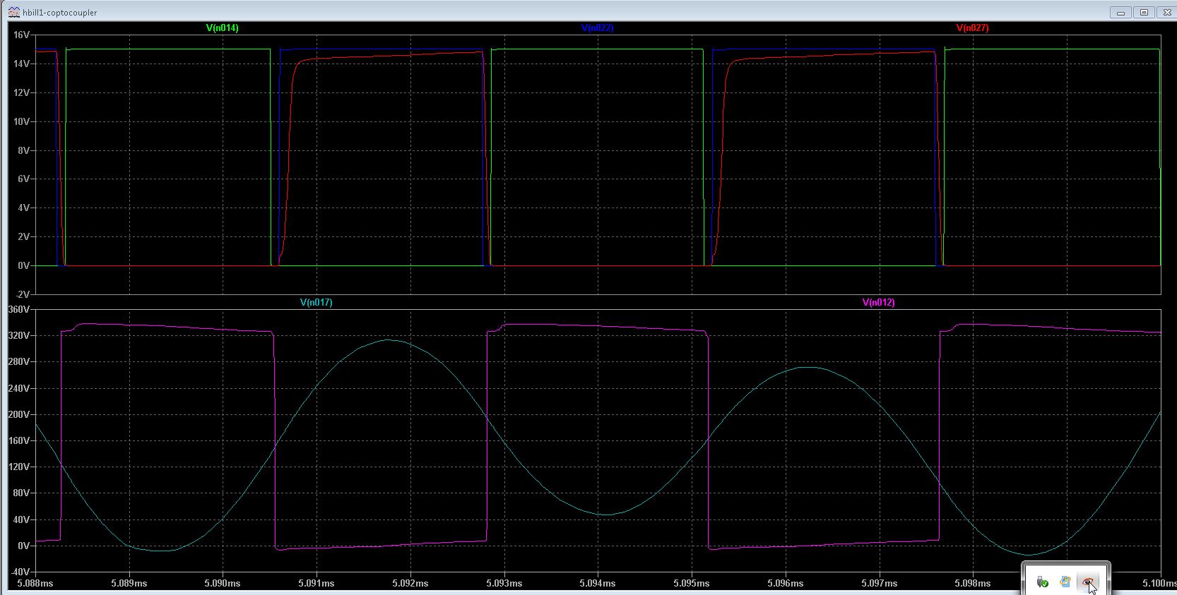

The solution seems that a LCC version resoant smps does a lot better there, signals looks
more stable, did just halve the capacitance of the resonant cap and did a extra one over the primairy coil, now the feedback does fine, I have ZCS and ZVS as result, even with no load.
Feedback does now the job,, with low and high load, does even the job now with just no load, open output. LCC does better, less ripple I did see also. These are quite good for welding smps
regards

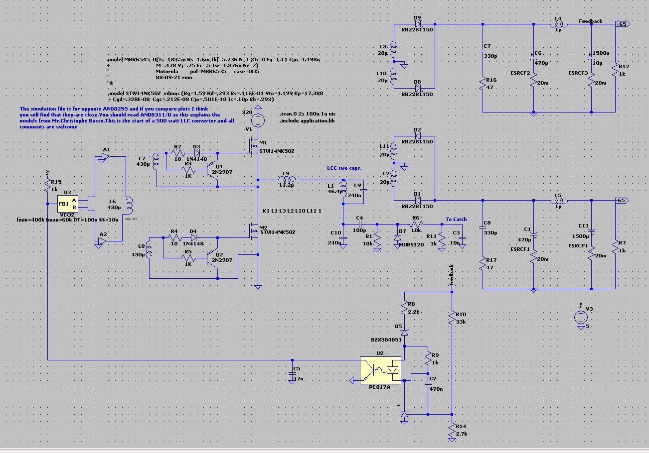

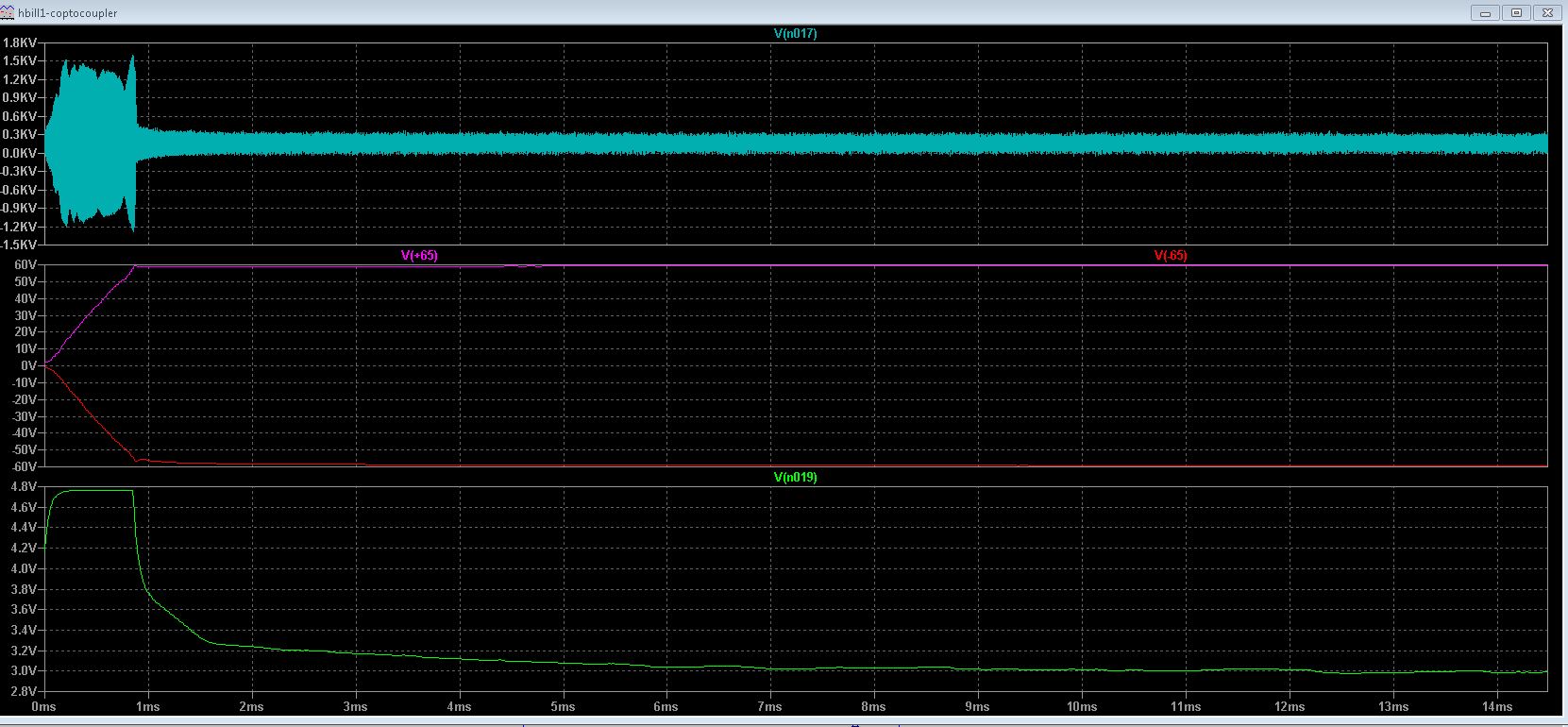

Have a look at the primary overcurrent during power up while charging the secondary caps. Is it inside SOA of the PowerMOSFETs? I assume not so you will need some kind of softstart or current limit otherwise there is some good chance for the MOSFETs to blow upon the first power up.
Startup is high, but that will be done properly when build, the model has no soft startup, it is just a simple vco model.
Problem was the feedback, it runs out without load giving max unregulated voltage, a LCC version was able to do it properly, so I think the tank gain or Q is cause.
The softstart is included in the chip, I believe it starts below resonance or above, (what is used) and adjust after caps are charged.

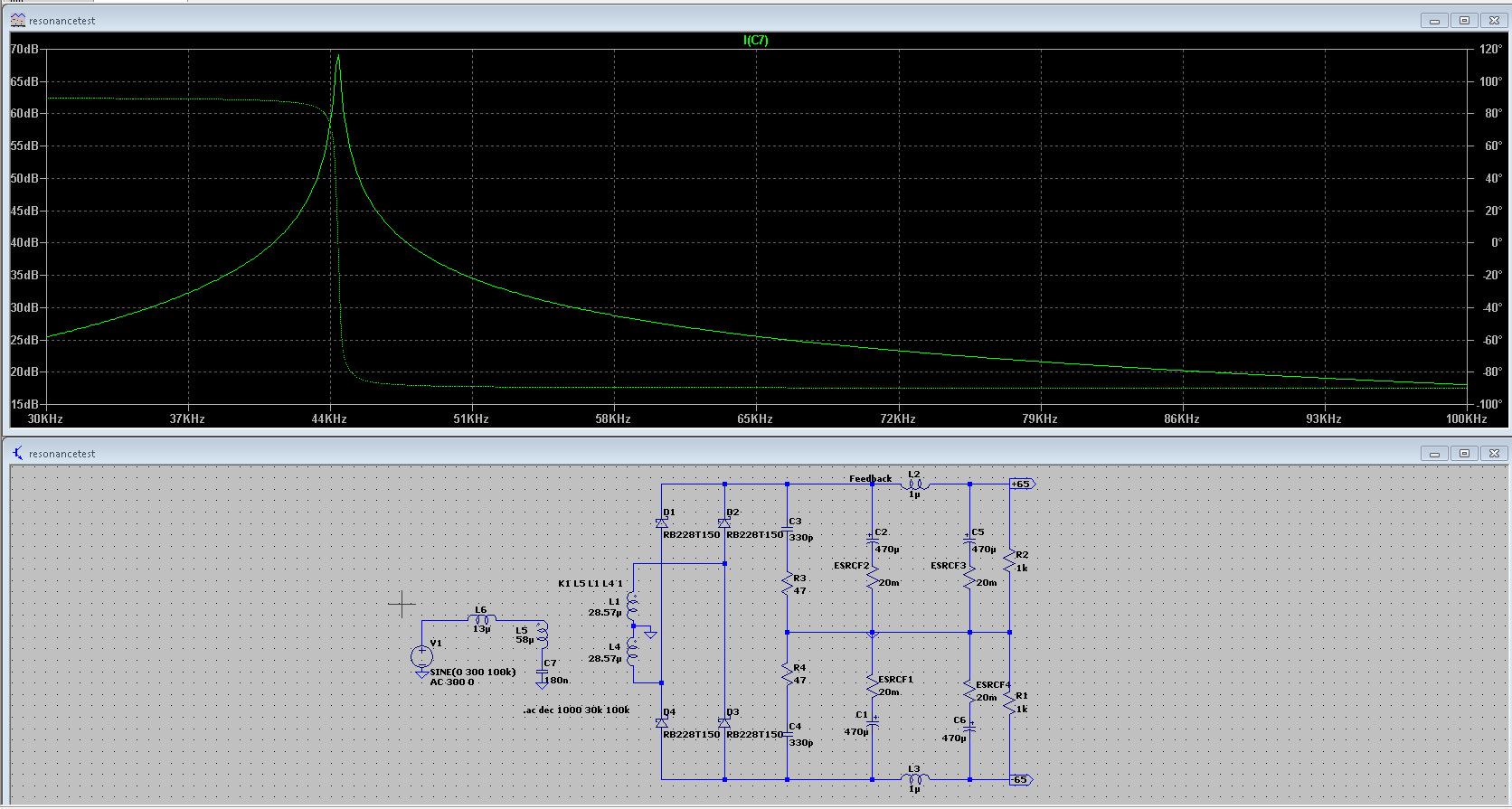

Here I have the simulation for the tube supply in resonabce, it is open loop and I did see that it keeps quite good the voltages when amps get drawn, on max, just 2 volts.
I go use LM type of regulators after the 18 volts out, for the tubes filament.
I am a little worried beacuse of the calculation of the multiply windings for all the voltages, it afeect resonance and it is not easy to calculate, so need of doe it experimentally or I can use a resonance forward calculator to get close, there is calcular who can do more supply voltages.
regards

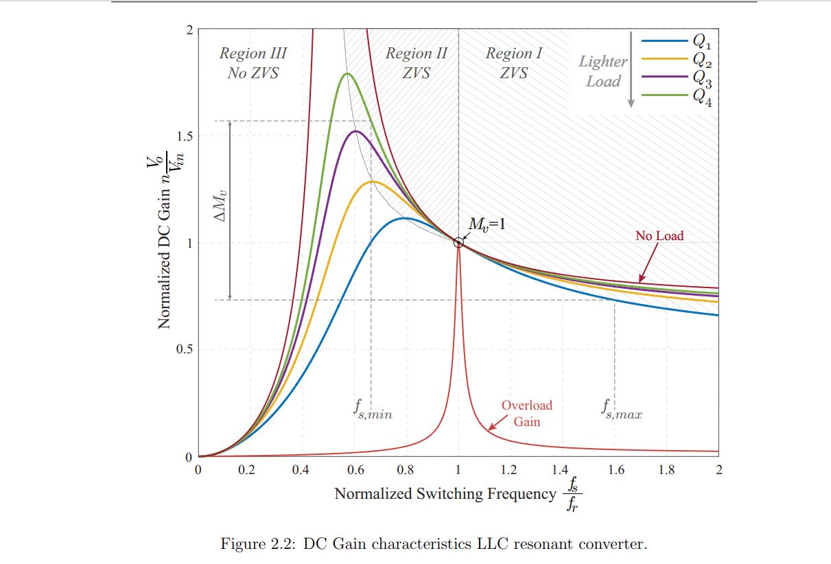

Here nice reading about the resonnat converters.
https://pdfs.semanticscholar.org/ffeb/3724fb28d92dedb760940929534e0e62960d.pdf
