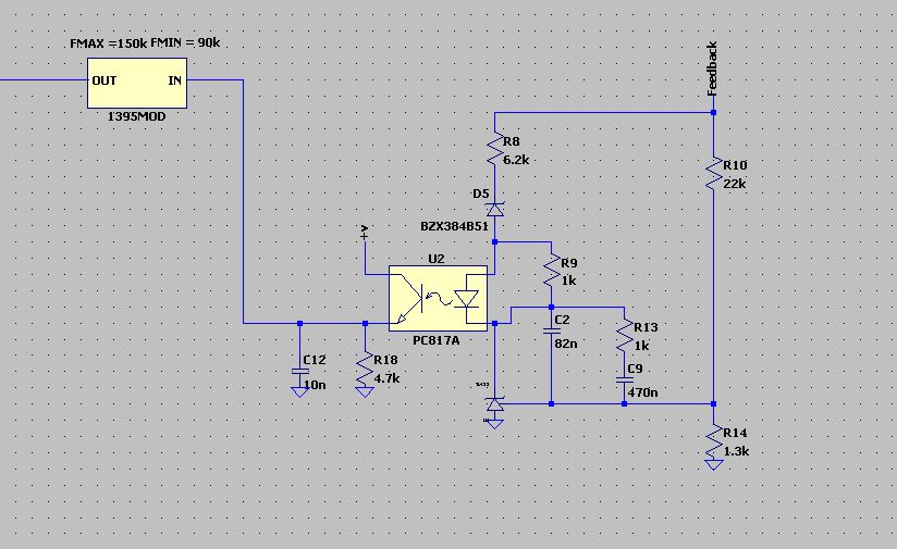

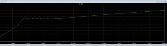

It seems to me that, R9 may or may not be as a function of the current split desired between diode (led) and this resistor to satisfice the regulator current. But, R31, R19, R20, C9 & C12 are unnecessary.
I have remove this parts and use the version who is used most, the extra poles from R13 and C9 in resonant versions.
This does work but why does when I change R10 the voltage does not change? maybe bacause of the zener? because these does give other voltages when changt that zener who is normal afcouse after get over zenervoltage the optodiode get conduct and regulate then.
There are different systems out there with opto,s, need good formula,s and calculate because I think this is not such a complicated task.

The schematic in post below, reference and anode are shortcircuited, then the net is useless. C2, C9 caps and the resistor R13 are all shorted out.
Hmmm yehh I have not see that error, no wonder R10 did nothing, but here is the working one, I have now made the setup.
For learning, I need to build a regulated type, can always be simple made unreguled after with some resistors.

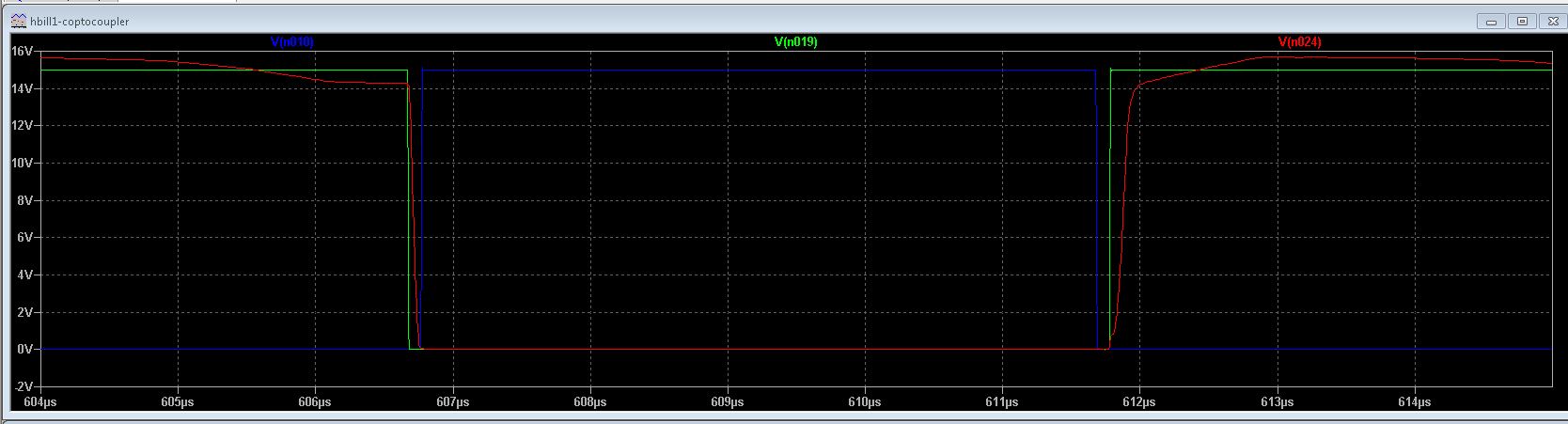

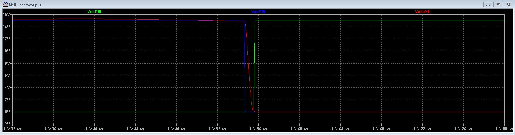

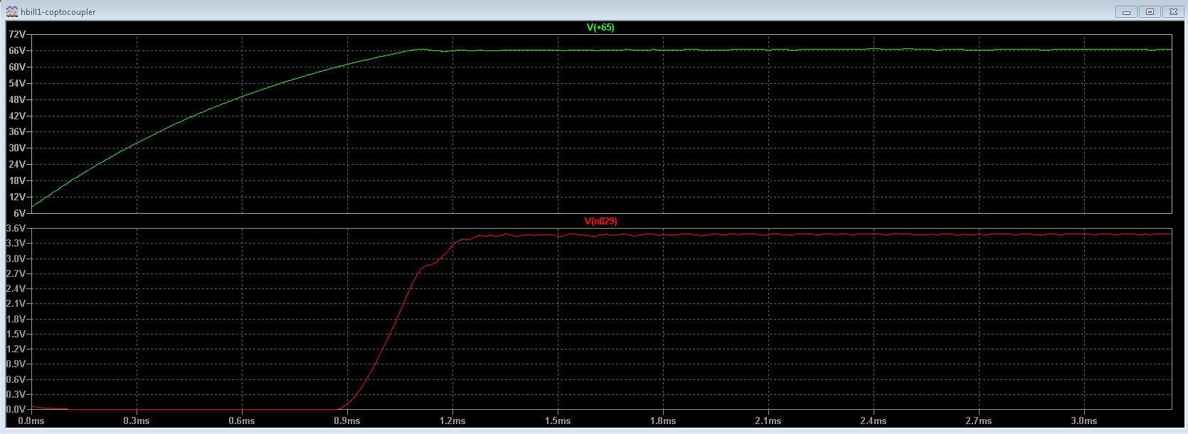

In simulation, the ZVS is present see the deadtime and gate switch on in that time.

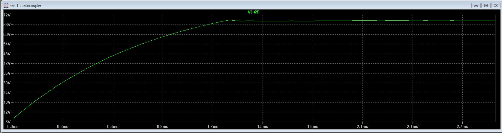

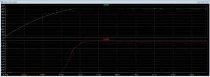

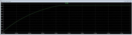

What I discover now in simulation, when output is open, only a 1 k resistor, the regulation do not work causing the smps to get full voltage, maybe cause is the output caps and time.

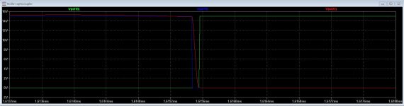

Interesting. I have lack of some components, but still understandable. Why not to replace driver trafo for a SS driver (IR211x), I'm in doubt about coupled resonances through Miller capacitances from output trafo to driver trafo.
I like safety when thing blow the irs is also with the rest, a small transformer do well, special when new to it.
I do see the feedback get out of track when do output on high resistor like 1 k.
it do for a small moment lock, then loose.

You may over-estimate the security of a gate transformer. Isolation often is tested with DC voltages - and with the high dV/dt rates applied from the bridge output I succeeded in burning them.
Gate transformers work best with constant duty cycle of 50%. Otherwise ugly things happen requiring complex circuitry for compensation.
And do consider the primary to secondary coupling capacitance in the ballpark of 100pF.
Last but not least they are pricey.
If you want a secure solution protecting the drivers when the power MOSFETs burn, I would go a different path:
Use your halfbridge driver and insert coupling caps into the gate lines. 10nF/300V-X2 or similar will do. In case of breakdown, the supply voltage is blocked and there will be a short charging pulse - which does not harm the driver.
And to enable DC coupling to the gates, a simple resistor 100kOhm/1W parallel to the coupling caps restores DC bias.
The power transformer normally is fitted with a gap. But not to tune the resonant frequency - stray inductance is hardly affected by the gap - but to generate enough magnetizing current that ensures ZVS swing during dead time.
