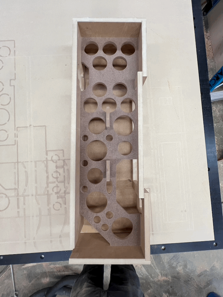

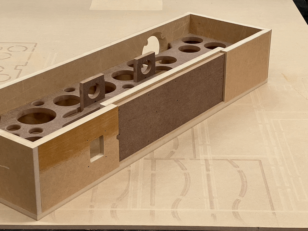

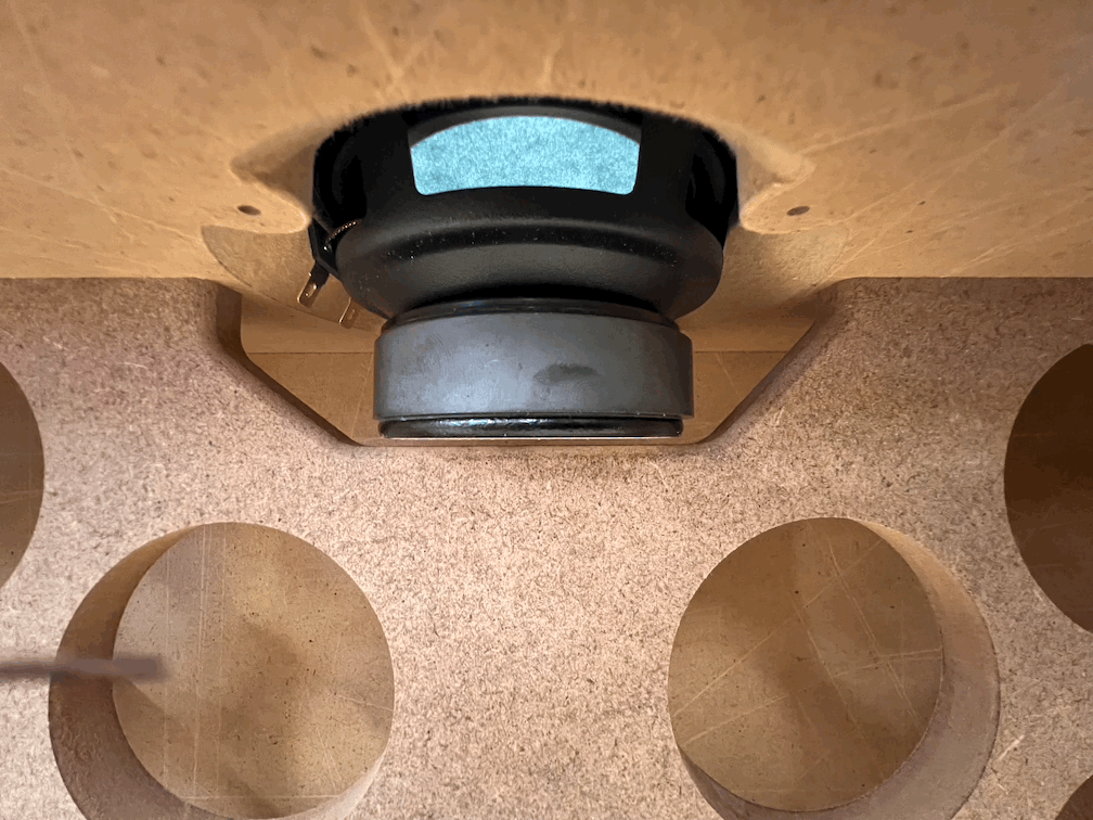

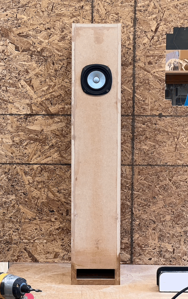

Dry fitting is going well. There are only a few small issues that would have been solved with having a finish pass when cutting. Next up is to finish drilling the holes where the 1/8" bit was too short to cut all the way through, then glue everything together. I also need to find my stash of binding posts, so that I can make the board for that. Then time for a listen 🙂

When I learned how to use the CNC router, it was a game changer for building pretty much everything. It takes longer to draw everything up, but you can work out a whole bunch of the build problems without wasting any wood. The program I use allows for parametric design, so if you draw something up correctly from the start, you type in a number and poof, the material thickness, and everything related to that changes, while leaving things like the inside dimensions as defined. If you get good at figuring out tolerances, it's pretty much one and done with very little sanding or fitting.

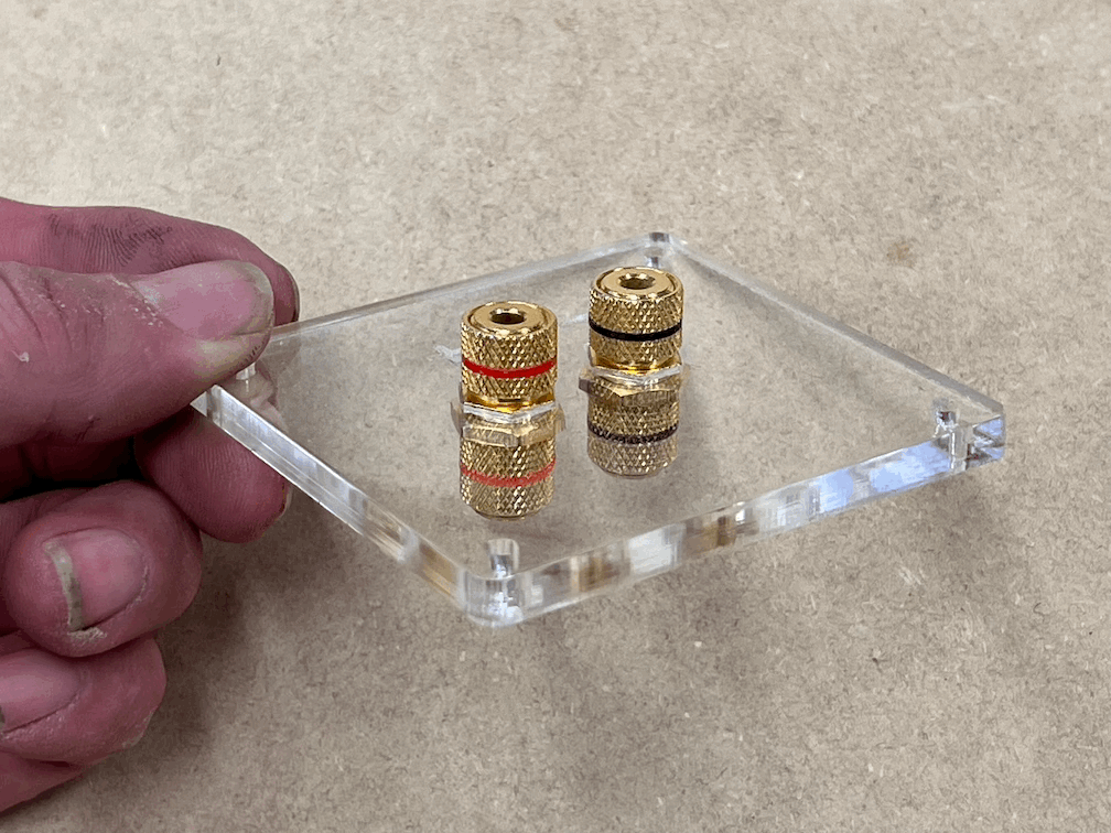

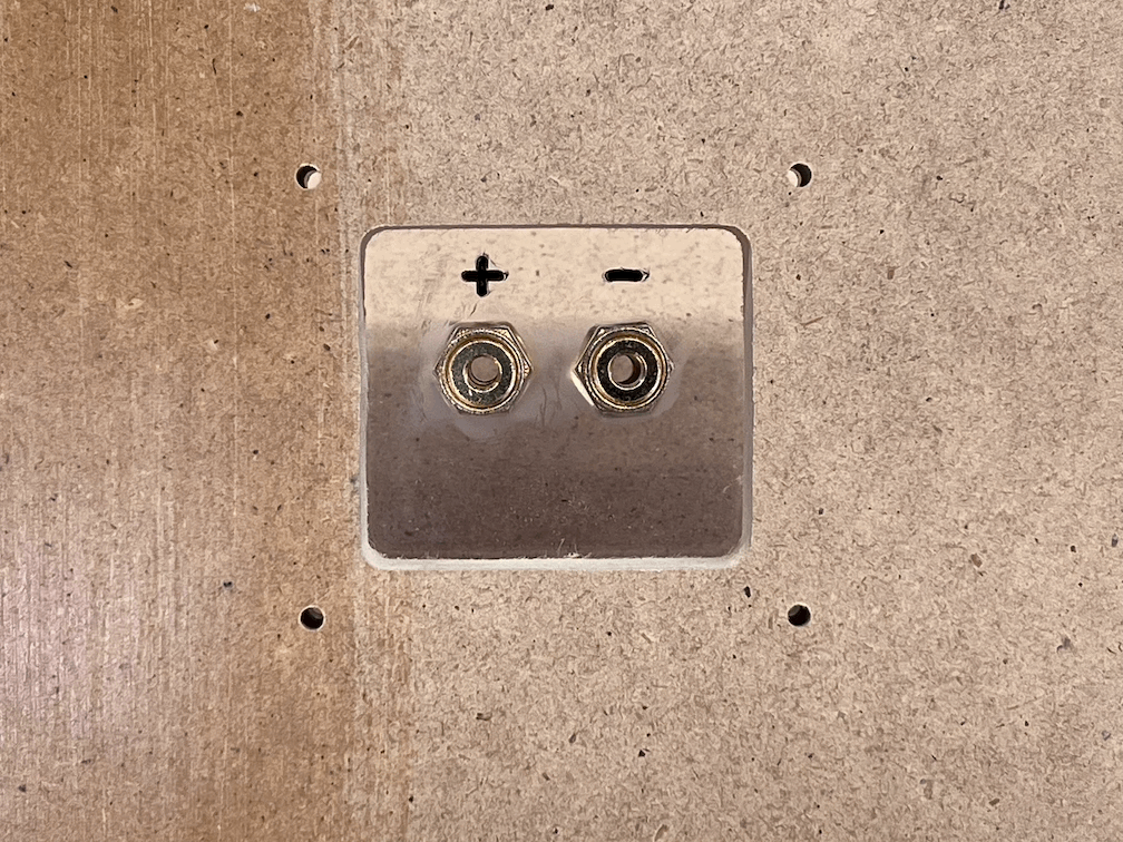

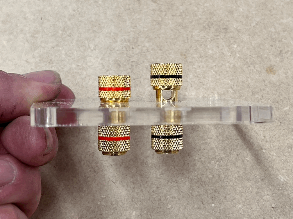

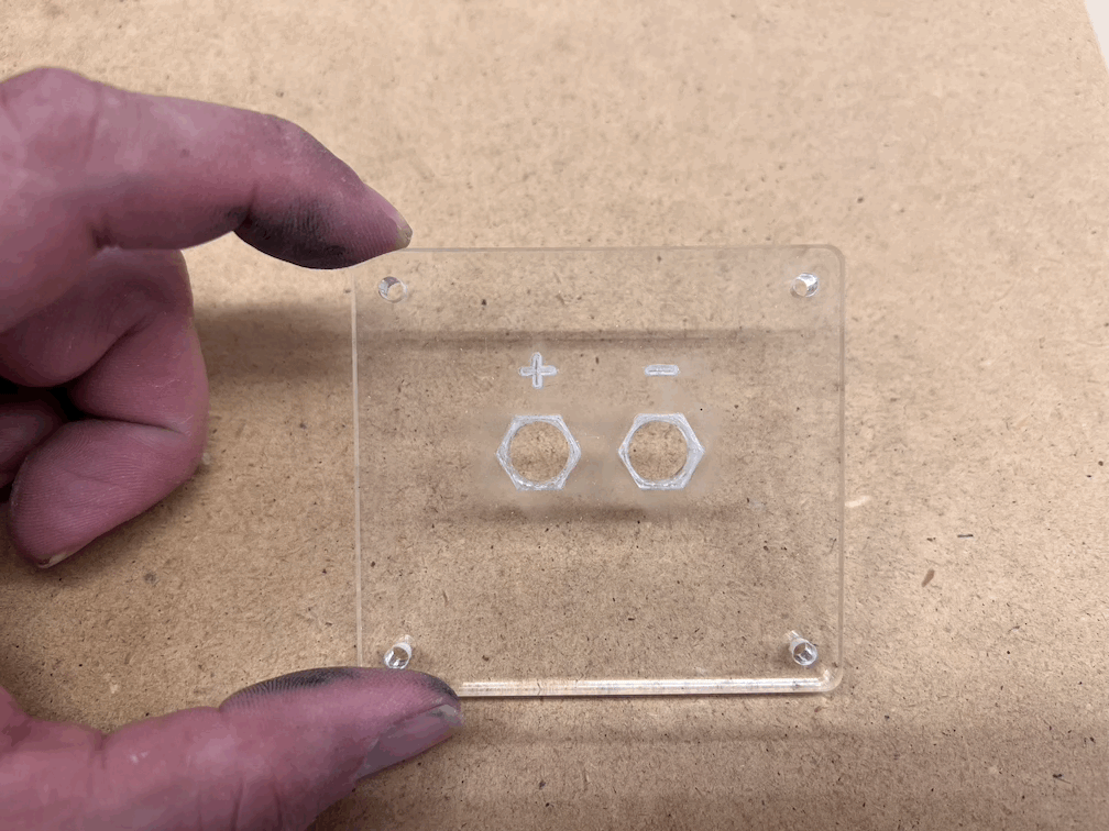

Found some binding posts I got last year from the auction site, and cut some 1/4" thick acrylic with a laser cutter to mount them. A little acrylic paint or some wax pencil rubbed into the etched +/- symbols makes them a bit more legible. I'll was thinking about tapping threads into the acrylic, but it doesn't make very strong threads. Some parts of the cabinets are glued up, but I usually take my time with glue-ups, so that everything stays well aligned, and held square and tight.

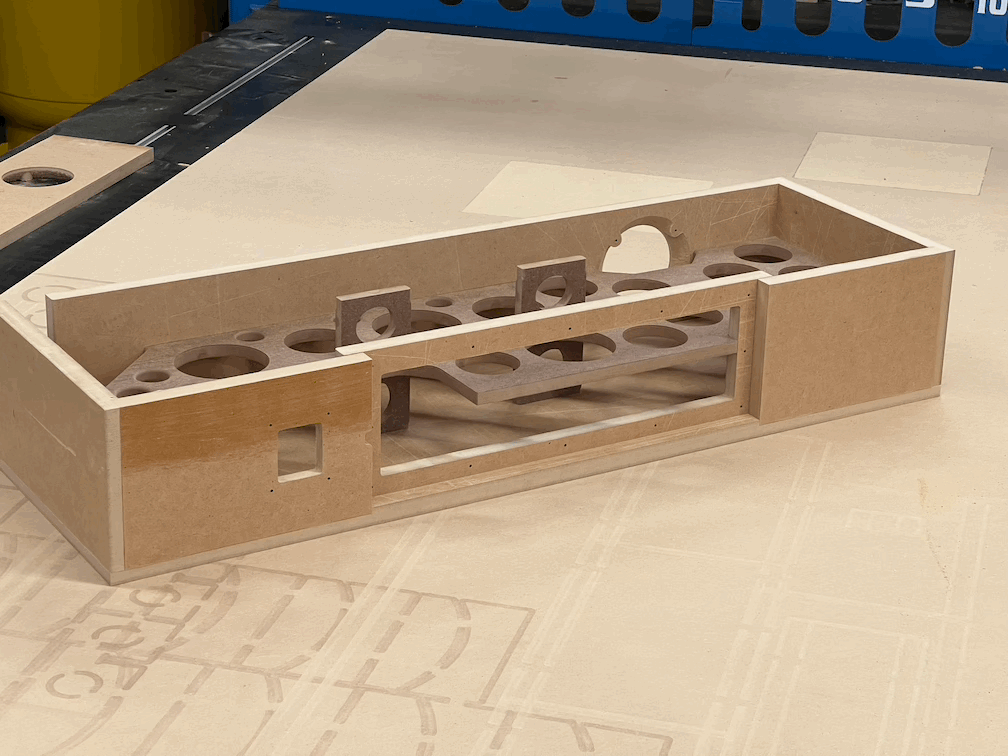

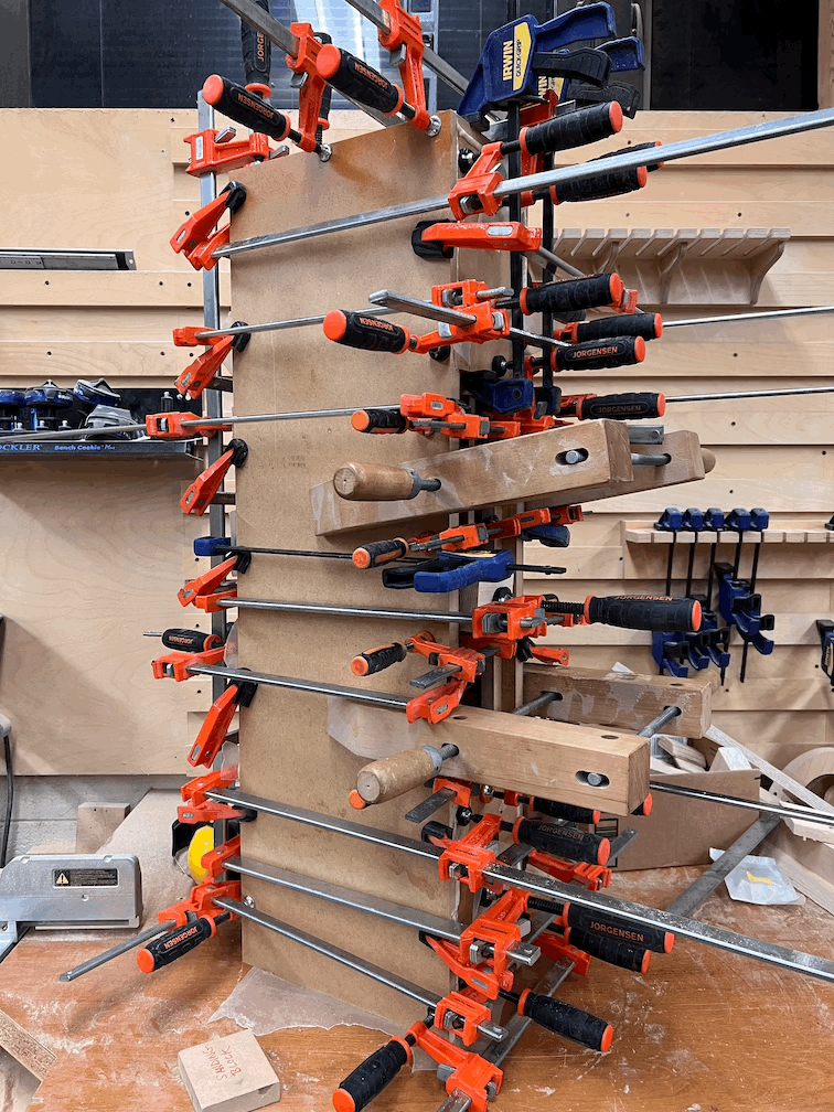

I got some glue on a surface that wasn't supposed to get glue yet, so I went ahead and clamped the whole thing together. Almost ran out of clamps!
Using polyurethane glue can be a blessing and a curse... it has a longish open time, but if you don't clamp every single surface well, it will puff up and push the pieces apart and make a weak joint. As a wise man once said, "too much is never enough", and that certainly holds true for clamps. 😆
Hopefully the second box goes together a little more smoothly!

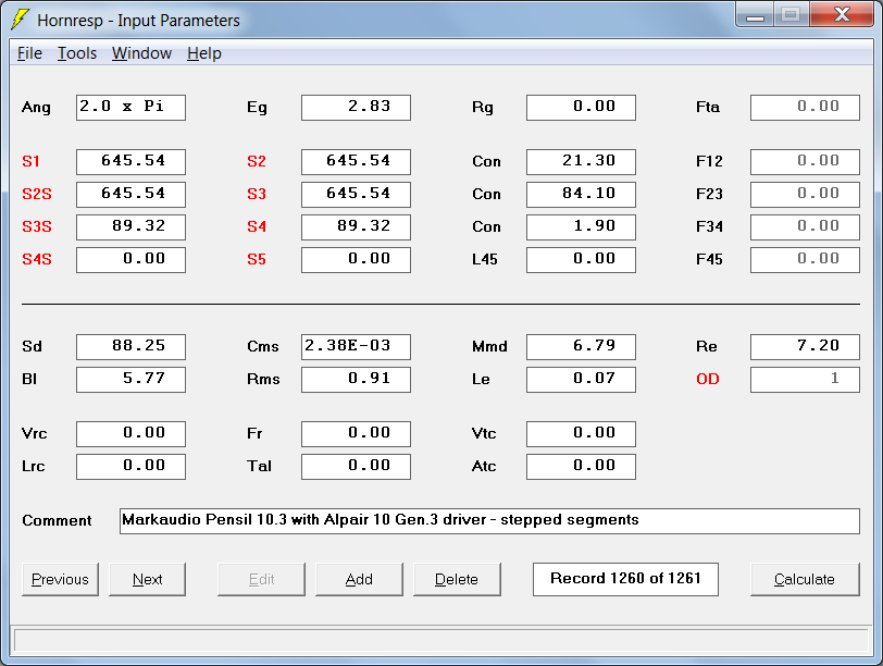

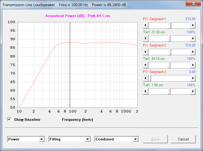

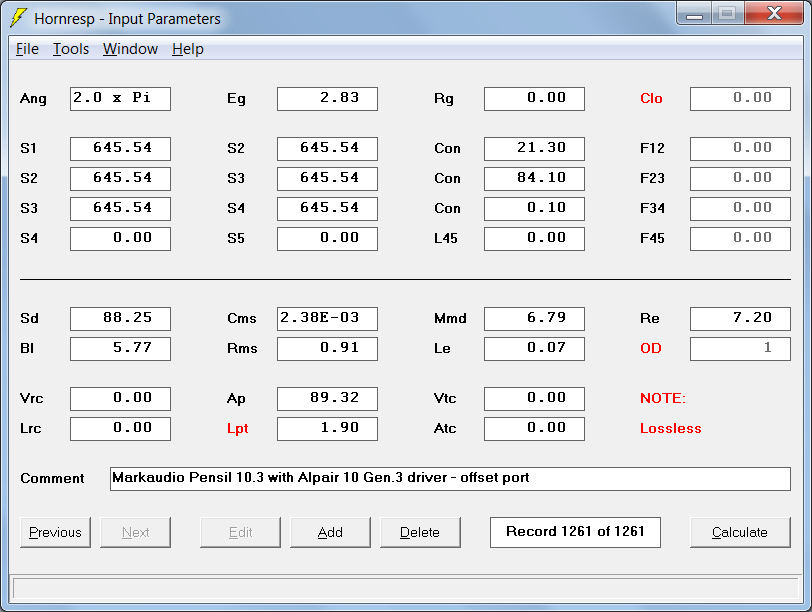

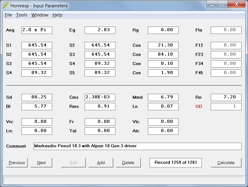

- calculating Pensil speaker dimensions for arbitrary drivers
