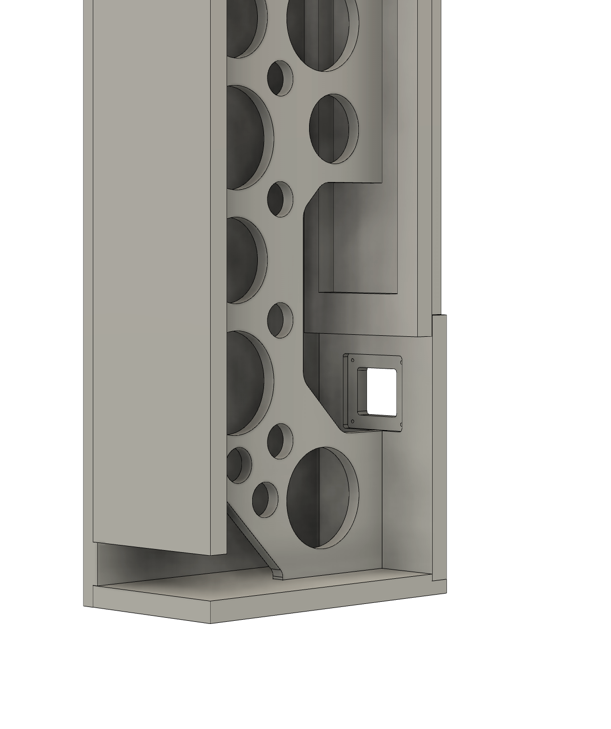

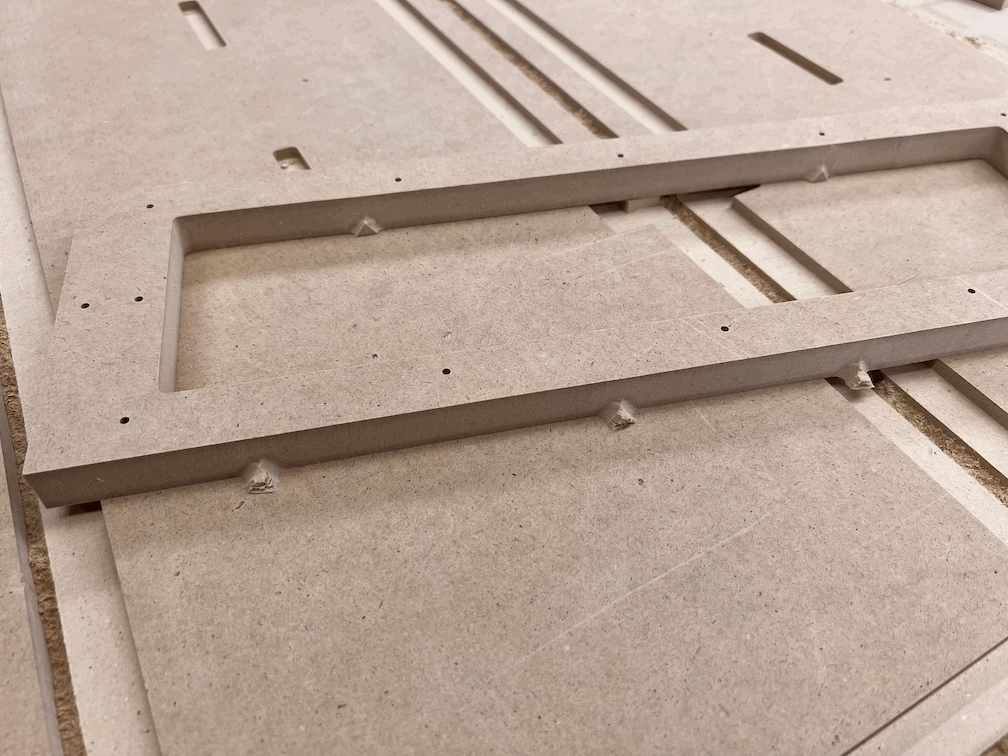

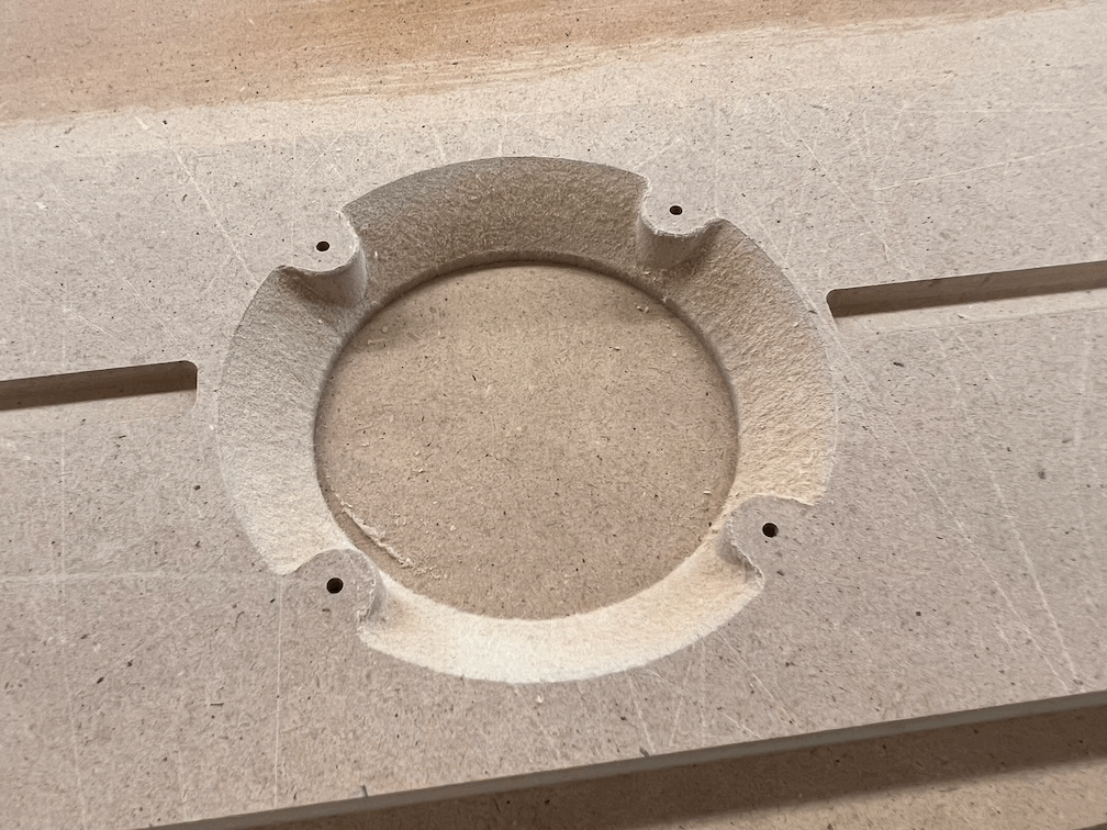

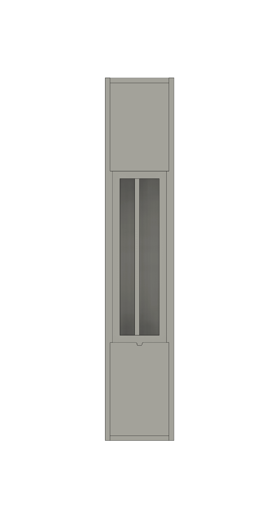

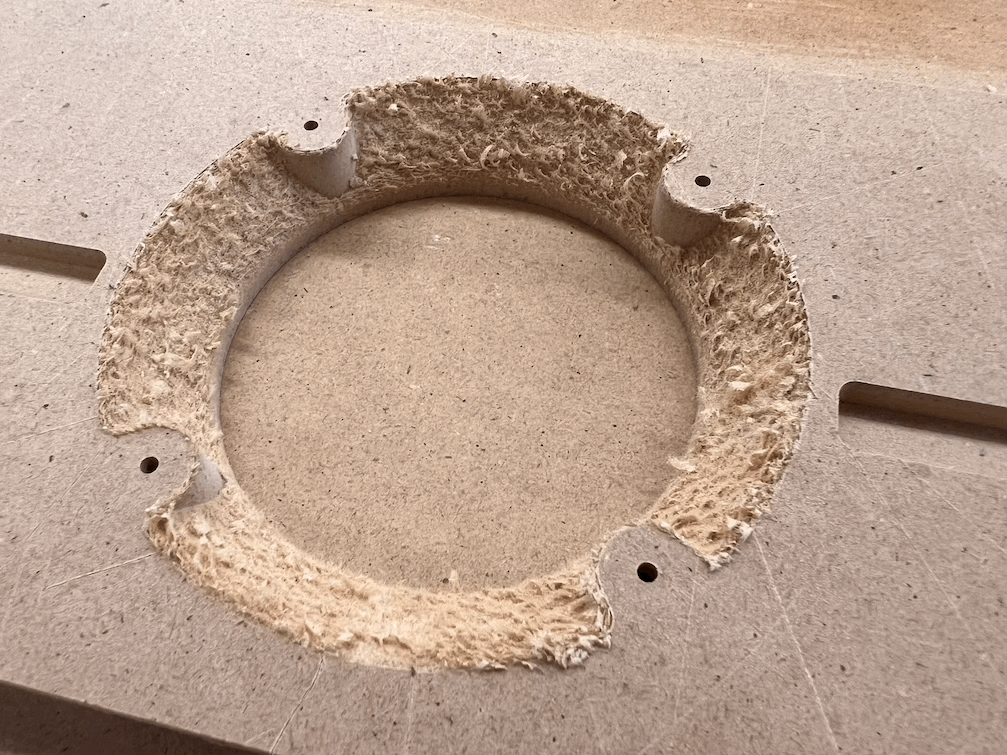

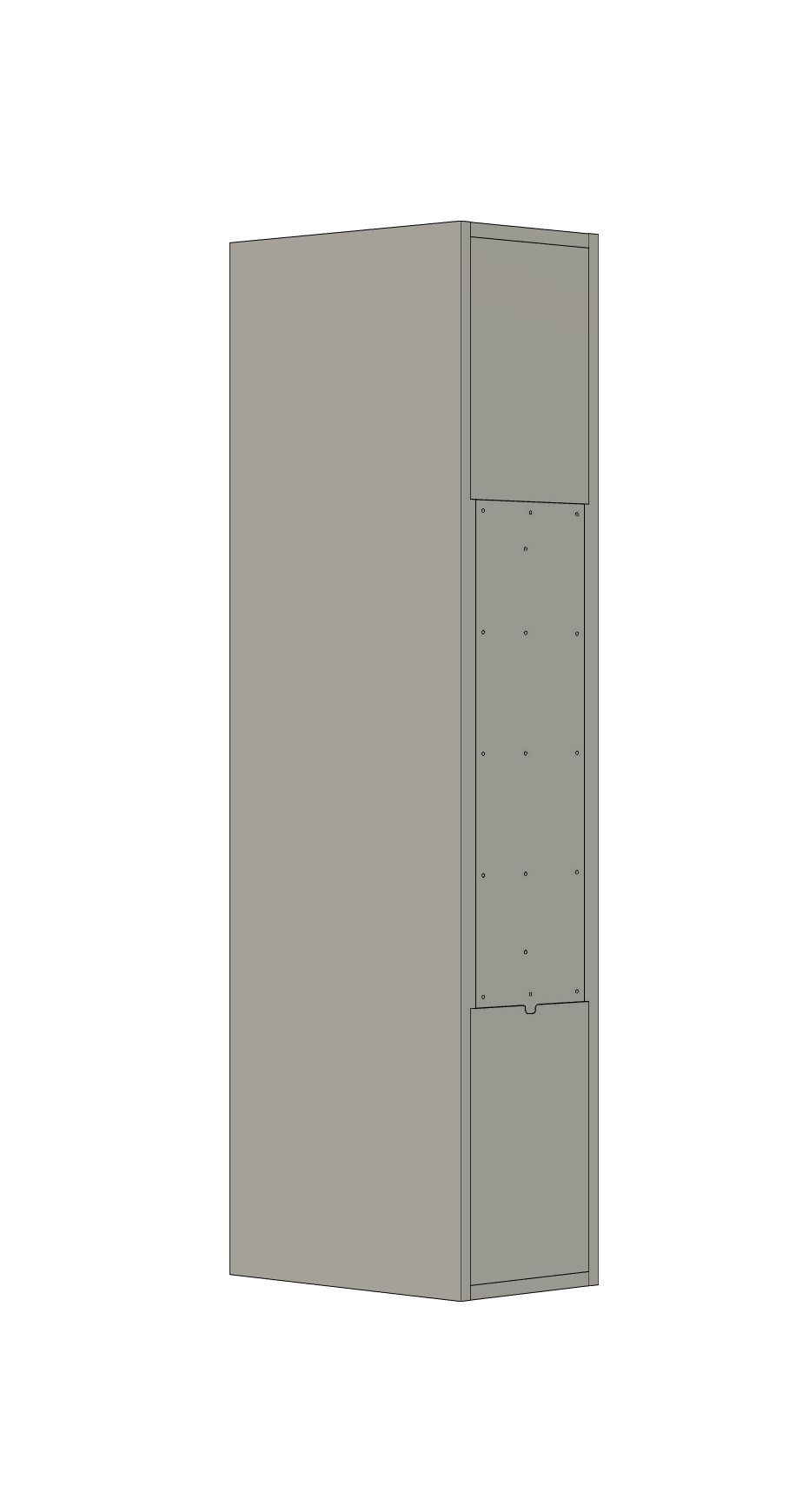

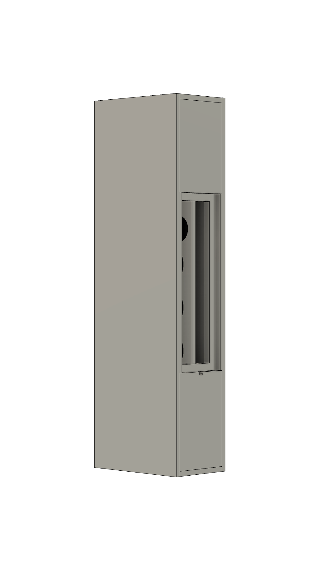

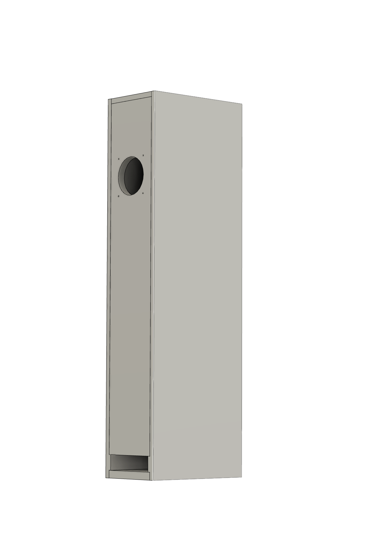

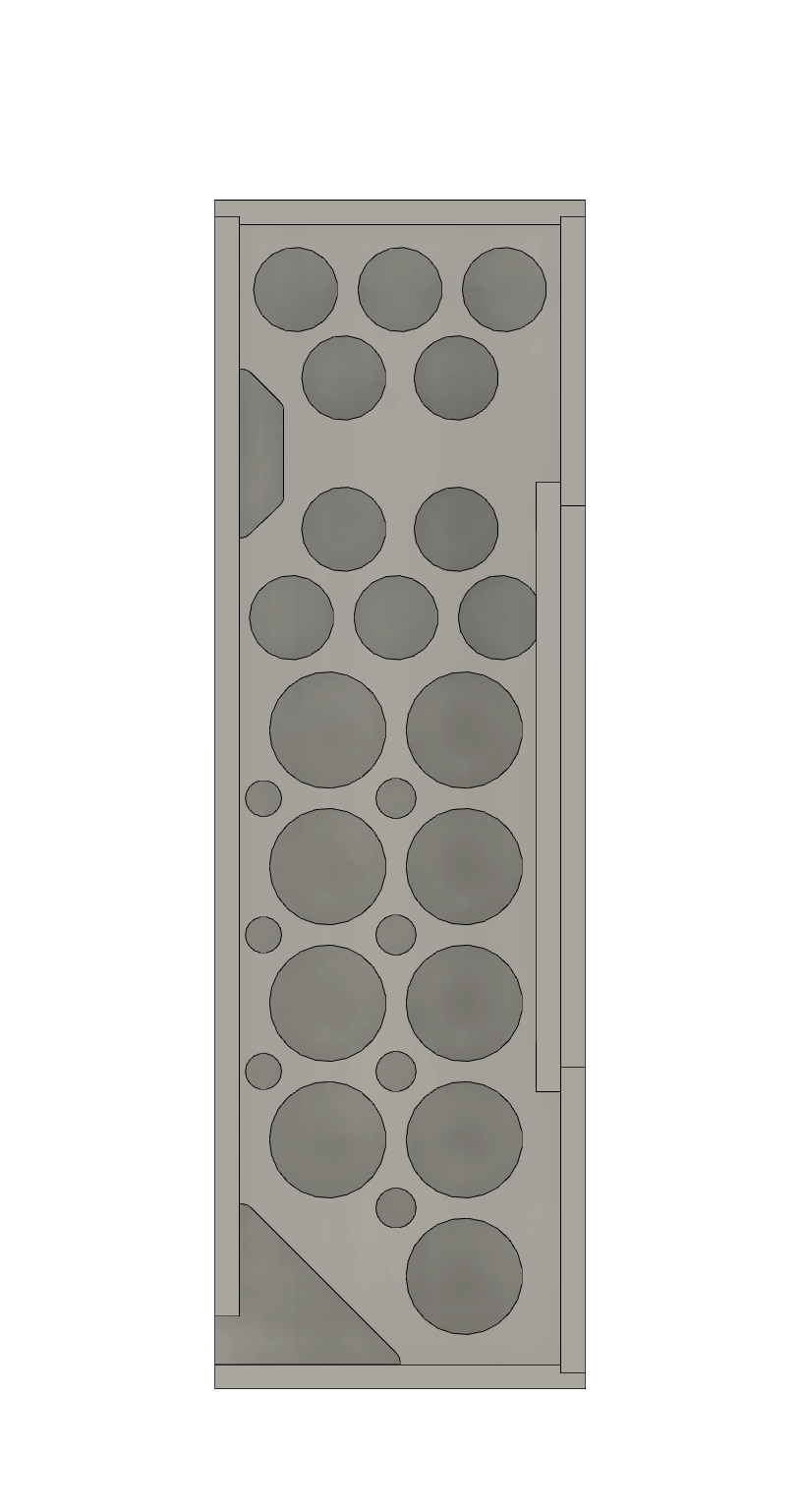

Dry fitting is going well. There are only a few small issues that would have been solved with having a finish pass when cutting. Next up is to finish drilling the holes where the 1/8" bit was too short to cut all the way through, then glue everything together. I also need to find my stash of binding posts, so that I can make the board for that. Then time for a listen 🙂
Thanks for the help so far! I'm hoping that I don't like these so much that I feel the need to buy some of the more $$$ drivers and build a bigger set. I have two more of these drivers, and was considering maybe a set of the Baby-Lab Skyflash, a set of basic ported boxes, and maybe a dipole mini-tower. It would be nice to have a whole bunch of different cabinets with the same driver to get a feel for what makes each type shine in it's own way.

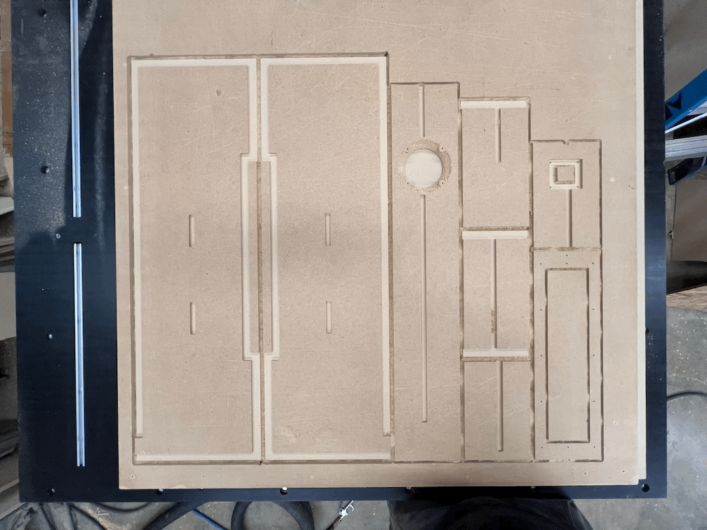

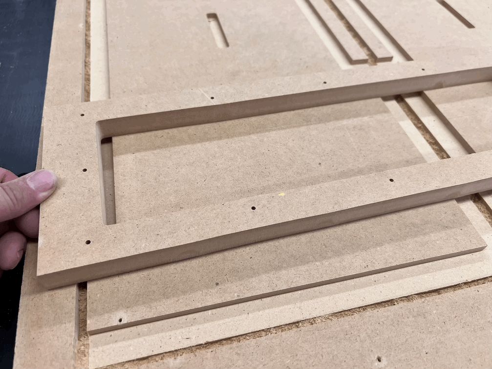

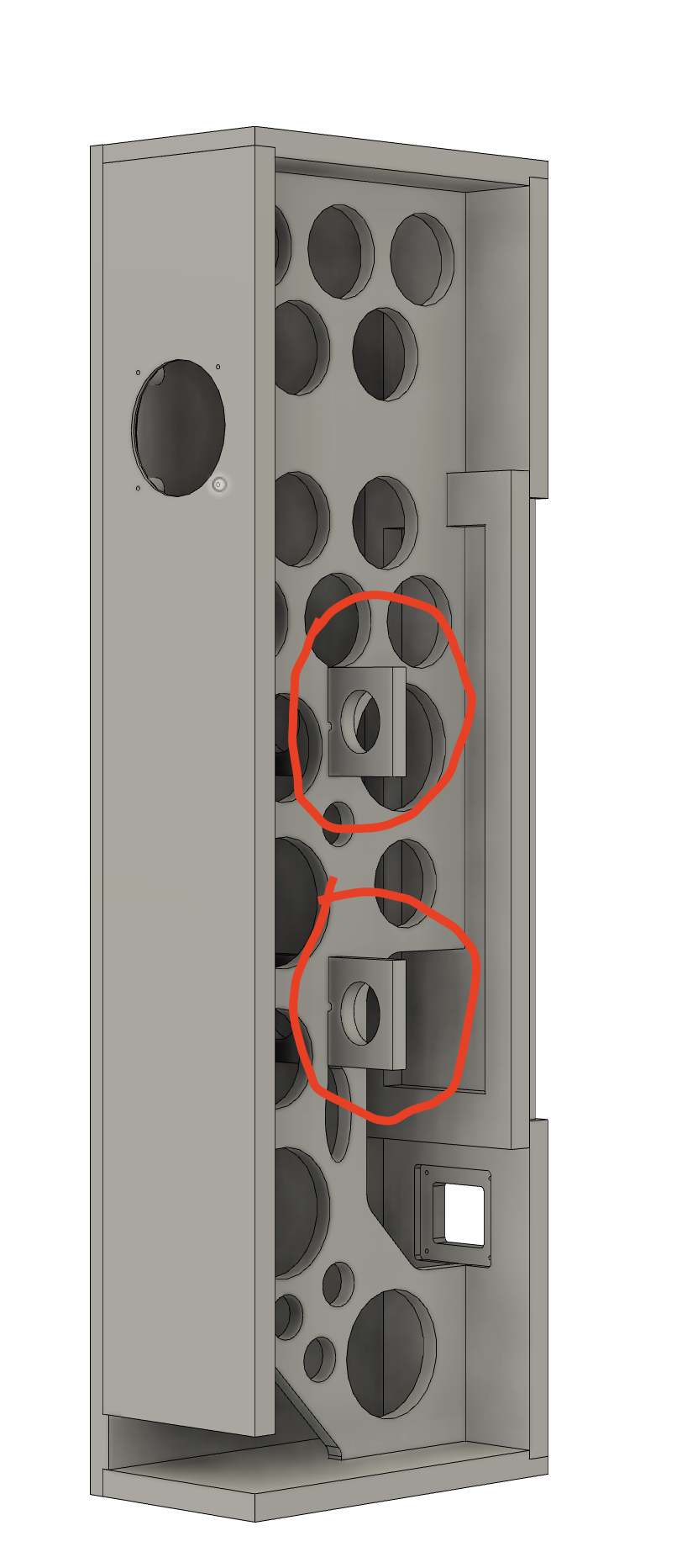

When I learned how to use the CNC router, it was a game changer for building pretty much everything. It takes longer to draw everything up, but you can work out a whole bunch of the build problems without wasting any wood. The program I use allows for parametric design, so if you draw something up correctly from the start, you type in a number and poof, the material thickness, and everything related to that changes, while leaving things like the inside dimensions as defined. If you get good at figuring out tolerances, it's pretty much one and done with very little sanding or fitting.

for basic modeling of solid objects, and making toolpaths for the CNC router, I use Fusion 360 for the most part. For sending things to the laser cutter, either autocad or adobe illustrator. Sometimes a mix of those, depending on what I am trying to do, since one might excel at something the other doesn't do well.
