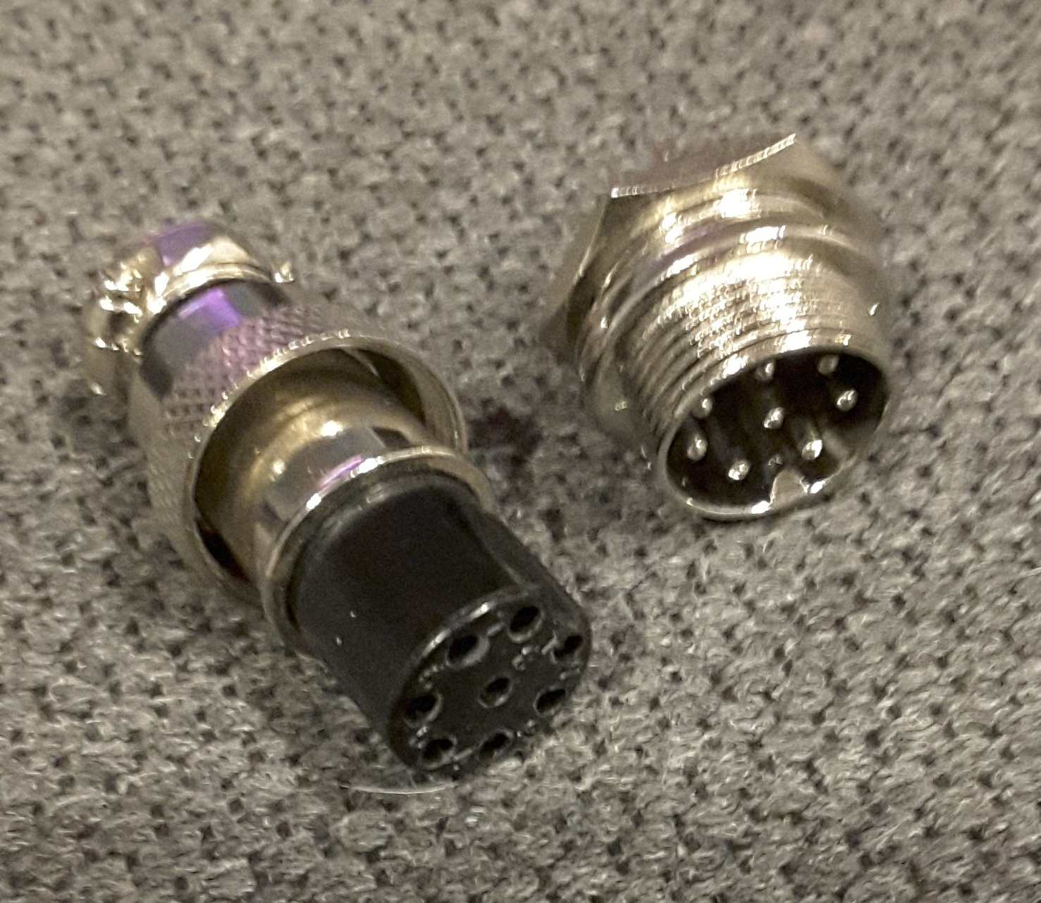

I have a few of these if you're willing to take a chance. They look similar but I can't find any manufacturer or markings. So I don't know the electrical ratings.

Those are mic connectors. I wouldn't use them if I were you.
-Chris
Thanks, good to know. So probably no good for the OP's 300B application. I'll resign them to low voltage dc use if at all.
