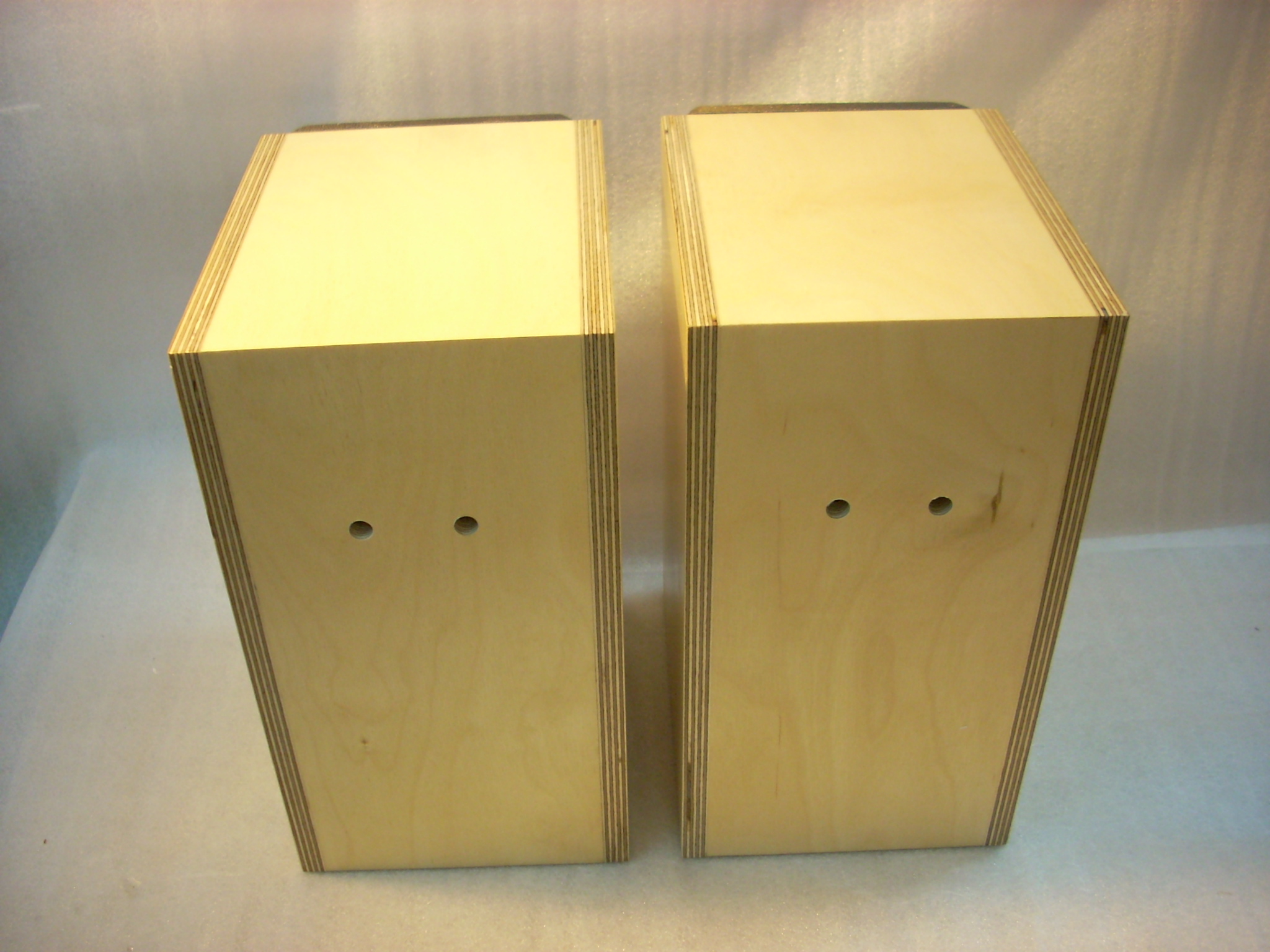

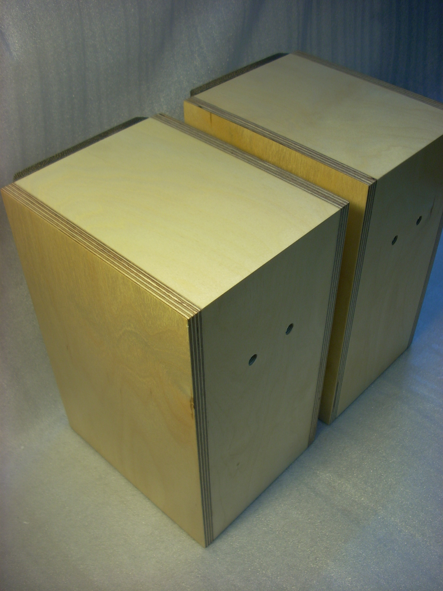

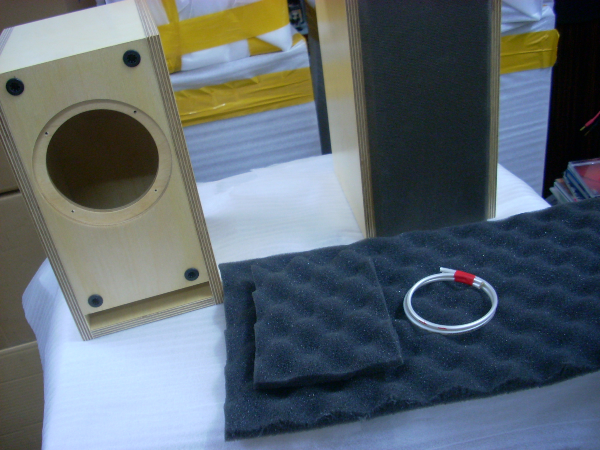

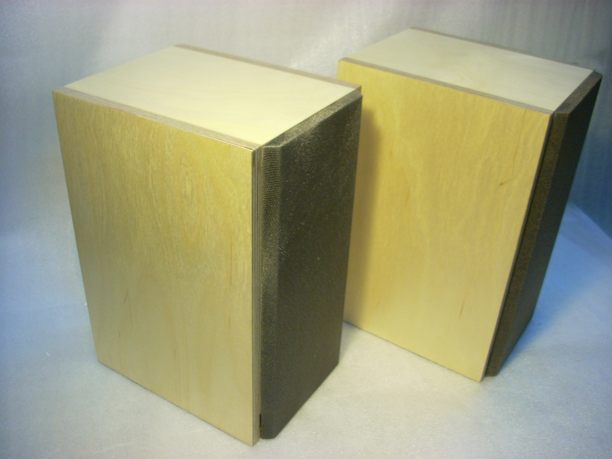

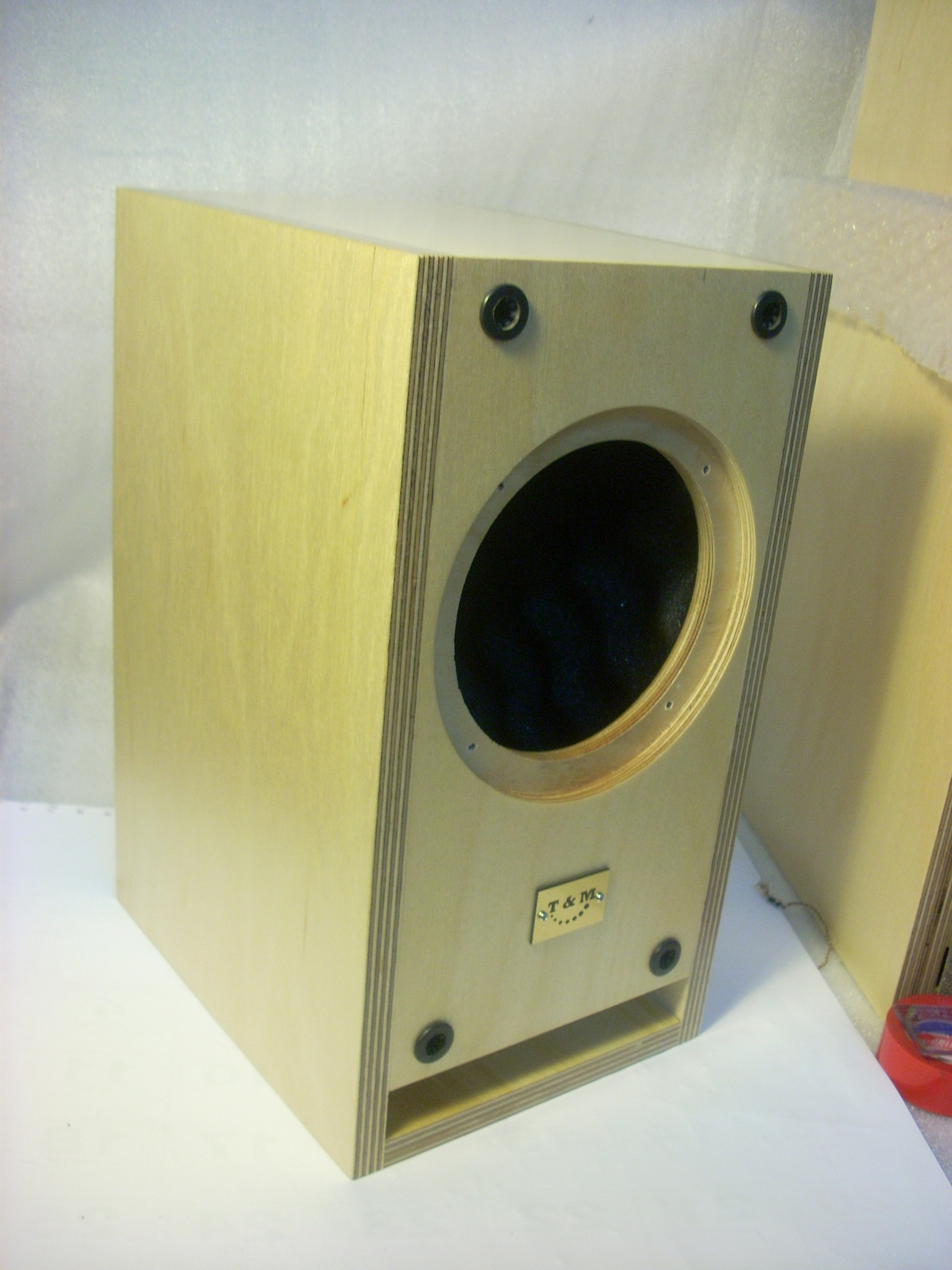

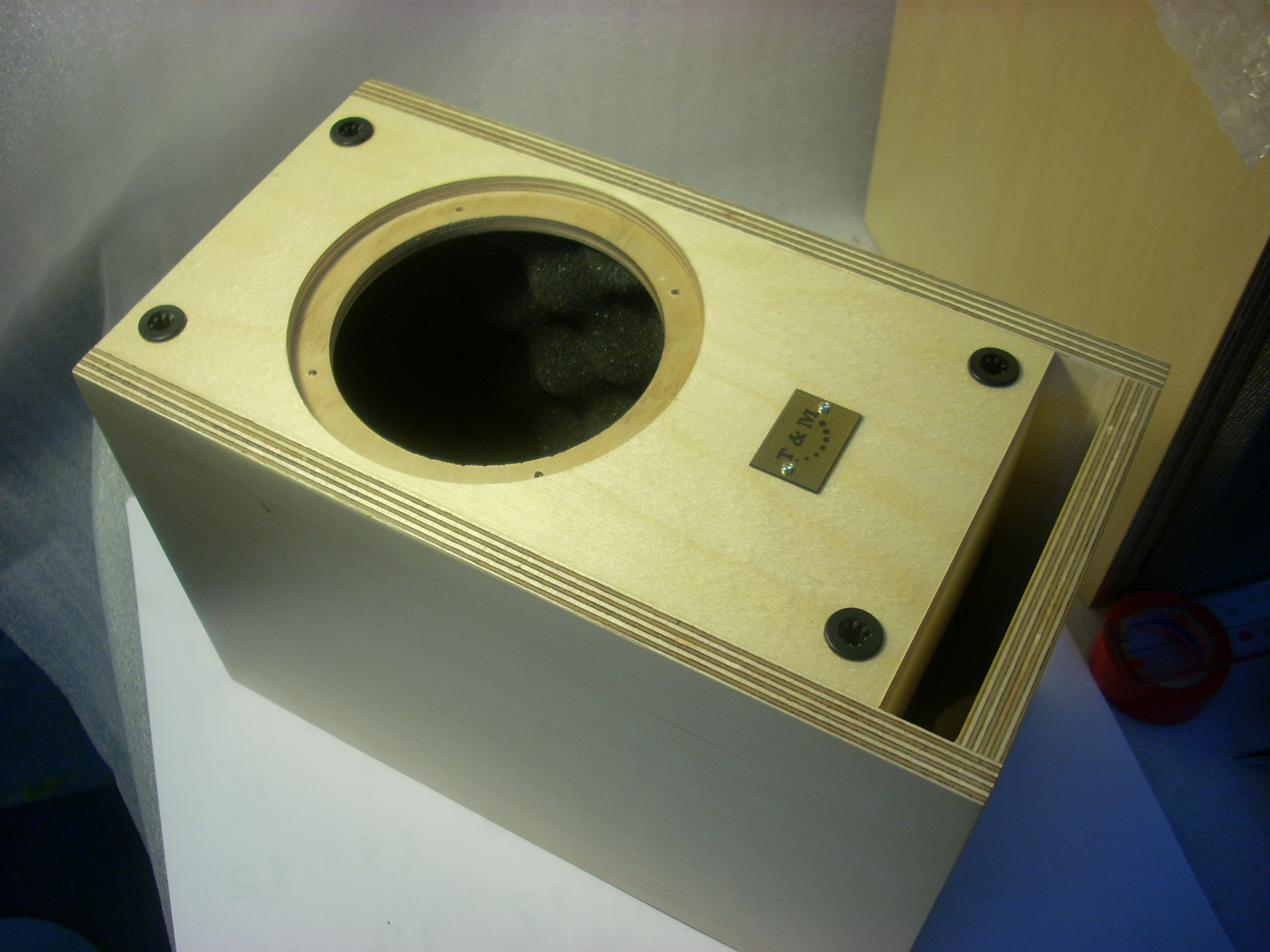

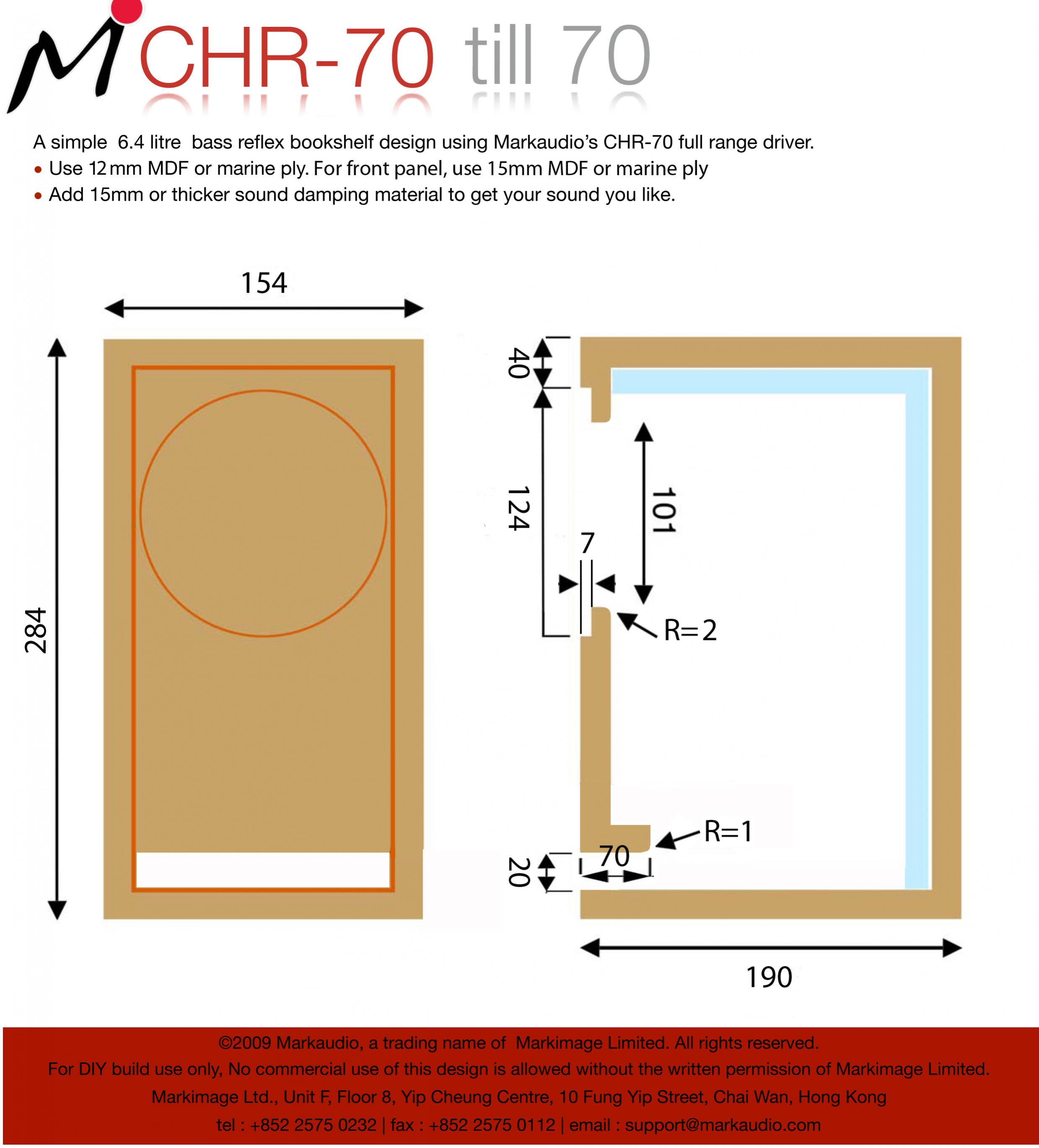

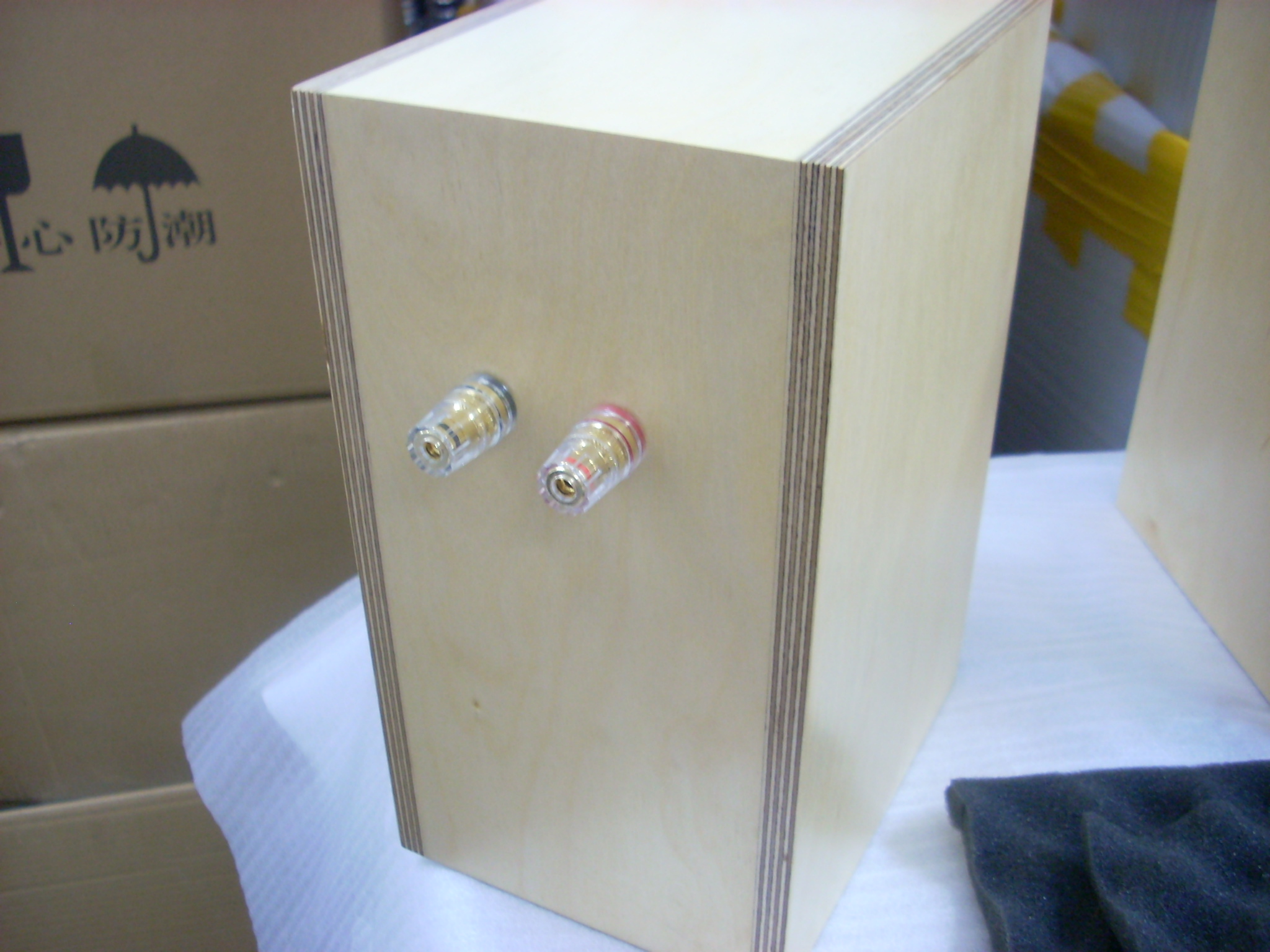

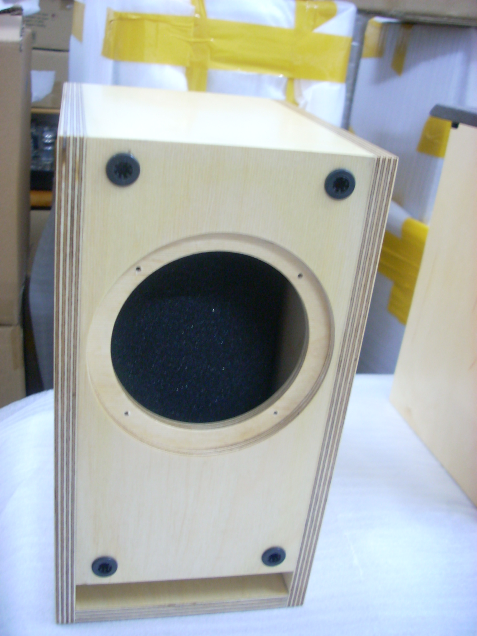

The new cabinets made with Finland WISA birch plywood arrived.
The small bass reflex cabinet was designed by Mark. 18mm birch plywood was used for front panel and other panels used 12mm birch plywood. The dimension of cabinet is 154Wx190Dx284Hmm.

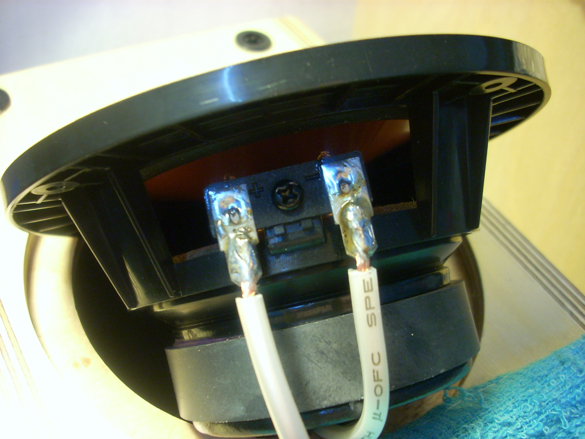

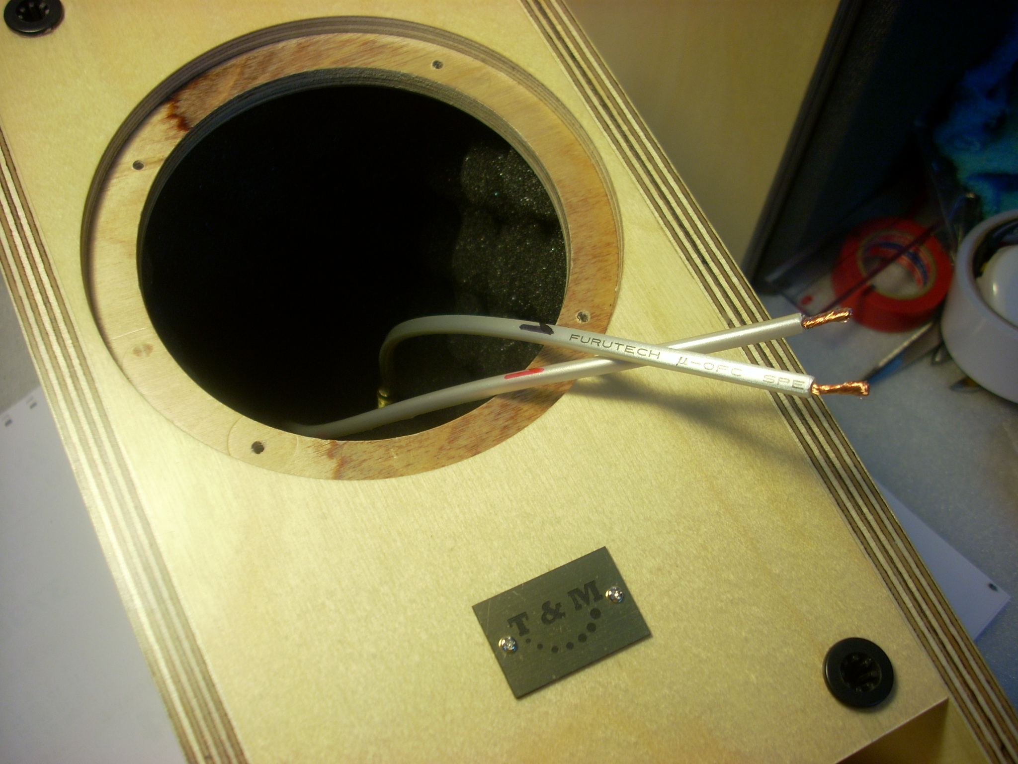

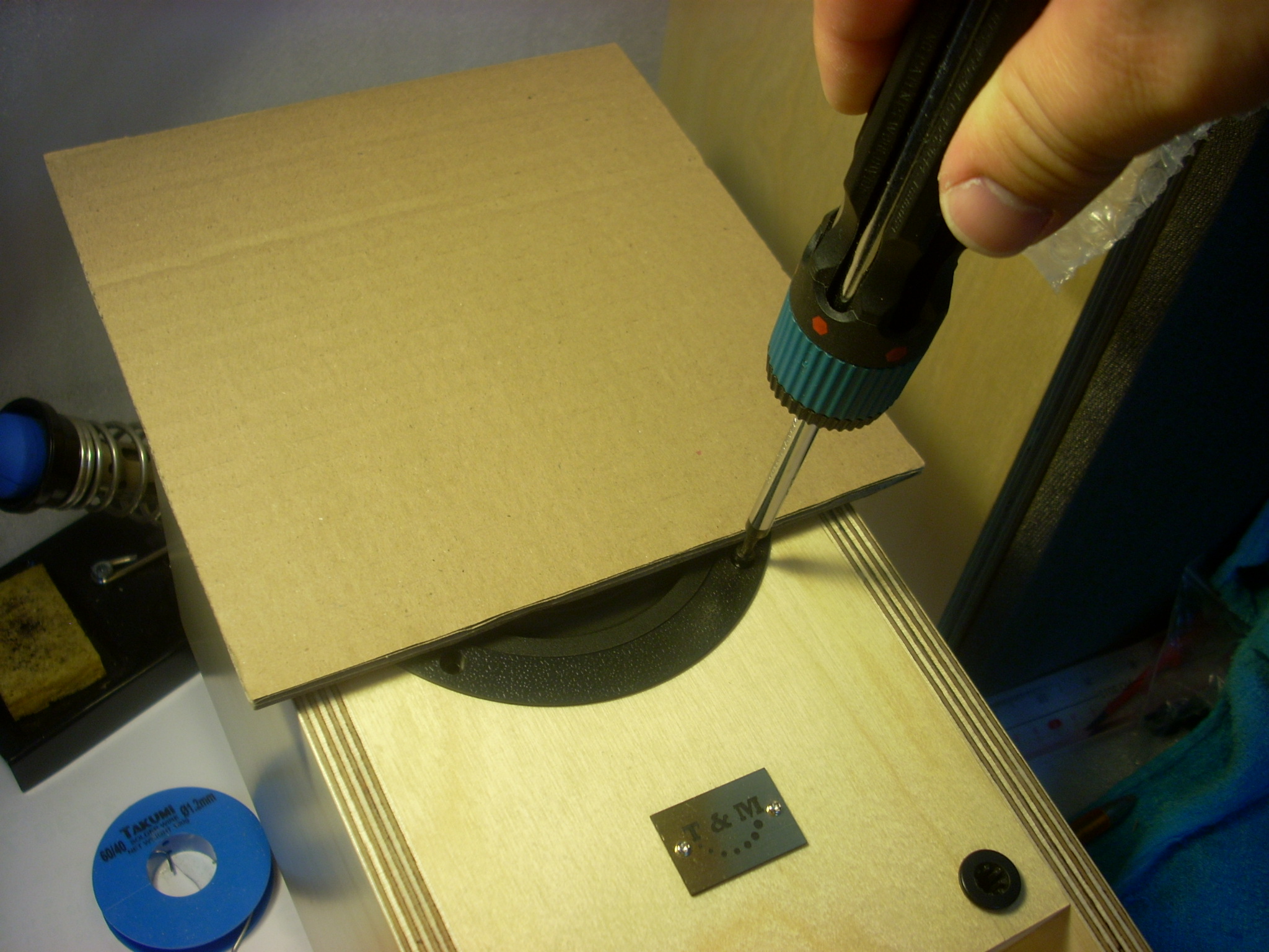

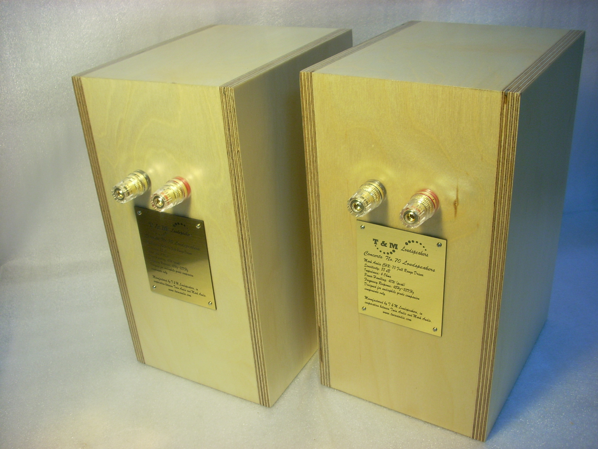

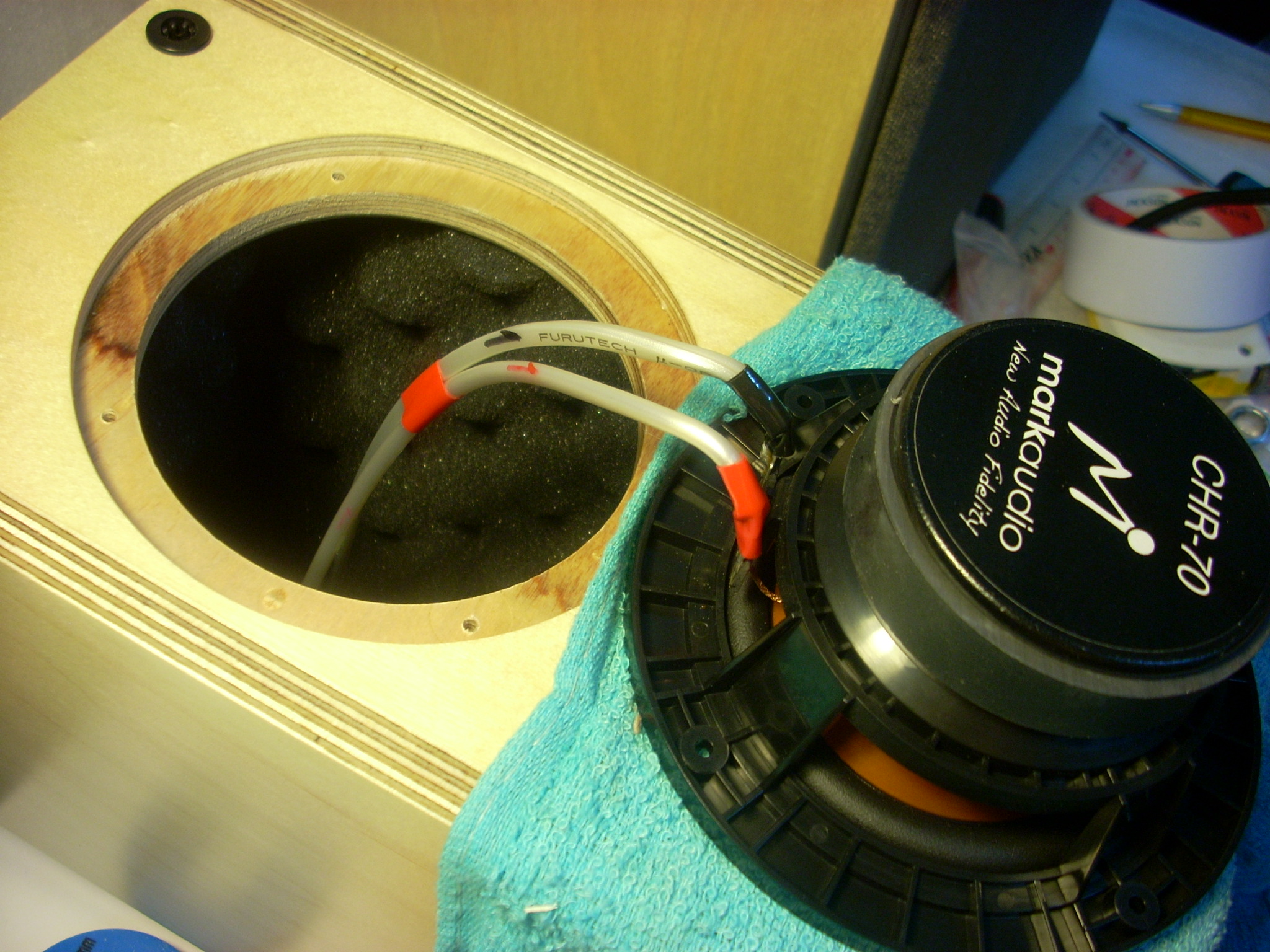

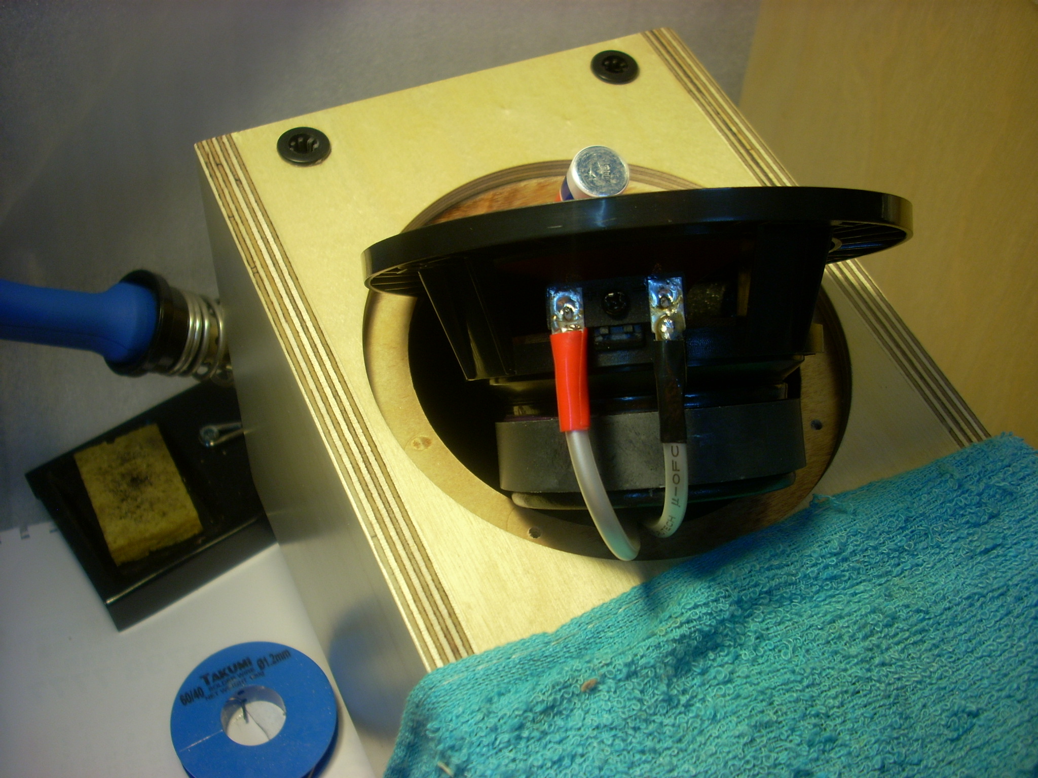

Fixed binding posts and wires (Furutech FS303 speaker cables) onto the cabinet.
