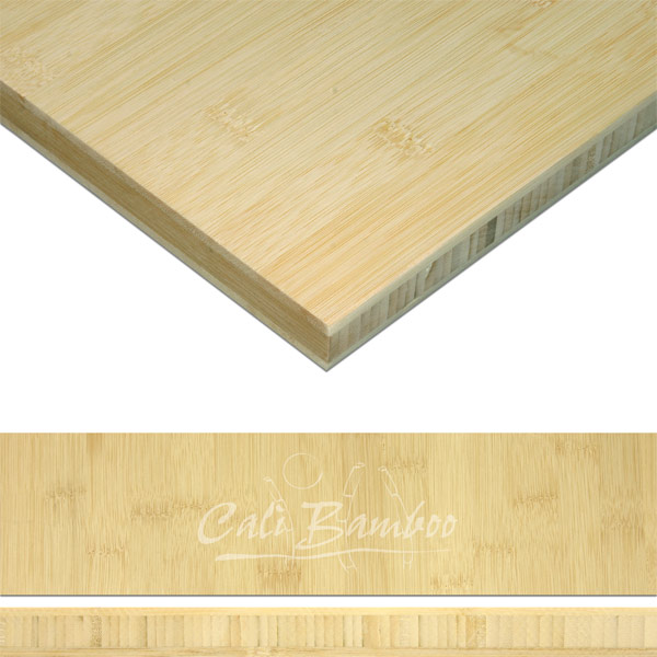

it seems the layers are very thick. 18mm with 3layers only?
how's the sound compared to good birch ply?
It is only 3 layers. The middle ply is bambbo blocks, the outer layers are strands of bamboo bonded together in a matrix. This makes it conceptually much like the aluminum skinned honeycomb used in airplanes and such.
It is stiffer, and sounds better than BB. It is also some 10x as expensive (ignoring that you have to pay for the veneer to cover the BB). To take max advantage it is more complex to cut and assemble. It is lovely with a clear coat.
Our earlier bamboo builds were with laminate outer plys (strips of bamcoo) and from early in its availability in north america (only 2 finishes), Even with lower stiffness ahead of BB.

Yes, there are many bamboo plywood suppliers in China.
These bamboo plywood in 3 layers shown should be what you said, dave.
That is the strip outer layer. If you can find stranded it is quite a bit stiffer.
The stuff you pictured is still good, but the surface is softer than the stranded and easier to dent. The one plus is that it is quite a bit lighter.

There are really different bamboo plywood.
This has stranded and should be right one for cabinet.

Yes, that's the right kind of stuff. A number of different external colour schemes. Available from a number of vendors here (ours weren't sourced from Cali (otherwise i would enter them in their monthly contest), but they were one of the most helpfull when it came to getting info. Plyboo should have it as well as they are who i actually got quantitive data from (we didn't get ours from them either).
