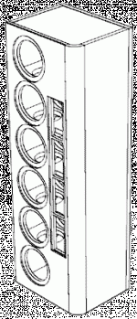

I will soon be building a pair of Line Array's that house 12 7"
Kevlar Mids and 12 Ribbons per cabinet. They will be sealed and
there will be a pair of stereo 12" sealed subs used with these.
The cabinets are made of 3/4" MDF 88" tall and braced with 3/4"
MDF every 12" The corners will be MDF Roundovers (2 or 3") on
all 4 corners.
I know the cabinet will be very strong. Do you think adding 30
ounce Carbon Fiber on all of the cabinet (except the baffel) would
add much more rigidity? I was thinking about doing the CF For
Asthetic reasons and finishing the baffel in WilsonArt Satin
Aluminum Metalaminate.

Brett D. said:John Janowitz had been playing around with some DiPole LA's
I've seen a smaller line array design from John... i've always been interetsed in how that 7" sounds -- i have a single pr of the ribbons. And i have to admit line arrays are intrguing.
That's a lot of holes. Are you going to get him to CNC the baffles at least?
dave
Dave,
The full size LA's will have a large roundover on every edge this
should certainly help with difraction issues. The small version

navin said:How thick is the aluminium? I have some 0.5mm stuff that is preanodised and coloured black.
That should be fine. The strength comes from the core.

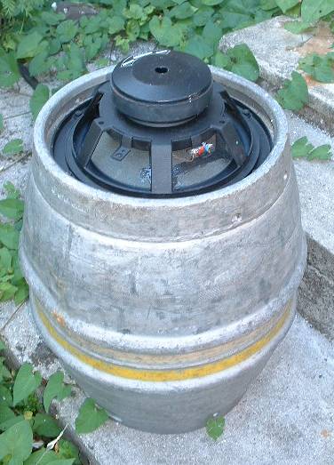

Surfboards, carbon fibre, now you're talking my language
I've been designing and building windsurfers since the mid eighties, and my preferred method now is a vaccuum bagged sandwich construction of carbon/1/4" core-cell/carbon over a polystyrene core.
If I could put this expertise to good use building speaker cabinets I'd be thrilled. Does anyone have any design suggestions? I was about to start researching LA's (I know virtually nothing about speaker design) because of these little 3" tang bands I've been fiddling with. They're so cheap, and even in bad boxes they sound pretty good.
Chris
Chris
Re: Surfboards, carbon fibre, now you're talking my language
Would that method of construction work for the shape in Post #35?
Christopher said:I've been designing and building windsurfers since the mid eighties, and my preferred method now is a vacuum bagged sandwich construction of carbon/1/4" core-cell/carbon over a polystyrene core.
To sell more speakers?Christopher said:I've also been toying with something like the B&W nautilus, but I have no idea what the theory behind the design is.
_____________________________
Christopher - your idea of a curved cabinet for Tangbands could be a real winner but there's no reason why it should be a 'bad box'. Stick around and with help from these guys you could come up with a great box.
And to get you kick started on the theory, four reasons why curved can be a good idea:
1. Cleans up diffraction problems
2. Reduces or eliminates internal standing waves
3. Reduces cabinet vibration by eliminating flat panels
4. Looks sexier

What about an aluminum soda can with some stuffing inside as it is perfect for a pressurized fluid?
What about some of the really heavy stainless or iron pots? Could you imagine a sub made from a huge garage sale cauldron?
Or a bathtub sub? Just add a baffle, stuffing, maybe some interior volume changes and voila...
ensen.
It got me thinking again...
