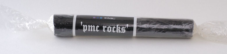

Da5id4Vz said:
WS Slater makes a very tasty sucrose composite. It likely doesn’t have any purpose related to speaker building, but they will extrude batches with customized lettering embedded in the core.
Not so. Here's an example. PMC is the Professional Monitor Company, they make some rather splendid loudspeakers, and when I bought a pair of MB1 for work I was worried that I might need to buy a pair for myself.

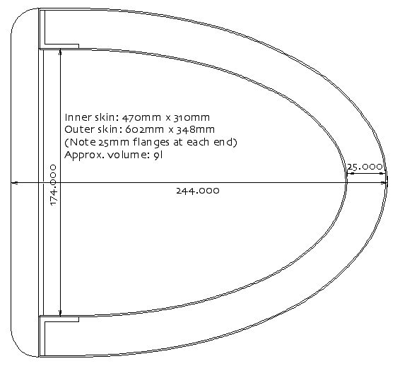

Here's the full griff...
Dave, many thanks.
OK. The top and bottom are each made of two sheets of 19mm MDF. One piece fits inside the smaller half-ellipse, the other inside the larger half ellipse. The angle aluminium and MDF make a frame (seen from the front) to which the aluminium can be folded round and secured. You now have a box, but the gap between the aluminium sheets is unfilled. The original design that 7N7 worked to was slightly different (read "not as good"), so I can't give filling details that are tried and tested, but I would be inclined to drill a hole in the MDF to squirt the foam in. The foam is that stuff people use for bodging houses.
The shape of the box is very rigid, and doesn't cause reflections (satisfying 7V's reservations). The traditional "knock" test sounded good. The front panel is boringly flat (makes it easier to mount the loudspeaker), but should have profiled edges to reduce diffraction.
For the mathematical whizzes amongst you. I did an Internet search to calculate the perimeter of an ellipse. There are approximations and an exact series that converges frighteningly slowly. In the end, I made a pair of aluminium templates, used them to mark out the MDF. Carefully cut the MDF and measured it with a steel tape measure. That's how impractical the formulae were! (Bear in mind that a 1mm error in 400mm was not acceptable.)
My CAD program reads out a 28,000 mm^2 interior cross-section area.
