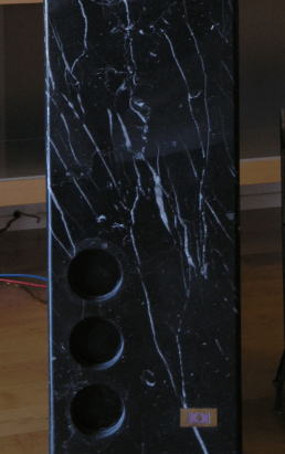

My marble nero marquinia love is beyma 15”
