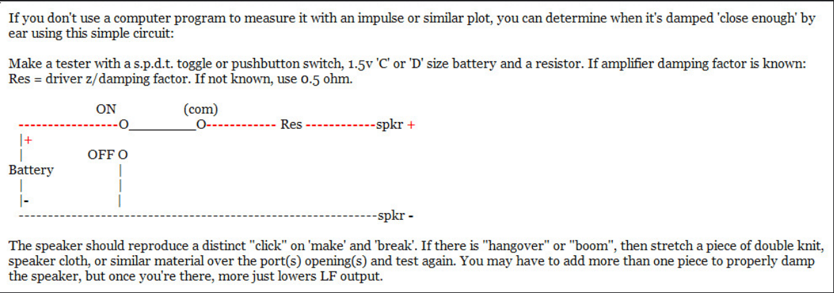

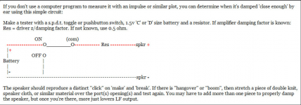

In any vented alignment, best to 'critically' damp it for best overall performance, something few do beyond using their ears to adjust damping/stuffing rather than using some form of impulse response test.

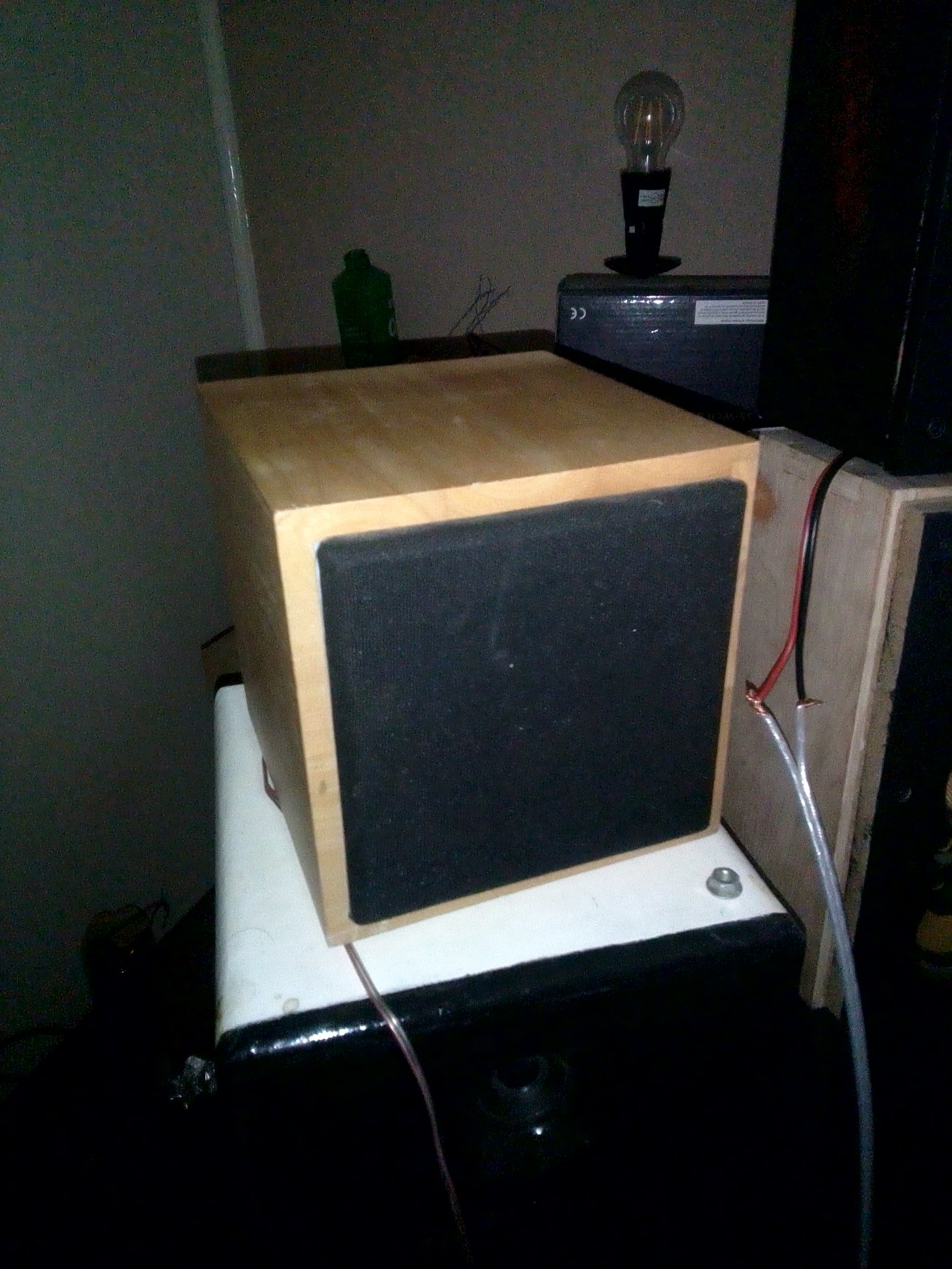

A few years ago, wooden boxes were the fashion in kitchens, so I got two biscuit boxes and put car full range drivers in them, the advantage of the biscuit boxes is that they have a plastic inner box (to make them more hygenic) so they have a double wall construction, helping to prevent the internal sound leaking out, if you were to 3D print speakers this would be easy to implement .The front baffles are held on by tension springs against a foam gasket, helping to damp them.
