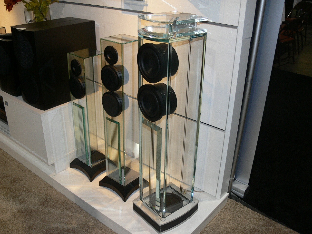

I've long thought that a speaker made from (clear) acrilic would look really cool, it would need a very neat crossover/cable layout though and an alternative to wadding to dampen internal sound reflections, I think those waterfall things had a slotted cup behind the drivers. Something like a small bookshelf.
Don't do that - you need damping material in the inside!
But you can use acryl with paint on the inside which also can give a cool/unusual look and you hide the inside mess.
Waterfall get around that one with their transparent glass cabinets by reverting to ye tried and trusted methods of the pioneers. Well, partly anyway. They stick a natty leather-covered cardboard / similar tube around the back of the driver with a sufficient amount of damping material in it & a bit of grill cloth at the end for aesthetics. Their 'Acoustic Damping Tube Technology' [no less]. 😉 Just a visually more attractive version of the old approach of stapling layers of grill cloth or fibreglass over the back of the driver until the old click test indicated no audible ringing. Notwithstanding some [extreme] care over wire-dressing & crossover appearance where appropriate -job-jobbed.
Granted -given the dimensions of the Waterfall boxes vis-a-vis those back in the day, when this was more or less standard practice, I suspect the new speakers are somewhat less suited to damping this way than their ancestors as it'll do the square root of zero for suppressing the longitudinal. But that's progress for you. :rofl: Presumably the PBR loading helps sort that to the point it's not an issue.
